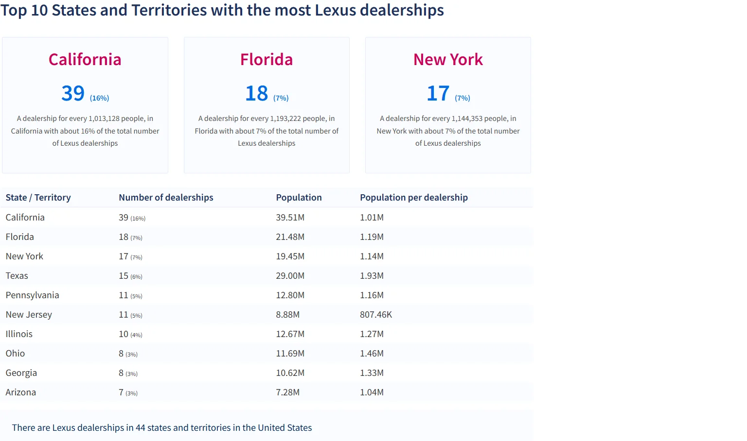

Lexus doesn't report sales of vehicle models by State. But they do have number of dealers per State and it is based on population.
Florida and Texas together don't equal the number of dealers in Ca. And then there are all the other States.

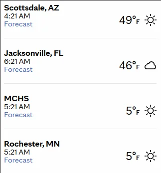

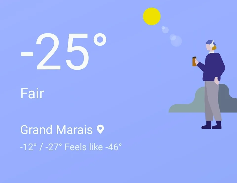

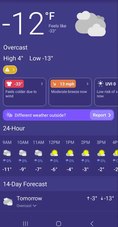

20 years as a propulsion engineer in the Navy doing Engineering Casualty Control. Last 28 years Level 3 Technical Support for Computer Systems, I'm the guy that they keep in the basement and call when no one else can figure out what the problem is. So can't help myself, the heat issue and geo location jumps out at me and smacks me LOL.
Between the Deep South and here the temperature difference is more extreme than I think most people realize. This morning temps
But an hour South of the cabin I stay at during the month of October right now it is
Quite a difference compared to Fl. and Tx. right now although they are colder than normal. During the summer it is the same. In the 70's I took a Greyhound from San Diego to Upstate NY when I was being transferred and at the bus station in Texas the TV said more than 100 people had died from the heat wave. Shocked me at the time. Of course AC wasn't that common back then but people weren't dying of heat up North.
The temperature difference is large enough that the trannies in the South struggle. Of course they can in the North as well if you tow or carry enough weight. Couple of months ago ran across a post on the Tundra forums titled A760F issues, perfect example of heat killing the tranny. In the South. Guy is from WV but was in Texas when the heat destroyed his
