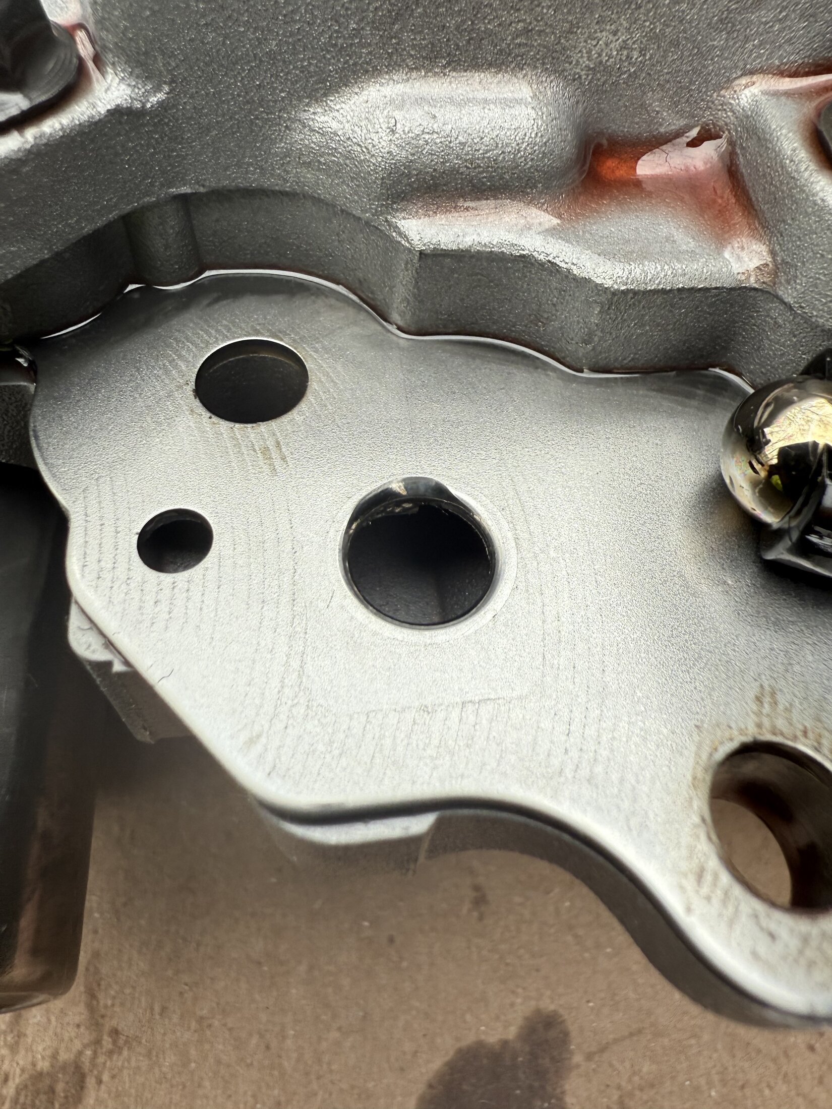

I pulled the valve body to start installing the Sonnax zip kit and saw this worn check valve seat:

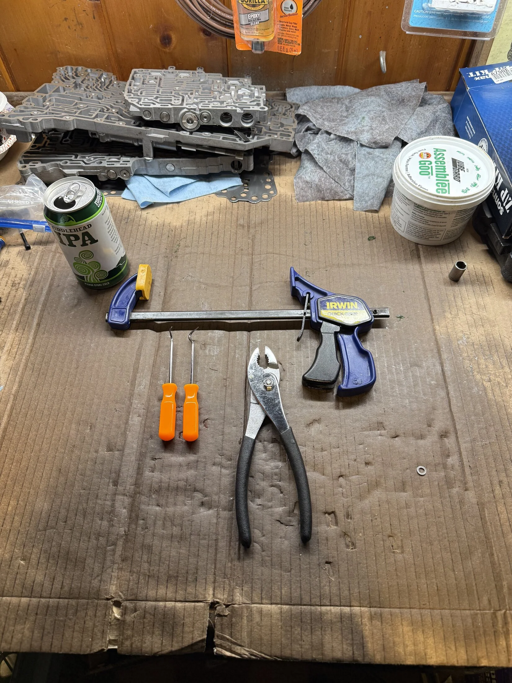

I spent a couple of hours yesterday disassembling the valve body and taking pictures, and another 2-3 hours today slowly swapping the parts from the Sonnax Zip Kit. The job isn’t too bad provided you take your time, follow the instructions, and keep everything clean and lubricated.
I did have a hard time installing the o-ringed end plugs. The bores are tapered at the end, but have a rough finish making it very difficult to push the o-rings by no matter how well lubed.
I ended up using a small pistol grip clamp to push them in which did shave a small amount of material from some of the o-rings.

As for the worn check valve seat in the spacer plate - I haven’t been able to find a replacement online , but will give the dealer a call tomorrow. In the meantime, I found replacement drop in valve seats designed for GM transmissions. You simply drill the hole out, drop the new seat in, and secure with a c-clip. It may be necessary to drill a relief into the valve body. This kit is made by Fitzall and is $16 on Amazon.

Besides sockets, the only tools needed so far are: Harbor Freight picks, clamp, pliers, and paper towels.

FYI, the Fitzall replacement valve seats arrived but are too small. I also called Lexus to find a replacement spacer plate, but they don’t sell them - they will only sell a complete valve body or the external parts (solenoids, etc. ).
I’m weighing my options, here. Do I reassemble knowing there is one problem spot, or try to get creative and tig weld some material back on and lap the seat?

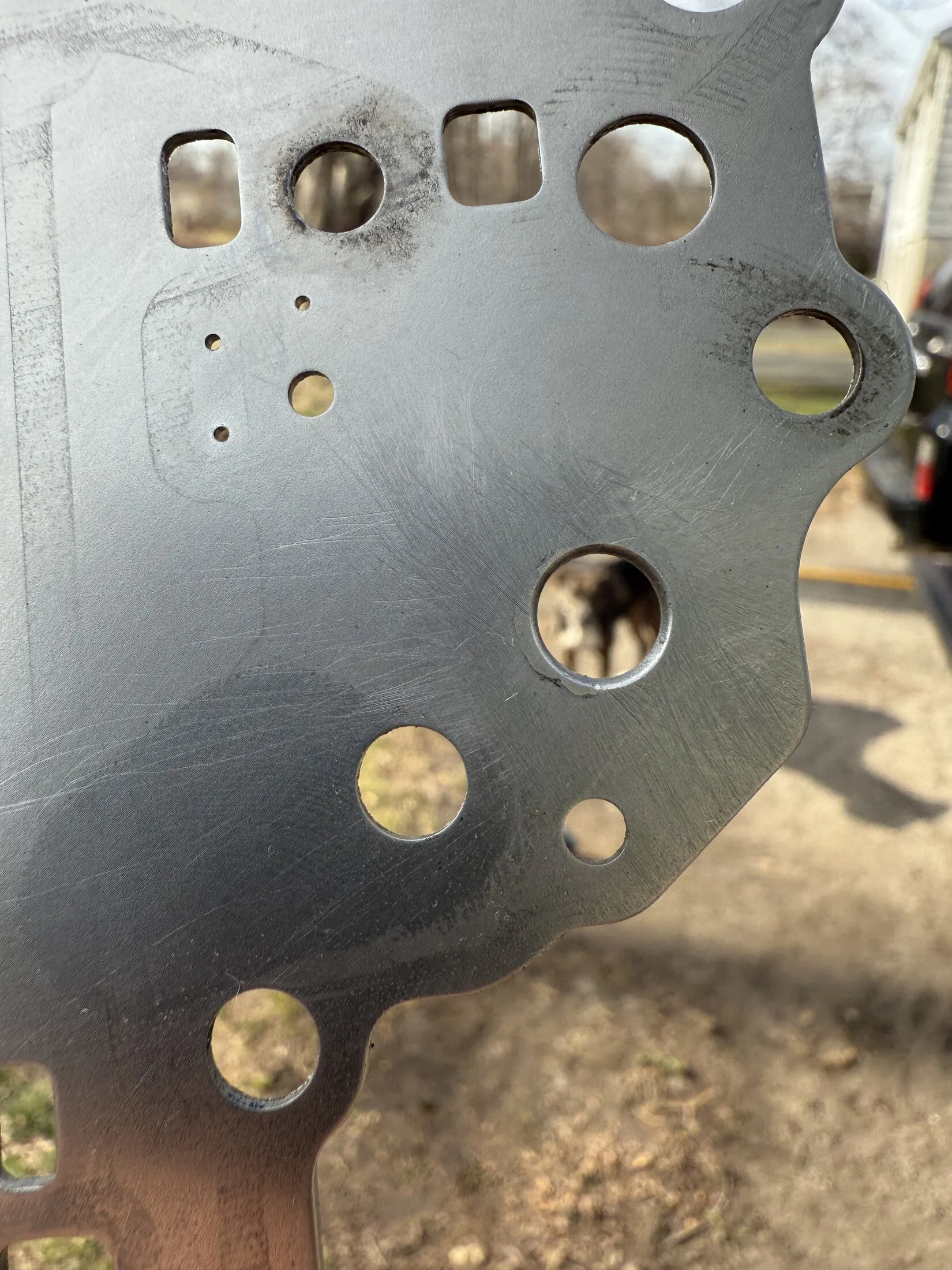

I ended up tig welding the edge of the hole and having it machined back to round. Total cost $0, but would have probably been about $200 if I had been charged for the work.
After the hole was machined, I took some lapping compound and a ball bearing to get the seat just right.

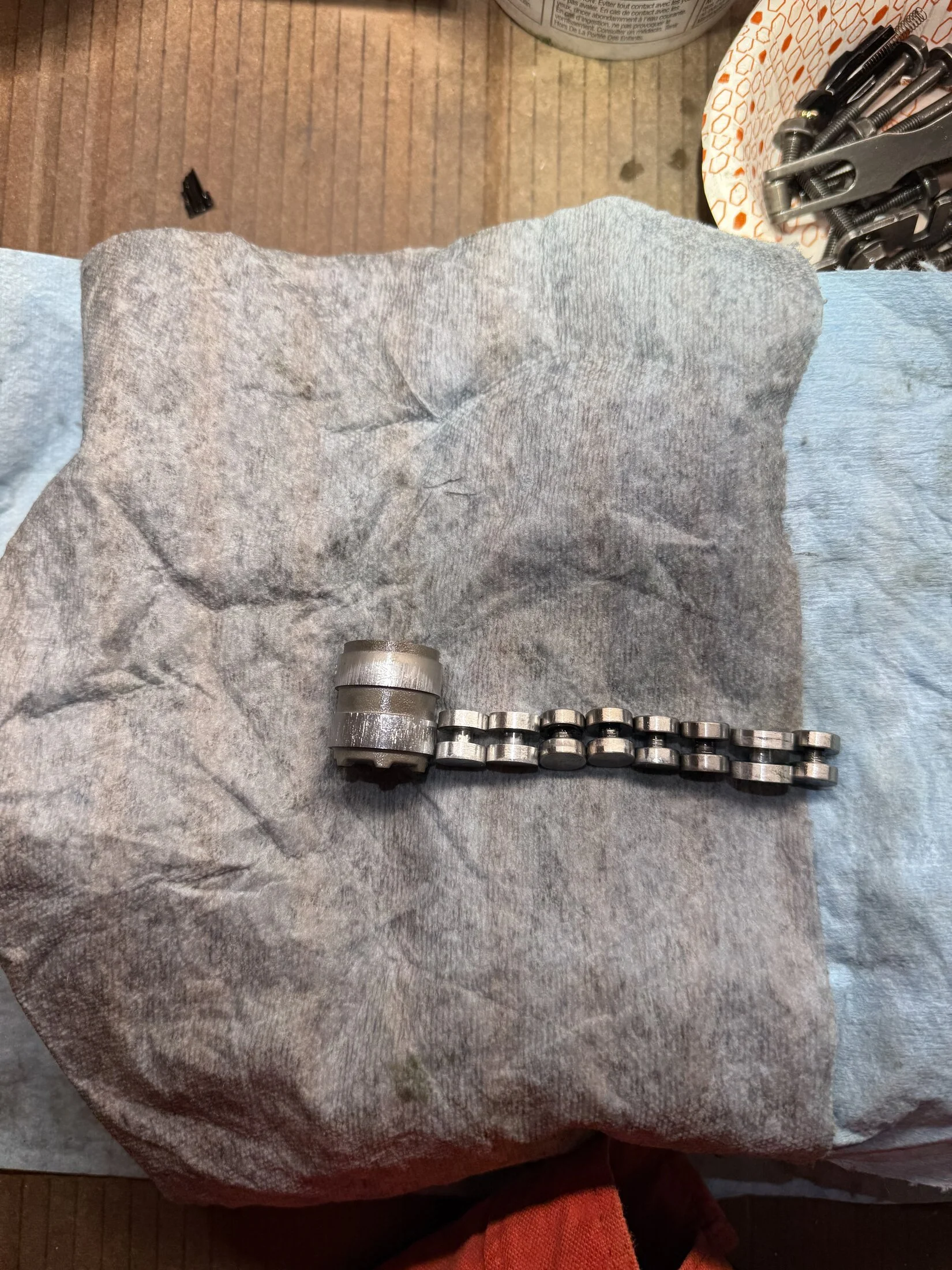

Below are some of the worn components swapped with the Sonnax kit:
When I was about to install the valve body, I found a part in the housing almost identical to the large part pictured above with the same wear. I didn’t have that part on hand so I just rotated it 90 degrees and stuck it back in.
