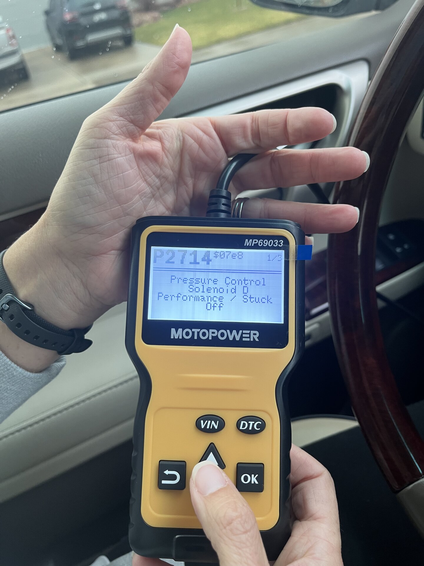

ISSUES
-First/Cold starts car will not shift from 3-4, throws codes P2714 and P0761 - Stuck Solenoids, check engine, VSC and 4LO come on. Happens in the first 5-15 minutes. Must pull over and erase codes.

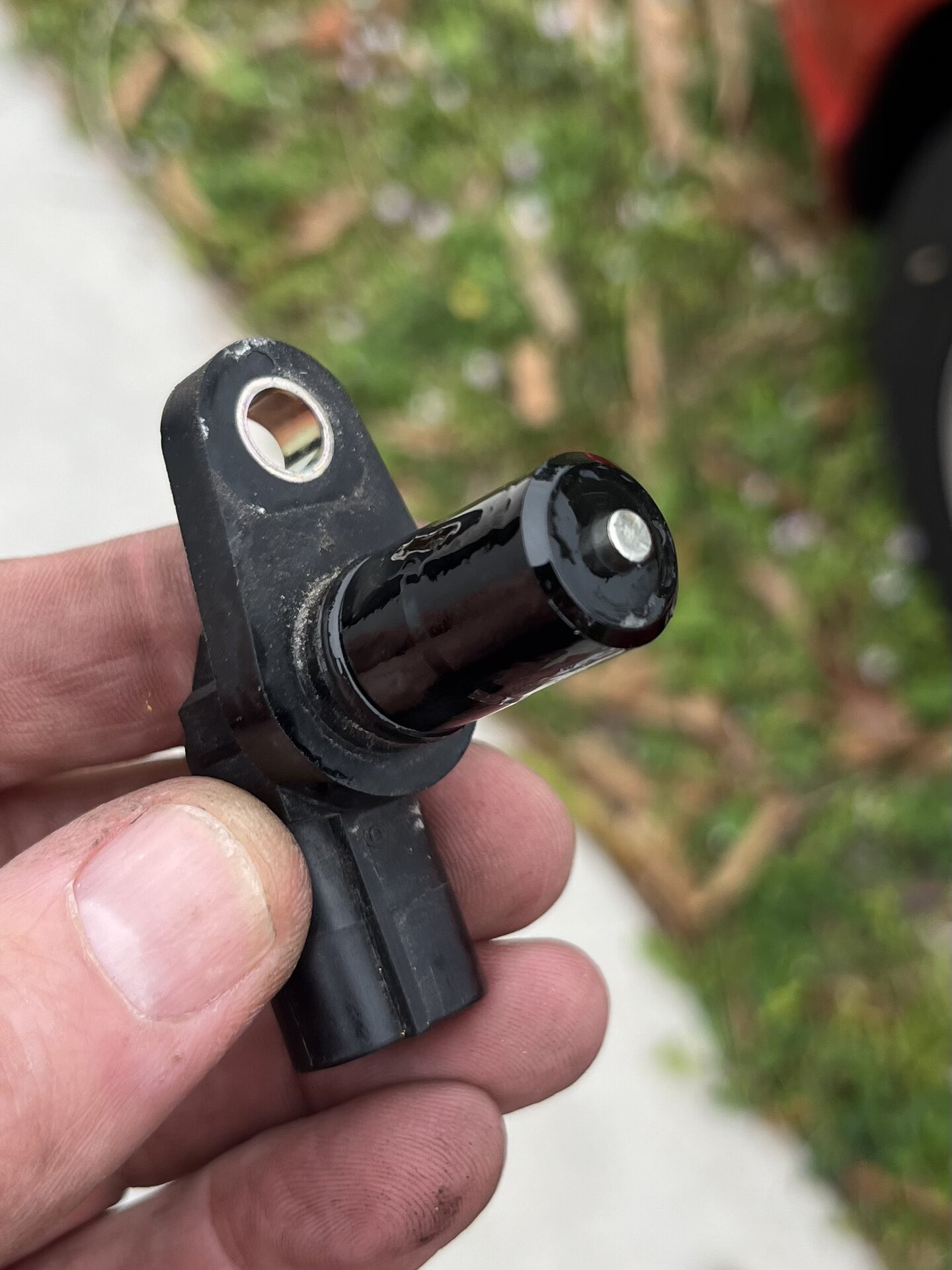

-Replaced both speed sensors on the transmission part 894130C011

I saw the sensor transmission output sensor replacement fixed the issue in the tundras. I replaced both input and output sensors on mine a week ago and the codes came back in 5 days. The sensors that came out looked like new and had zero metal particles attached to the magnets. The fluid is not red and has clutch particles in it but certainly not anything that would clog the solenoids in my opinion.

The speed sensor was one another user did with solenoids and cleaning the throttle bottle. It worked for him but others do one or the other or both and nada. 🤷
