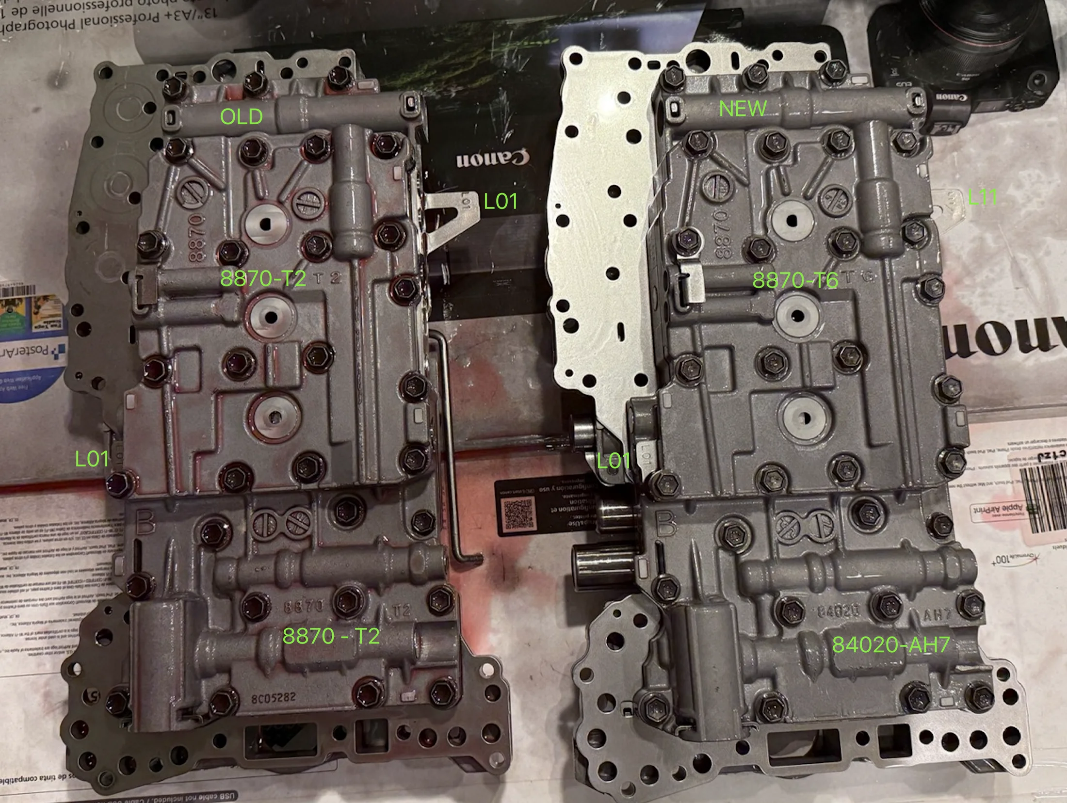

The P2714 showed up again. I think it's time to change the valve body.

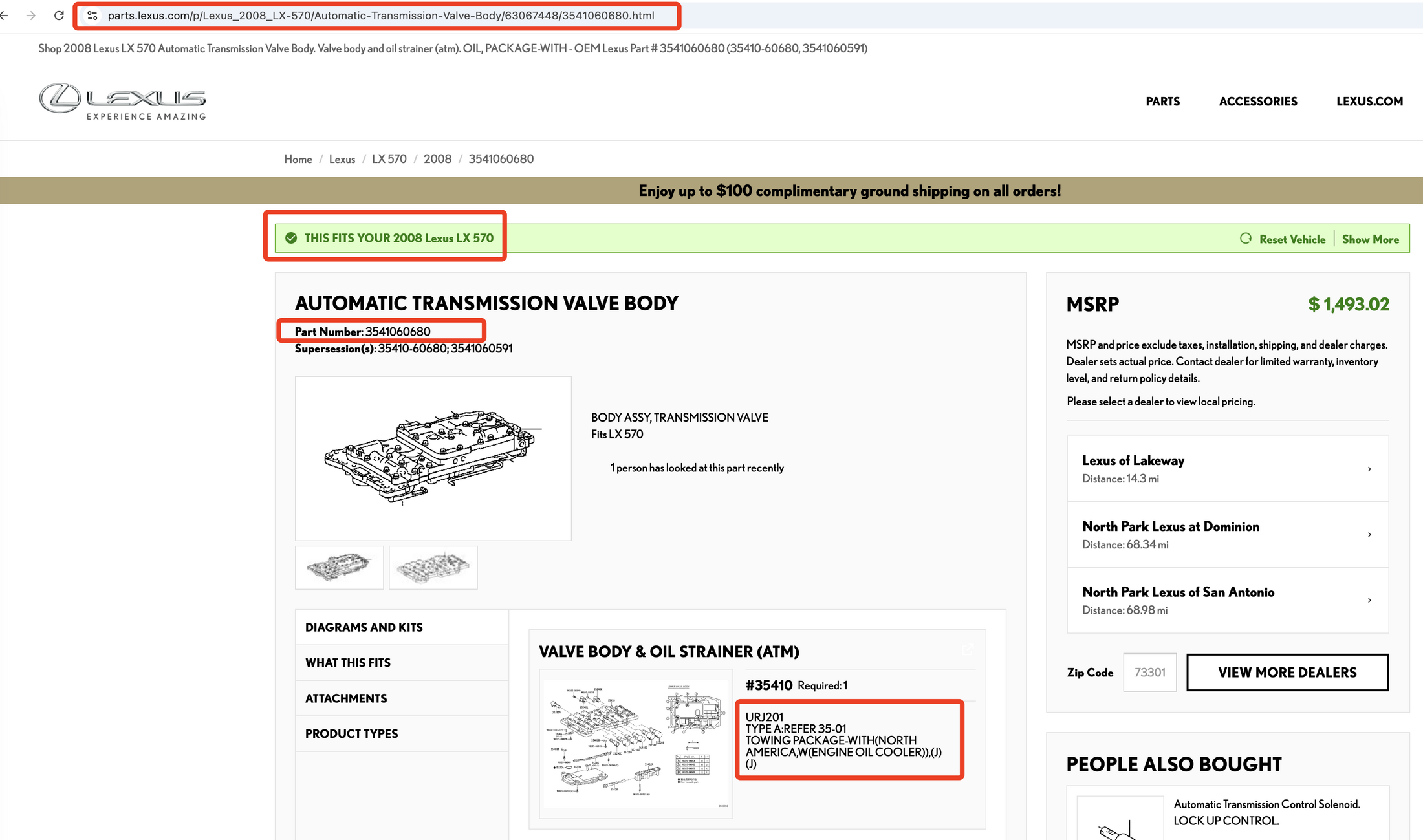

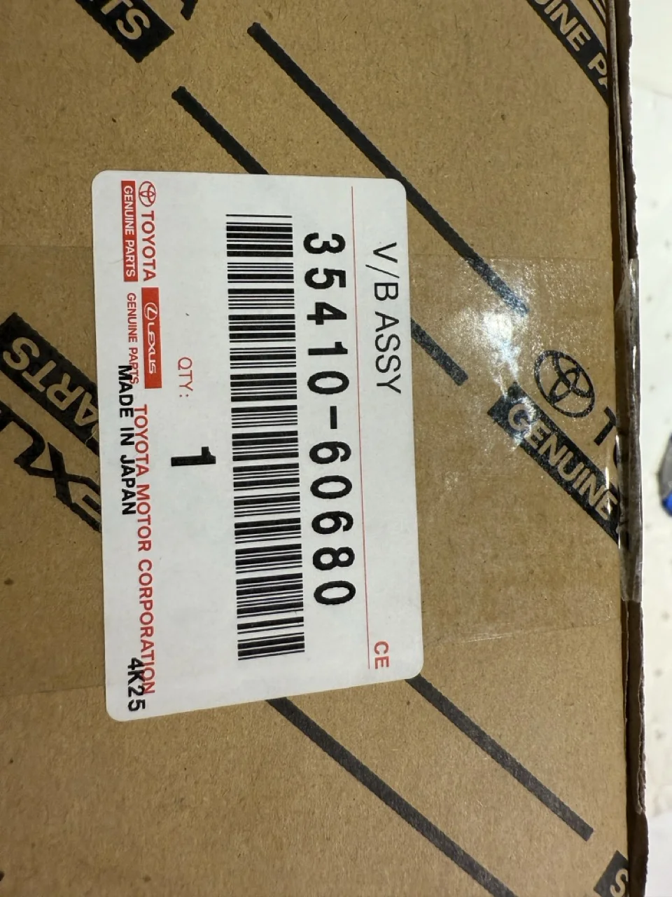

Valve body parts number: 35410-60680
Lexus part link: 2008 Lexus LX 570 Automatic Transmission Valve Body. OIL, PACKAGE-WITH, COOLER - 3541060680 - Genuine Lexus Part - https://parts.lexus.com/p/Lexus_2008_LX-570/Automatic-Transmission-Valve-Body/63067448/3541060680.html

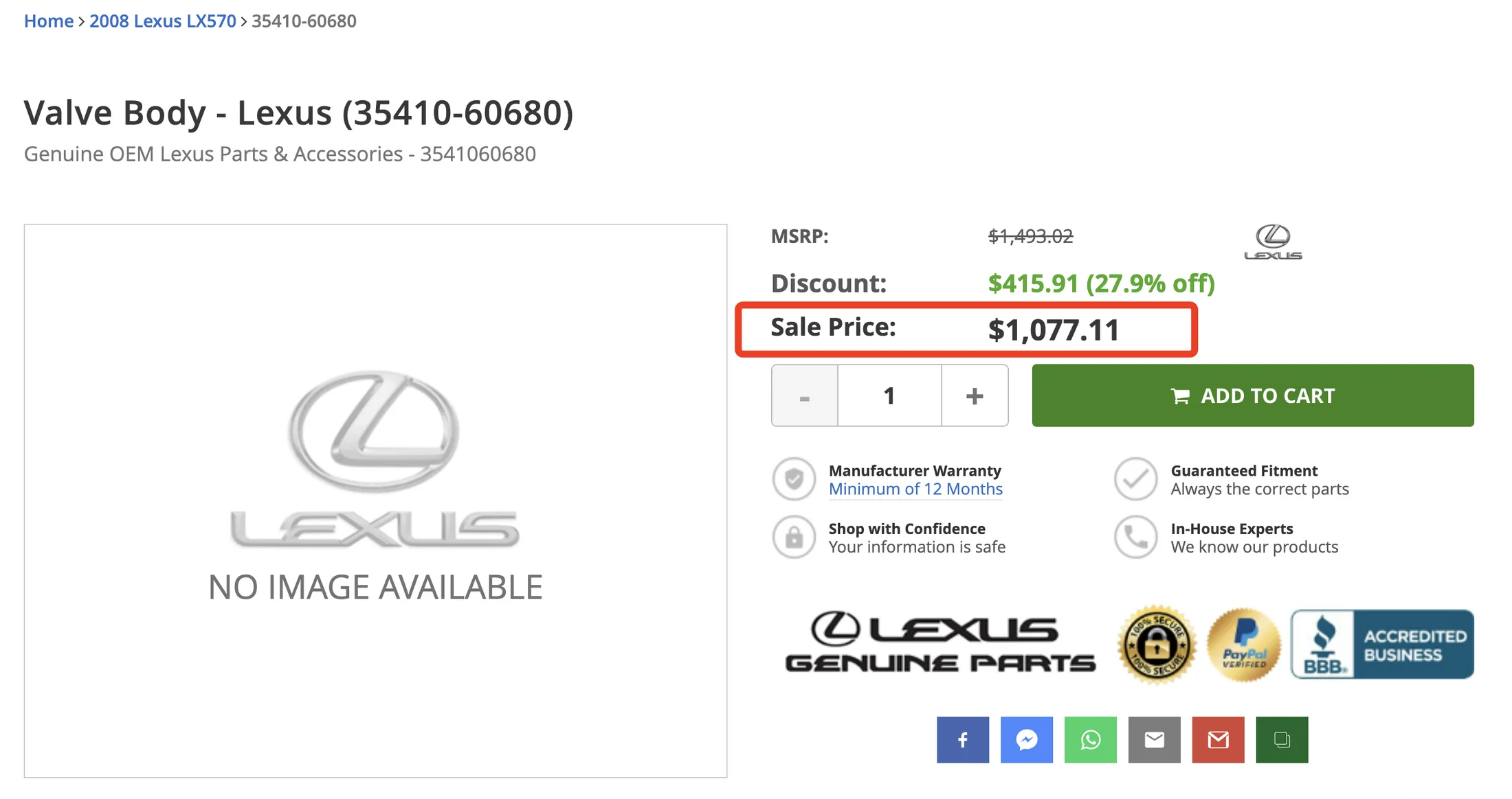

I got it from MyLParts, pretty good discount, 10% more discount with code CL5 . https://www.mylparts.com/

Strongly recommend MyLParts, 35410-60680, 28%off, with code CL5, another 5~10% off.
New valve body has about 400 miles on it, everything works fine, shifts buttery smooth. Continue observing.
Don't forget to use brake cleaner to clean all solenoids when put them on new valve body.
