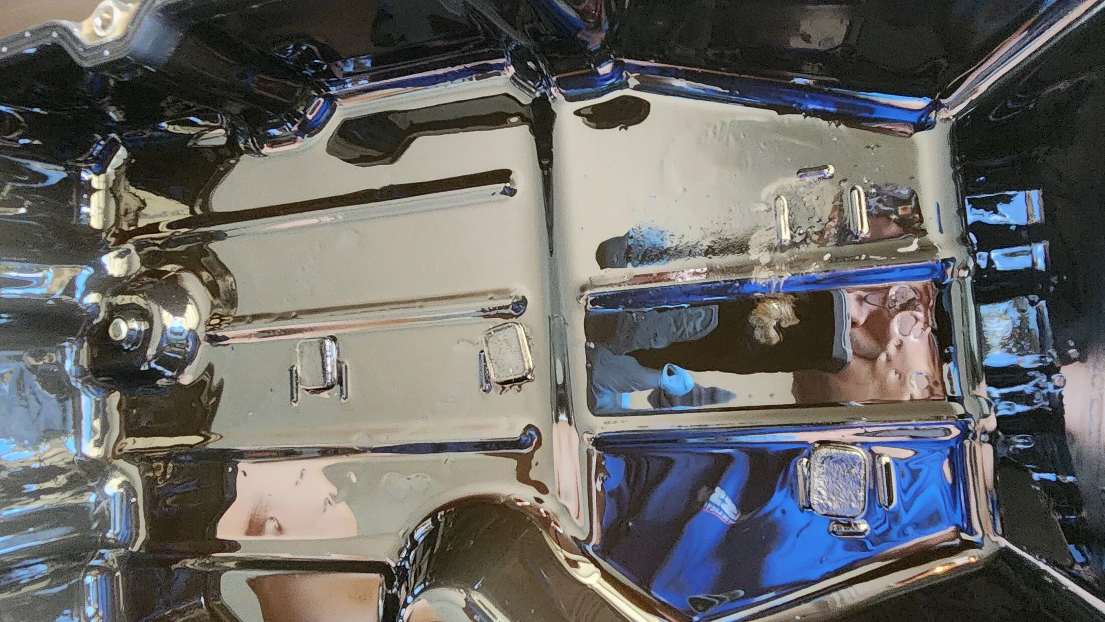

I started to notice softer delayed shifts at 180k and had dealer replace the fluid at 190k, but shifting still felt the same. Then around at 215k I started popping codes after experiencing no shifting from 2-3, flareups, no-shift from 3-4. Best solution I came up with was maybe weird fluid dynamics and cold running caused this issue. Remote start and let the truck warmed up and it would shift fine without codes. Every once in a while the truck would not reverse or there's a delay for it to engage.
I dropped the pan after breaking two bolts. Replaced s3, and s4 solenoids on a whim although solenoids tested fine. Replaced filter and cut open the original with no signs of excessive wear. Topped off fluid and it was code free and shifting great for another 10k miles and codes popped up pointing more towards worn valve body bores allowing fluid leakage and pressure drop.
I talked to TransGo since they've been great to me in the past with my Nissans and said the shift kit and other things will prolong the transmission life and should resolve my issues. I'm ordering it and will install and report back once I get some downtime from work to tackle it. I'm hoping to get another 100k+ with the valve body rebuild before I do a full teardown.

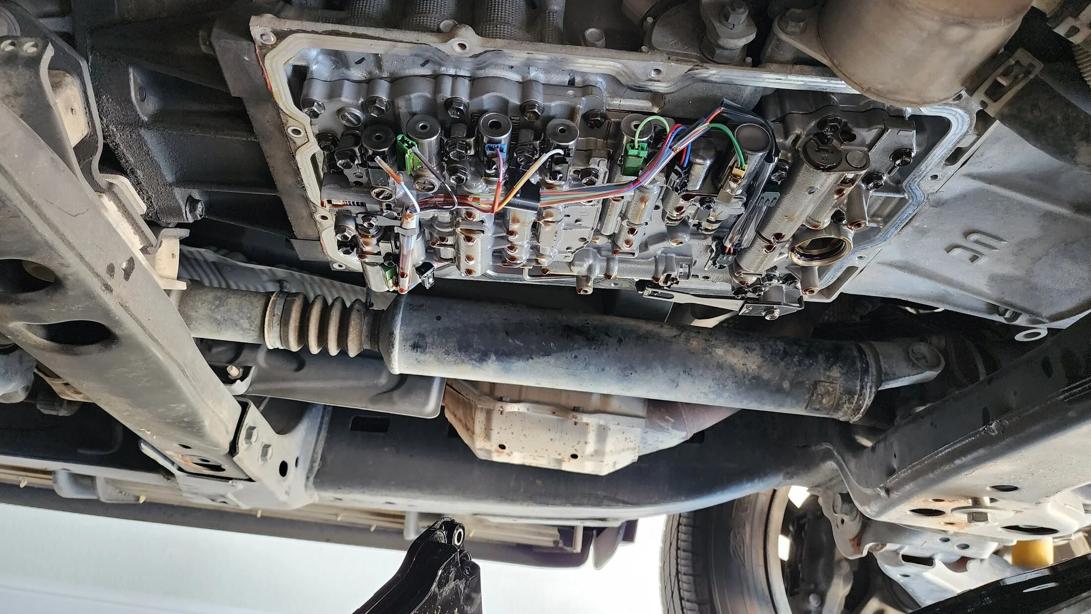

2011 gx460 130k ish miles. Won't shift between 3rd and 4th sometimes. Worse when cold. Sport mode does not really help. Did alot of valve body work. Used the transgo boost valve kit. Used the sonax end plug kit with o rings and also boosted the pressure with one of the adjustable valves on the side of the valve body. Replaced the s3, s4, tcc and Sr selonoid. Nothing has helped. Also replaced the torque converter. Ordering a new valve body and going to see how she does.
Seems to me there is a loss in pressure somewhere or there is a sticking solenoid. New valve body should fix. Will update when I replace and test. Plus I will have the old valve body still so I may beable to send it out to be tested and see where she fails and what fails.

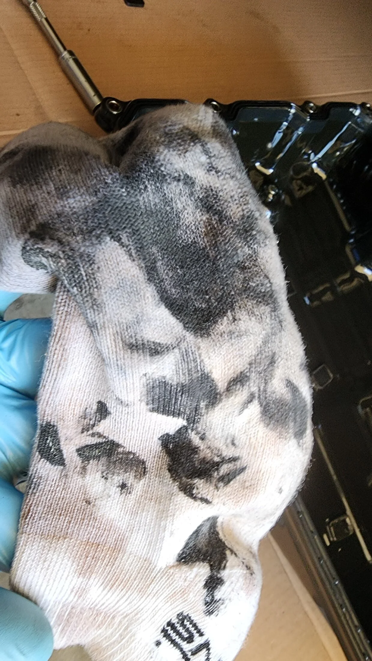

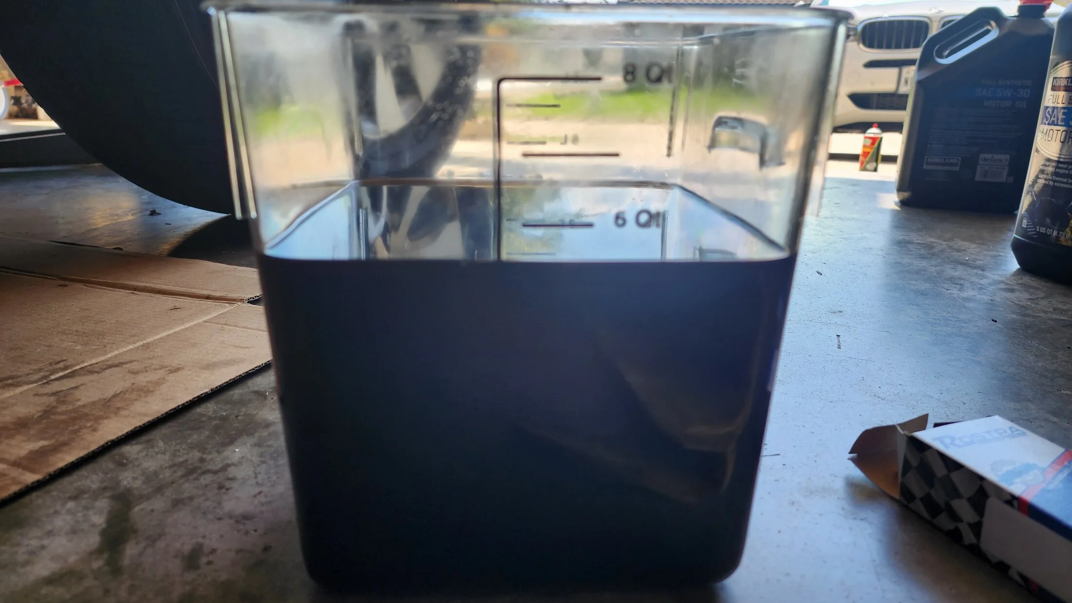

Also, to add to post. I did not notice metal shavings in pan or extremely dirty fluid. When I first did a drain and fill the fluid that came out still had good lubrication properties (put the fluid in my fingers and rubbed them together) and was not burnt.

I'm guessing there's something going on with the 3-4 shift valve or the c3 clutch apply relay valve. The s3 solenoid controls the shift from 3-4 which inactivated c3 clutch. Perhaps fluid leakage past the valves somewhere. When you do pull the valvebody off for new, I'd inspect the valves and their bores plus installed o rings. The o rings could be slightly damaged from install to cause some leakage. Making a wild guess here. Valves shouldn't have noticeable lateral play. Look for nicks and wear marks in the bores.

I am thinking the same as you along the lines of the 3-4 shift valve/piston is binding up somehow. The bores are aluminum and the pistons are steel, no bueno. I changed out the s3 selonoid and nothing changed. I will keep posting my progress here.
