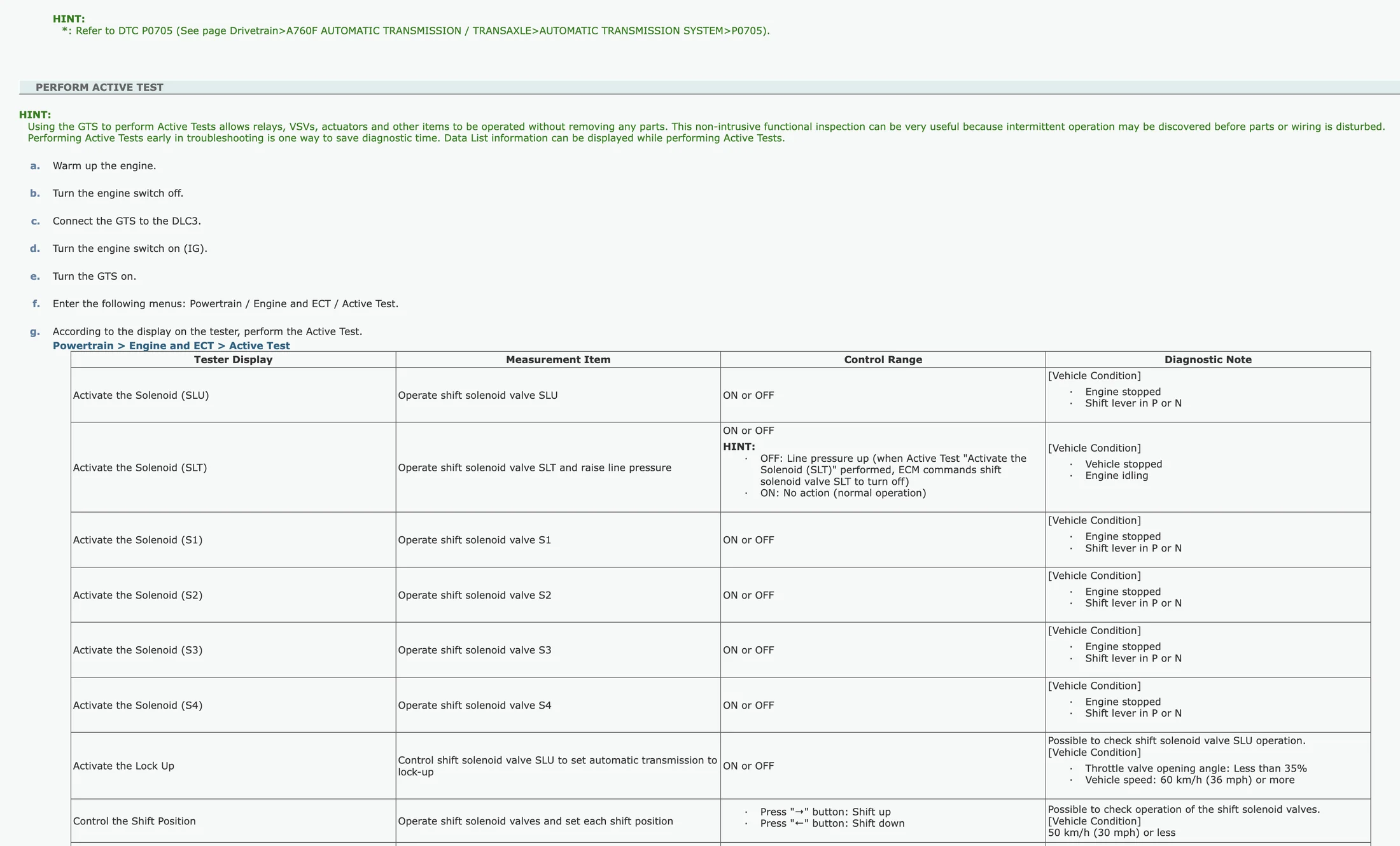

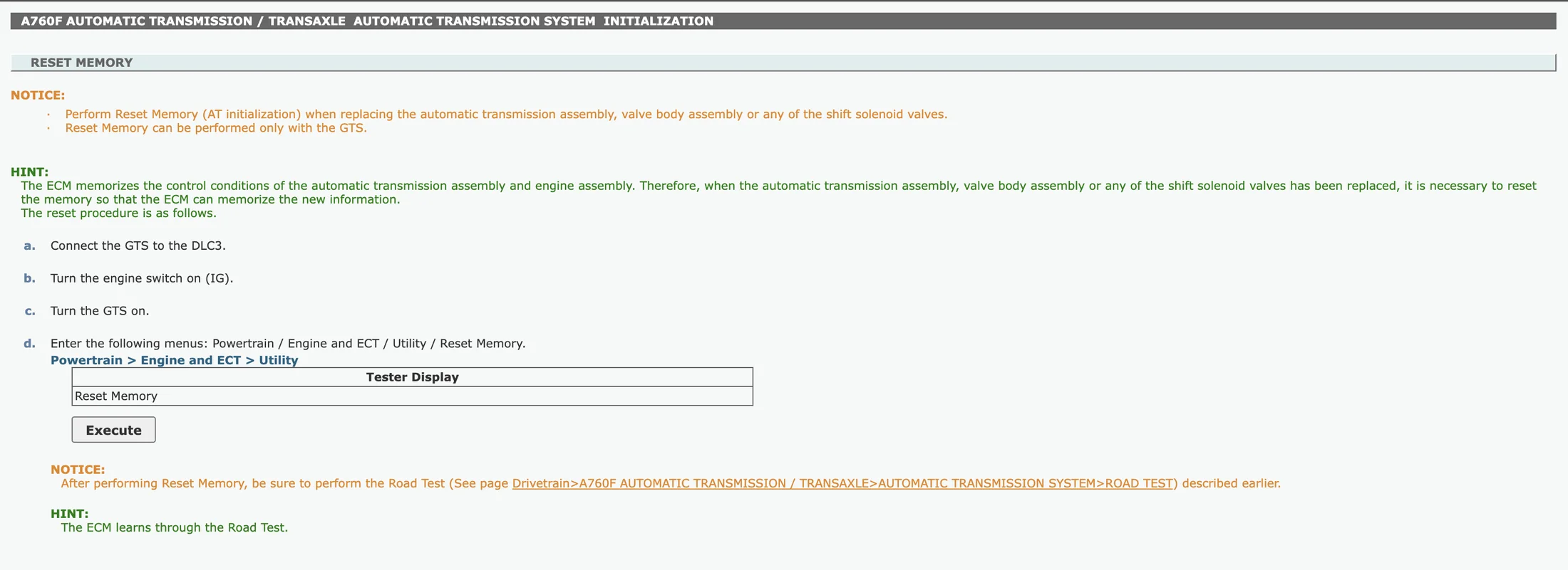

Did you reinitialize your transmission after all the work? Just curious
I tried to reset it through techstream when I replaced the parts in the valve body but the software said it wasn't available to be reset on this model. Has anyone else with techstream been able to do a reset?
A 10-minute battery disconnect should do the same thing. I've also reset the TCM for my A750F using VF Tuner.
