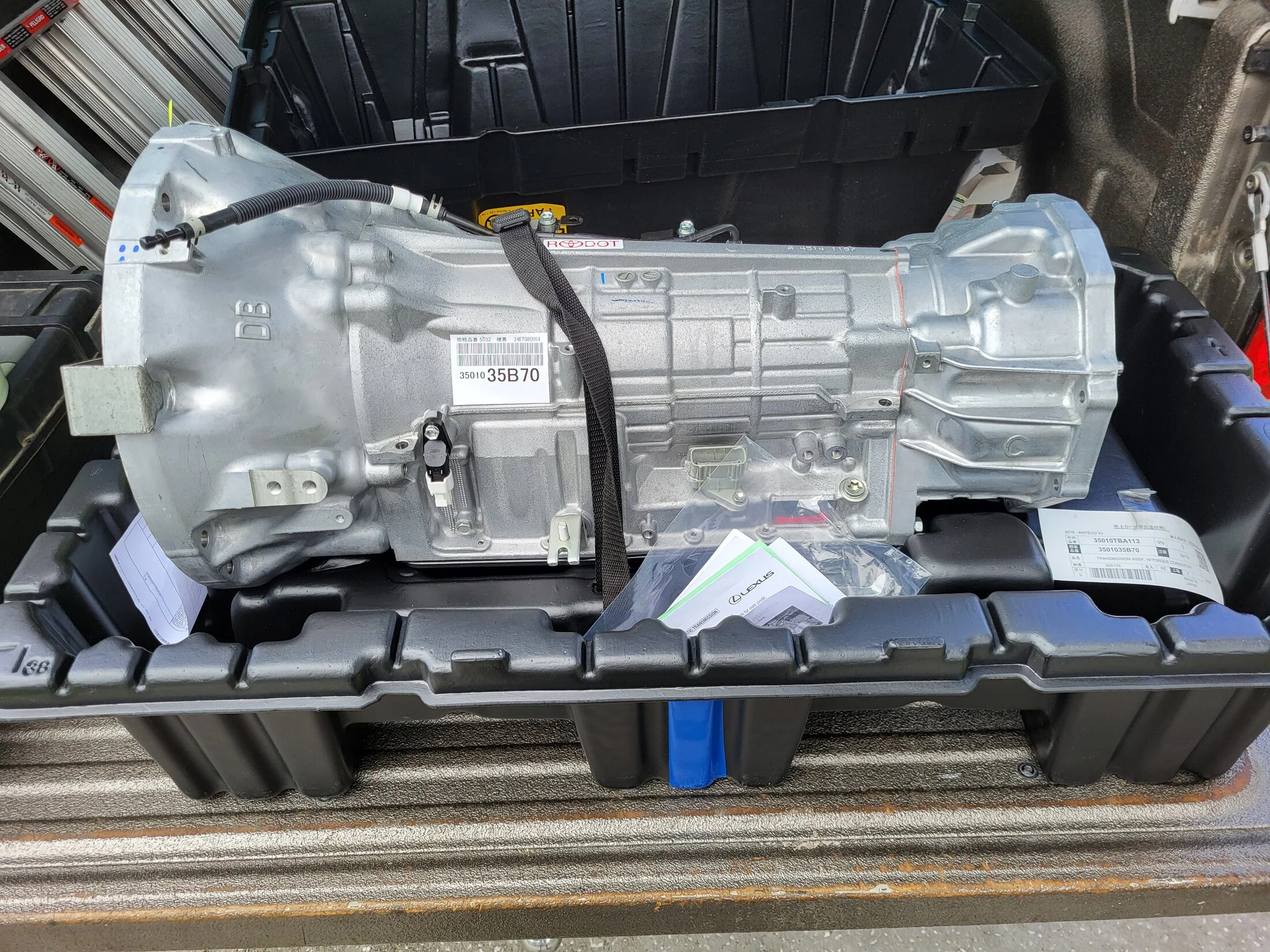

I got the transmission from lexus. It was 2900 plus 270 something for tax and 1k for core.
I am going to install it myself. I may have time to tear it down depending on time and then return it. When lexus gets these back as cores they rebuild them and replace everything on the inside with new parts and sell as reman so i may beable to return in pieces. Going to ask.

Dropped mine off yesterday to get a full transmission replacement. Lexus has reman's in stock with a 1 year warranty. Reverse was starting to go out so it was time. $5100 total, which I am OK with since I've heard about some closer to $8K.
Got her in today. Can't take it appart per return instructions. But we got to figure out how to get this data they have. This form has alot of info and I am sure they are finding out a common problem and are fixing it with these remains.
