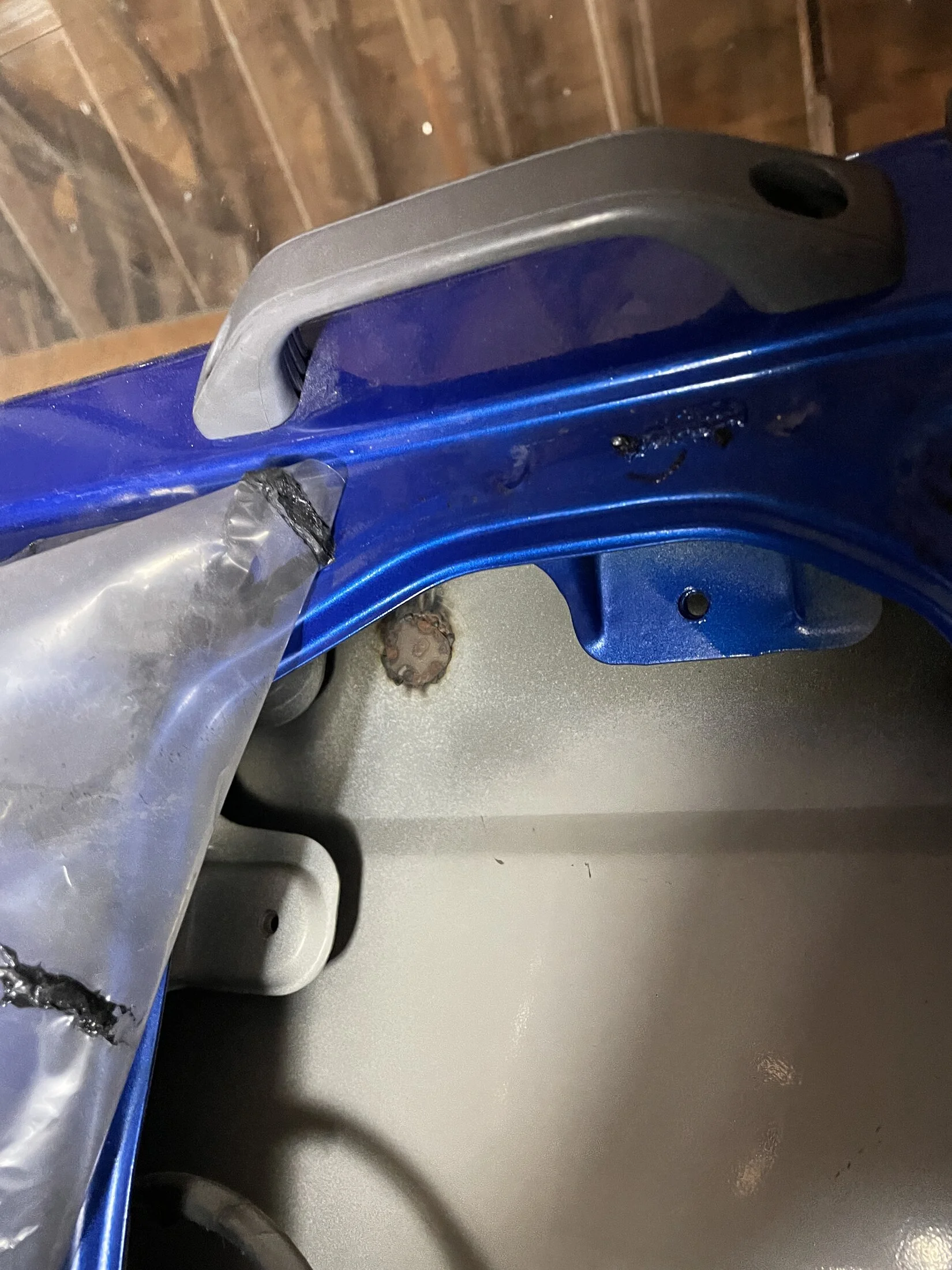

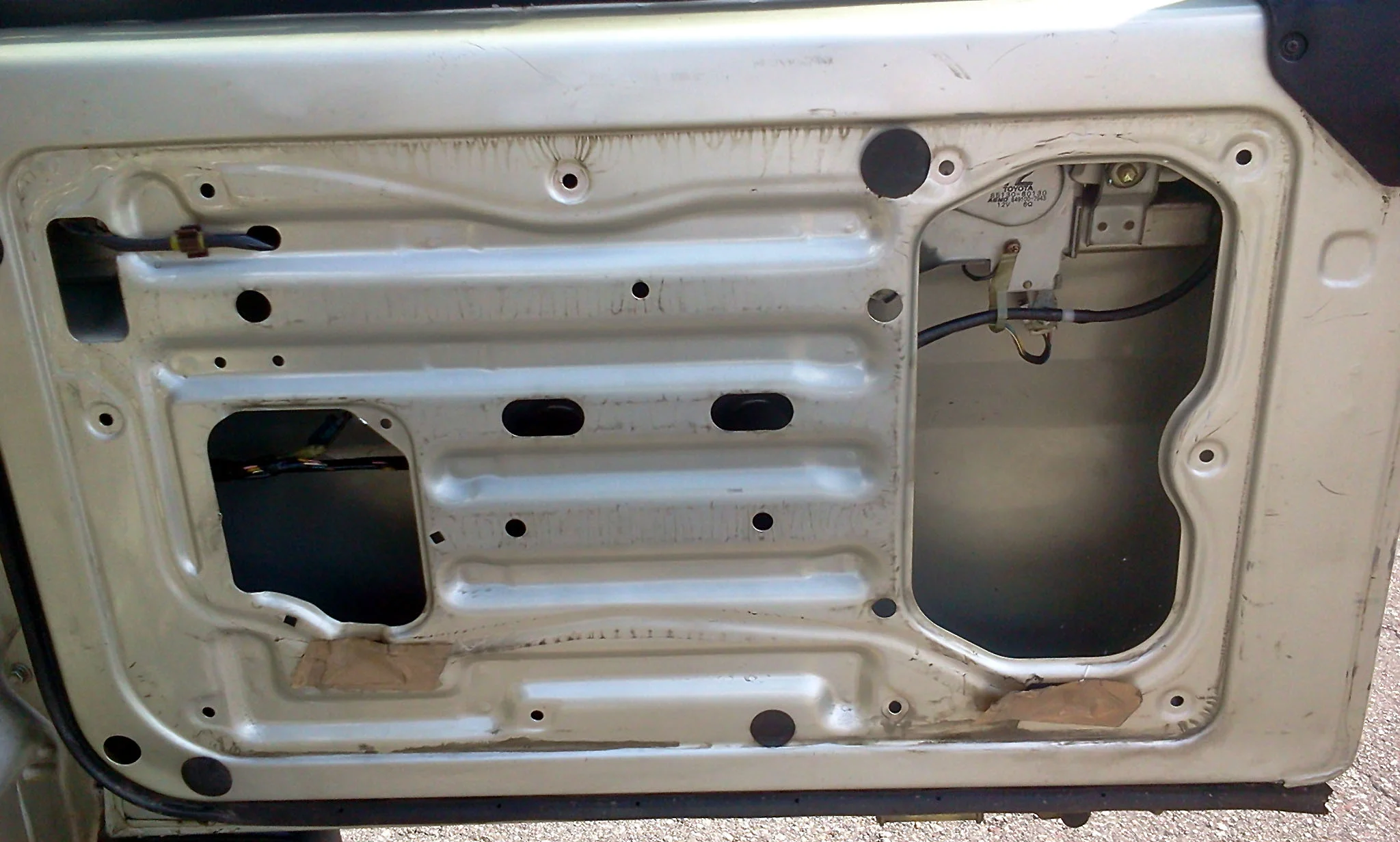

The right door looks like it’s reinforced for a spare tire mount. There are two vertical brackets inside. How do I tell for sure?
Hi
Thre are two variants of spare tire mounts to the door: For the wheel being mounted outside or inside.
The outside variant has holes in the door skin, that allow bolts to go into the enforcement inside the door to mount the carrier bracket.
The inside variant has two nutserts in the door frame, between window and doorcard.
Not sure, but this variant may only exist with the removable doortops.
Remove the door cards and look at the reinforcement. With wheel carrier, the reinforcement is a 3D bracket between the outside door structure (holding the skin) and the inside door structure (where doorcard is attached). I have the variant for the wheel mounted inside. The reinforcement roughly has the shape of a truncated pyramid, located in the cavity between the inside and outside door structure. Sorry, I don't have pictures.
Whatever your structure looks like: In order to distribute forces, it has to connect the inside and outside door structure.
Cheers Ralf
Hi
Cheers Ralf

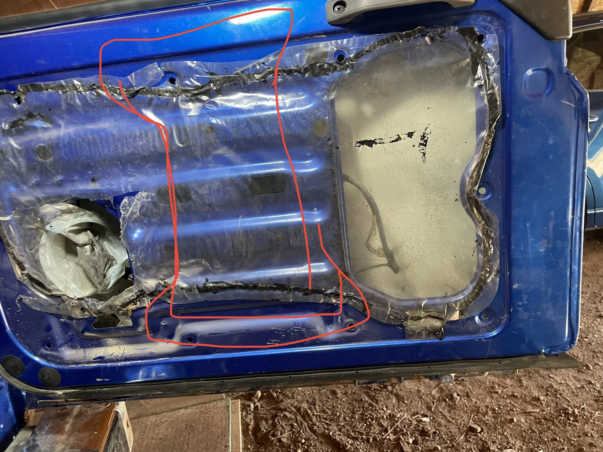

Thanks Ralf (@Felde)

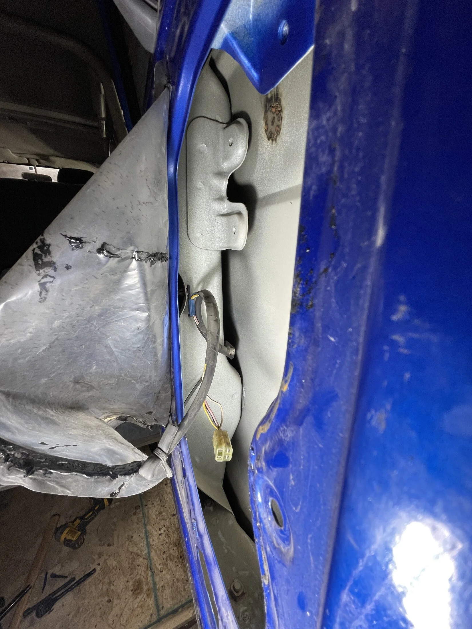

I took a better photo of the structure inside, from the latch side.
It looks pretty beefy. The round rusty area looks like a plus was welded in, just above and to the right of the tab with a thread on it. Is there a bump stop or something that might go there? It’s about 30cm inboard of the latch, almost right behind the inside handles screw. I’ll troll through the forum to see if I can find a good picture of the door from the outside, but with the spare tire removed as the parts diagrams don’t show much.
Maybe a wiper or spray nozzle?
Hi
No idea what that rusty / welded spot other thread might be. That looks way different than my door. But mine has detachable doortop and is for inside wheel mount.
The spare wheel bracket needs to bold straight through the door skin into the reinforcement. The door skin is way to flimsy too give any support. For that, the reinforcement needs to tough the door skin; else, it would produce a dent.
The only point in your pic, where that is given, is the spot between the black cable and the connector
Those other brackets to me do not look sturdy enough to carry the weight of a heavy tire + the dynamic forces.
To me, this door doesn't look like it's reinforced for a spare wheel carrier, but I actually can't tell.
Good Luck Ralf
The tabs with the thread holes does not touch the door skin. The support inside the door is flush up against the door skin at the top and bottom and is slightly X shaped. It is almost as wide as the interior panel between the speaker hole and the access panel.
I’m thinking I’m good to go, but am hoping I can get some validation by someone with the OEM carrier.

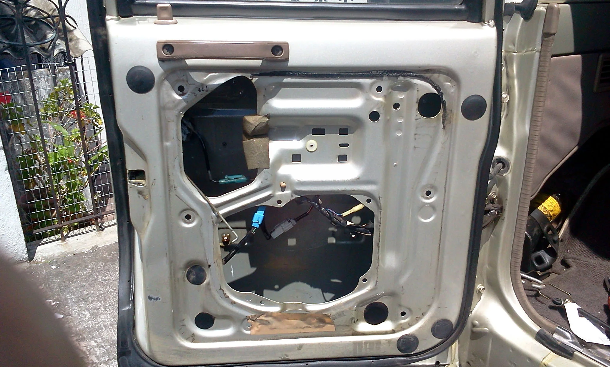

This is what LX 73 Series rear doors look like.
I guess the PO got a truck without a spare tire carrier and then hit something hard. The same PO tried to cover the mess with bondo.

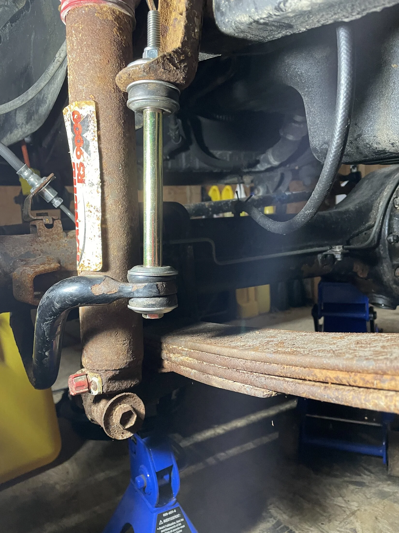

One odd end I’ve checked off the list are the sway bar end links. The stock ones were too short so I ordered the longest ones from Energy Suspension: 9.8121G
I used the Toyota cushions and retainers. Looks better now.

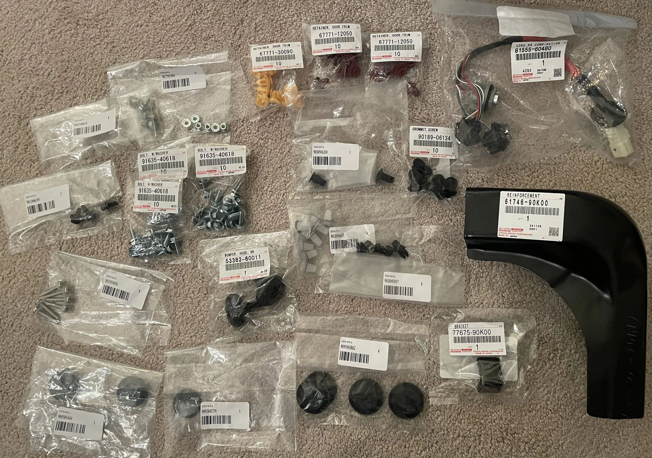

Back in November Megazip had 20% off, so I picked up a bunch of parts. They put the label on the box early Monday morning in Japan and it arrived in Manitoba at 11am on Tuesday. A Christmas miracle!
Door seals, a bunch of bolts for the side step, rubber plugs for the body, and a bunch of the little plastic screw/bolt inserts for the body. Also a million of the little plastic attachy-thingies for the door and interior cards/panels.
I like to pick up some small “feel good” simple improvement parts, in this case the hood bumpers and nuts; Bumper, Hood, Front Toyota, 53382-60011 and NUT HEXAGON Toyota, 90170-08034 😃
I have a little bit of rust 😳 in the back left corner, so I ordered a body part that seemed correct in the diagram. I’m not quite sure, but, I’ll see. Part number 61746-90K00 - Reinforcement, Back Door Opening, Lower Lh, Toyota. I thought it is the corner piece that curves down. Maybe not.

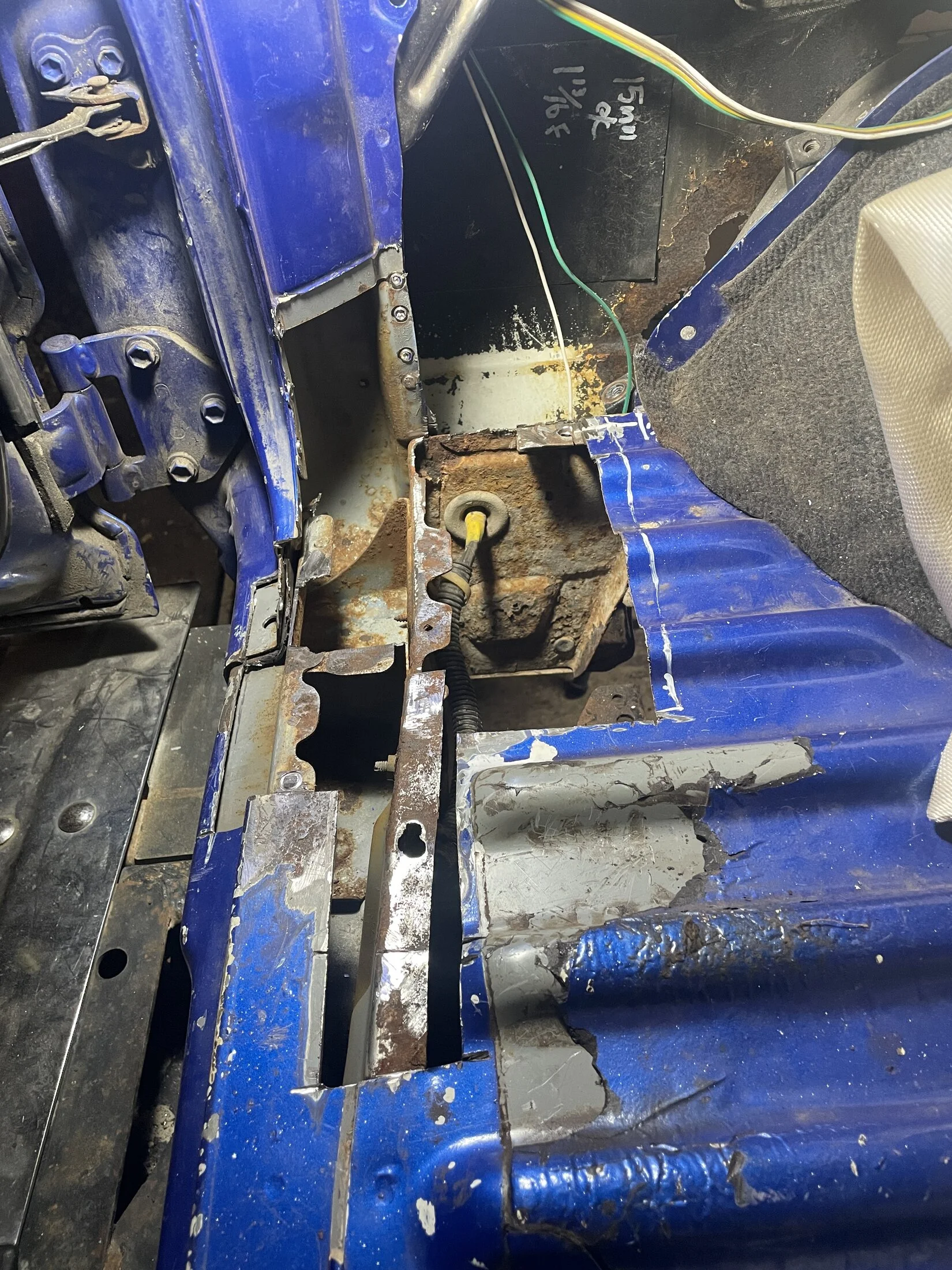

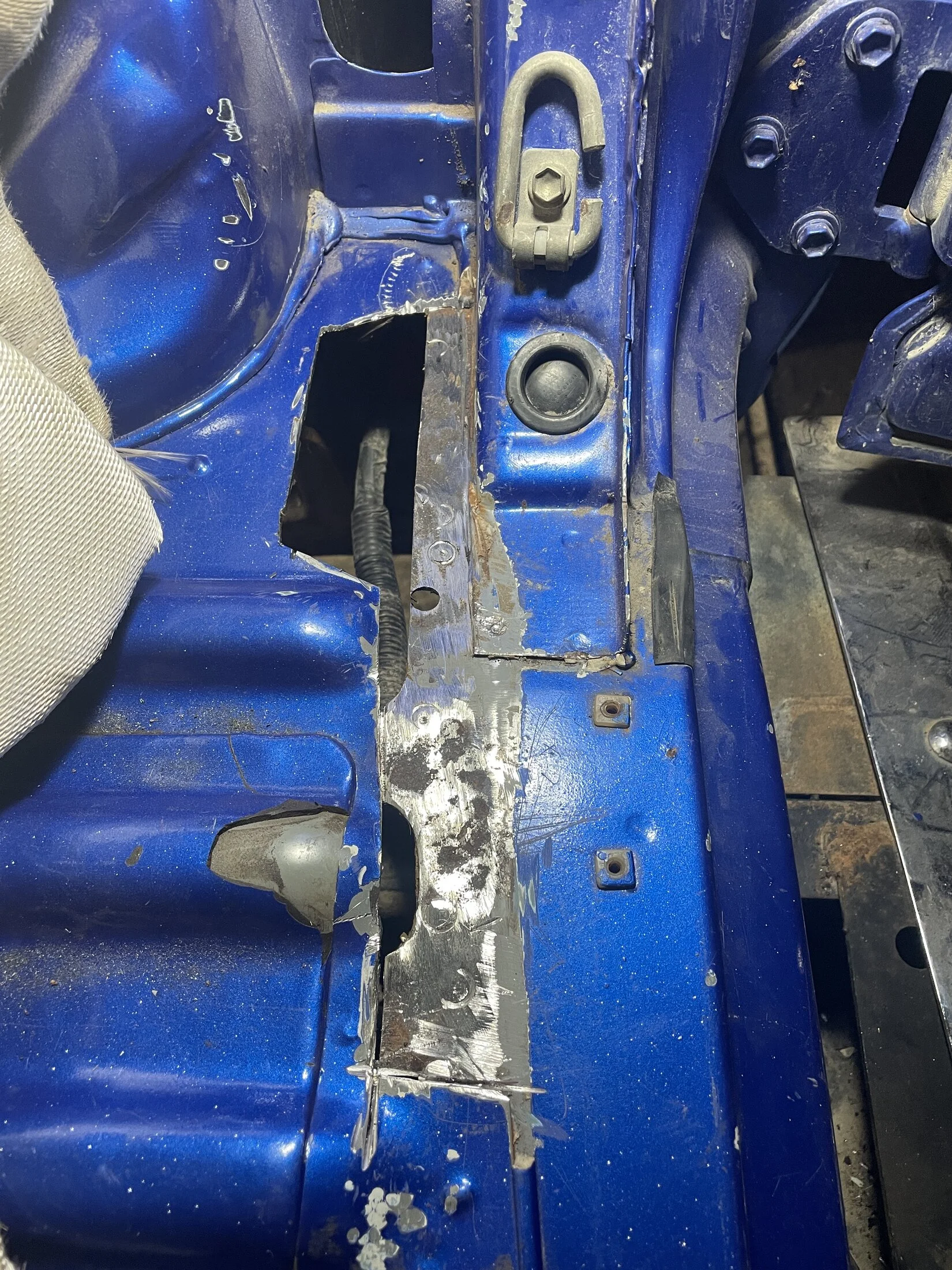

I’ve cut the rust out from the back two corners at the back. I used a cut off wheel on my grinder and a Dremel for two of the tight areas. I think I’ve got it to where I can fabricate the pieces and weld them in.
Left corner:
Right:
The corner piece that I bought was the inside support piece that most of the parts are welded to. So, not the right part. I now have a spare 61746-90K00 - Reinforcement, Back Door Opening, Lower Lh 🙃
