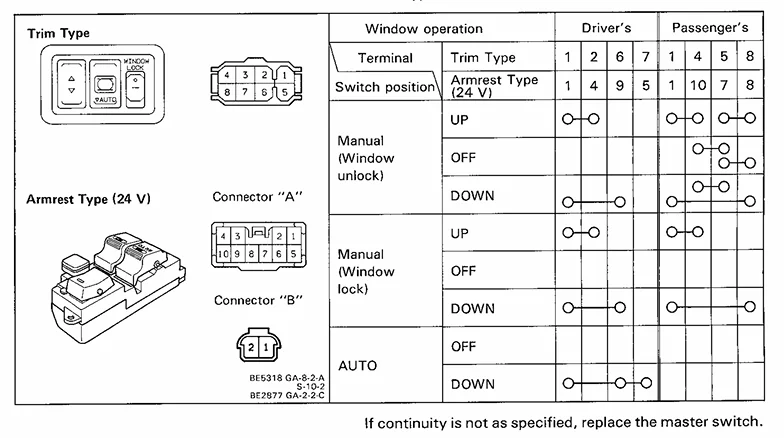

Possible replacement switch? It looks like it would work but I'm not sure. This part has a 8 pin connector and mine has a 10 pin connector. 84820-10090 YAOPEI 84820-10090 Front Right Electric Window Switch Lifter for Toyota Hilux Hiace YARIS Land Cruiser 8482010090 RHD FR - AliExpress 34 - https://www.aliexpress.com/i/1005005569989712.html

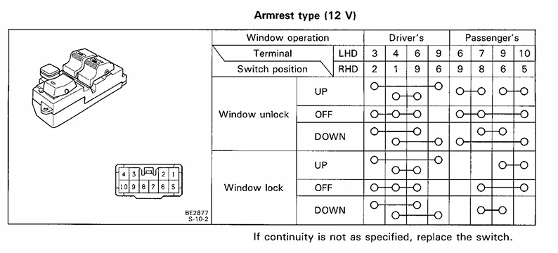

Hello,
Some 24V controls use a 10-pin connector.
This is the connector pinup for both 12V and 24V.
Hope this helps.
Juan

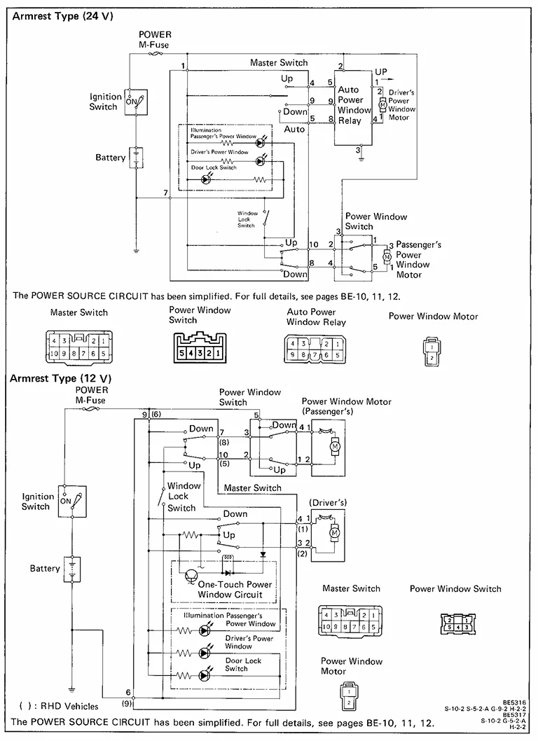

Hello,
It helps to keep this in mind: one number, one pin. When studying the circuit diagram, follow the number.
Hope this helps.
