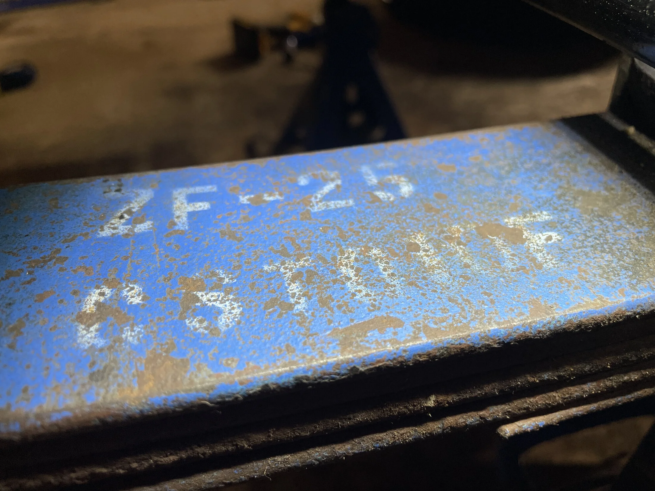

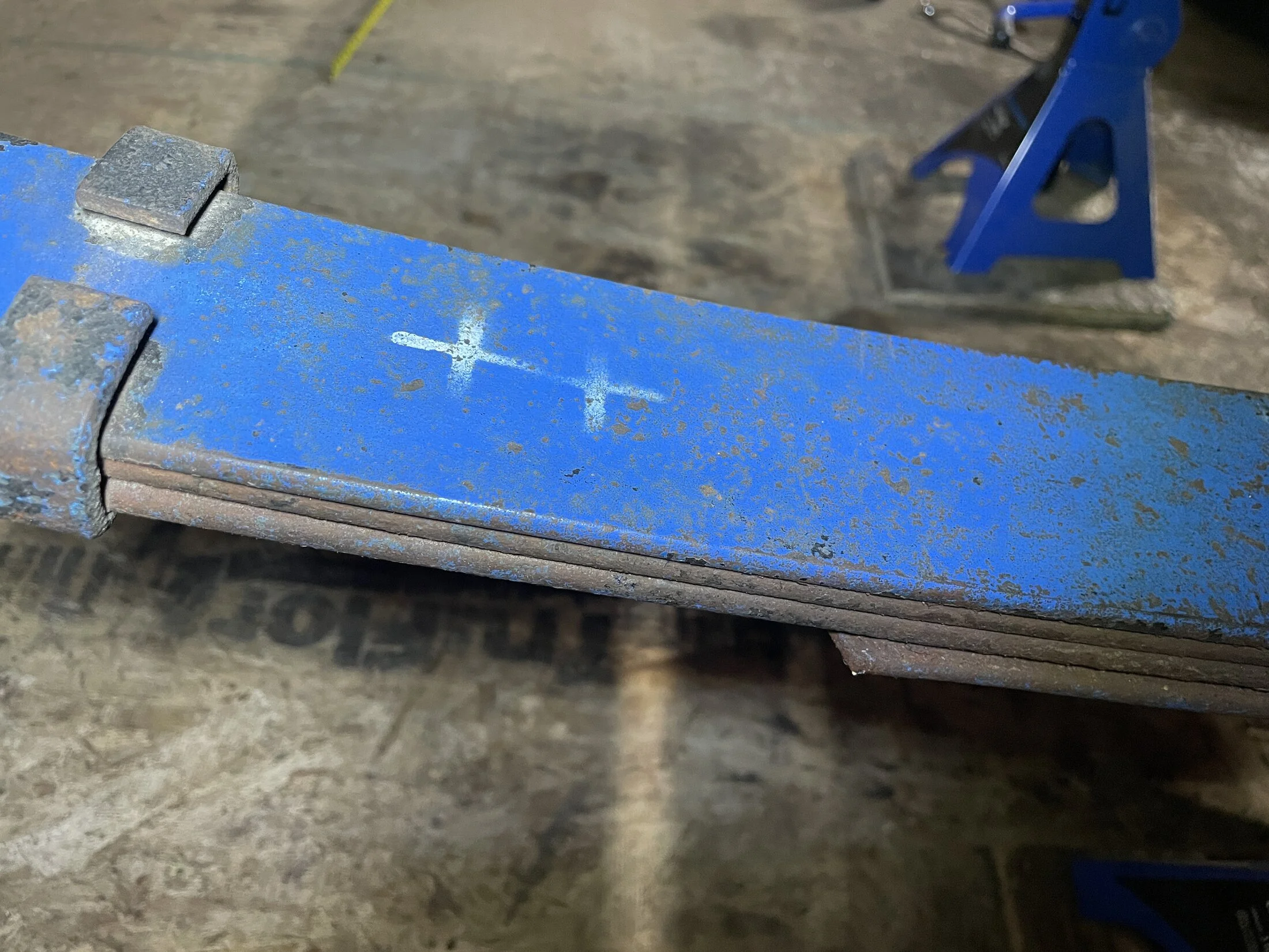

The letters on the spring are ZF-25 and CSTOIO or CST010F. There is also a ++ marking as well. Is anyone familiar with 4x4 Engineering stuff?

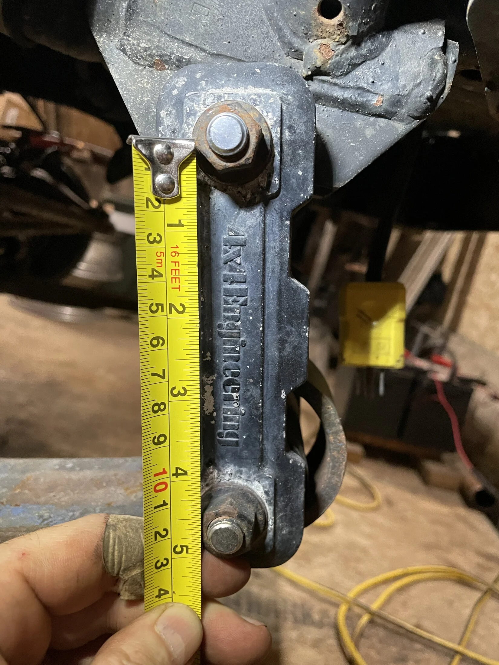

The shackles are 4 3/4” bolt centre to centre, which I think correlates to their “short” shackle and a 60mm lift - 2.3”. Does this mean I need a bush/bolt combo that is 2” to 2 1/2” longer then the original 3 3/4”?

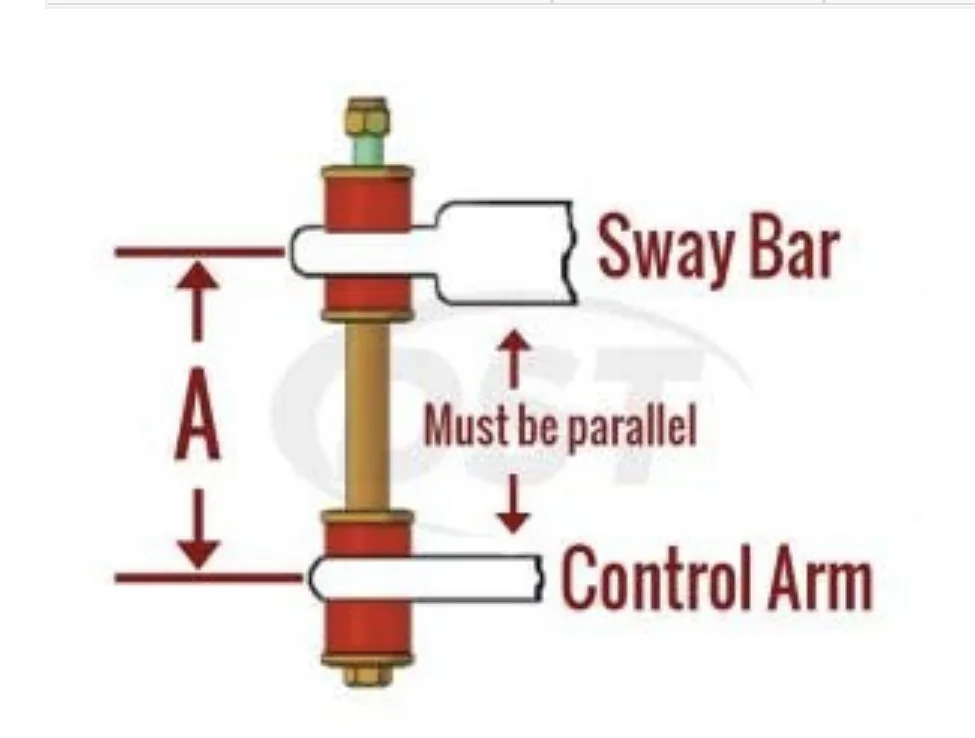

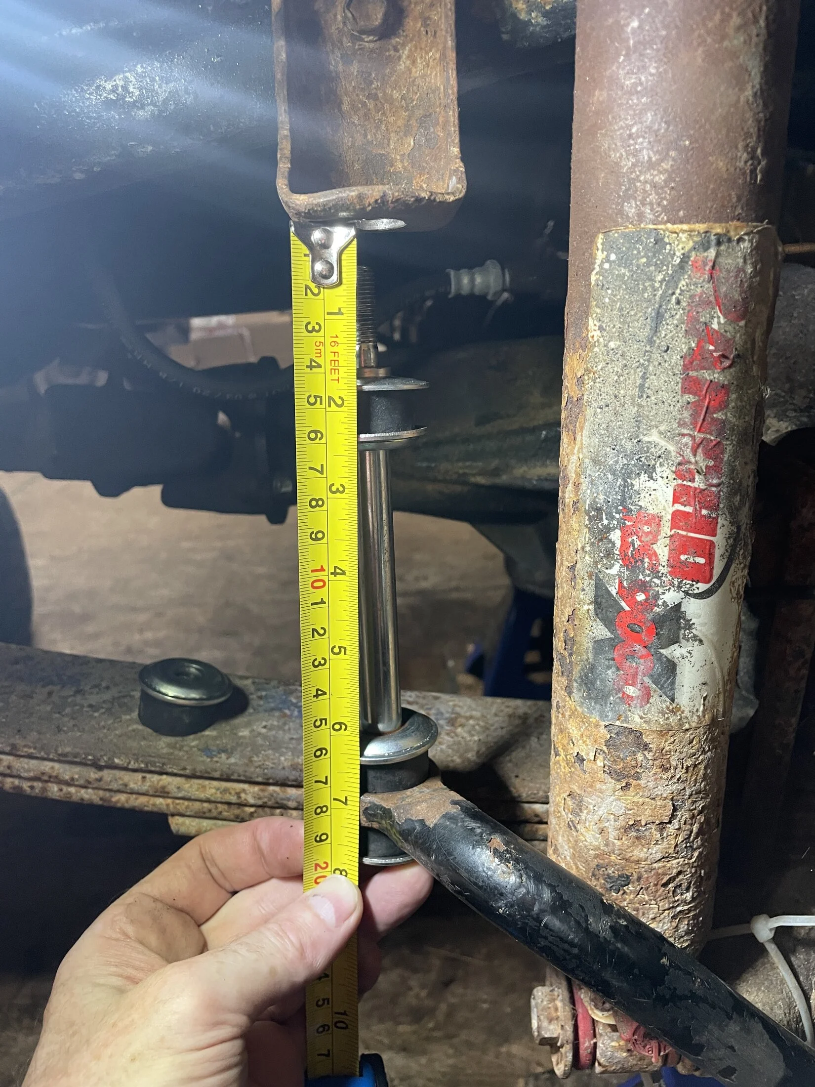

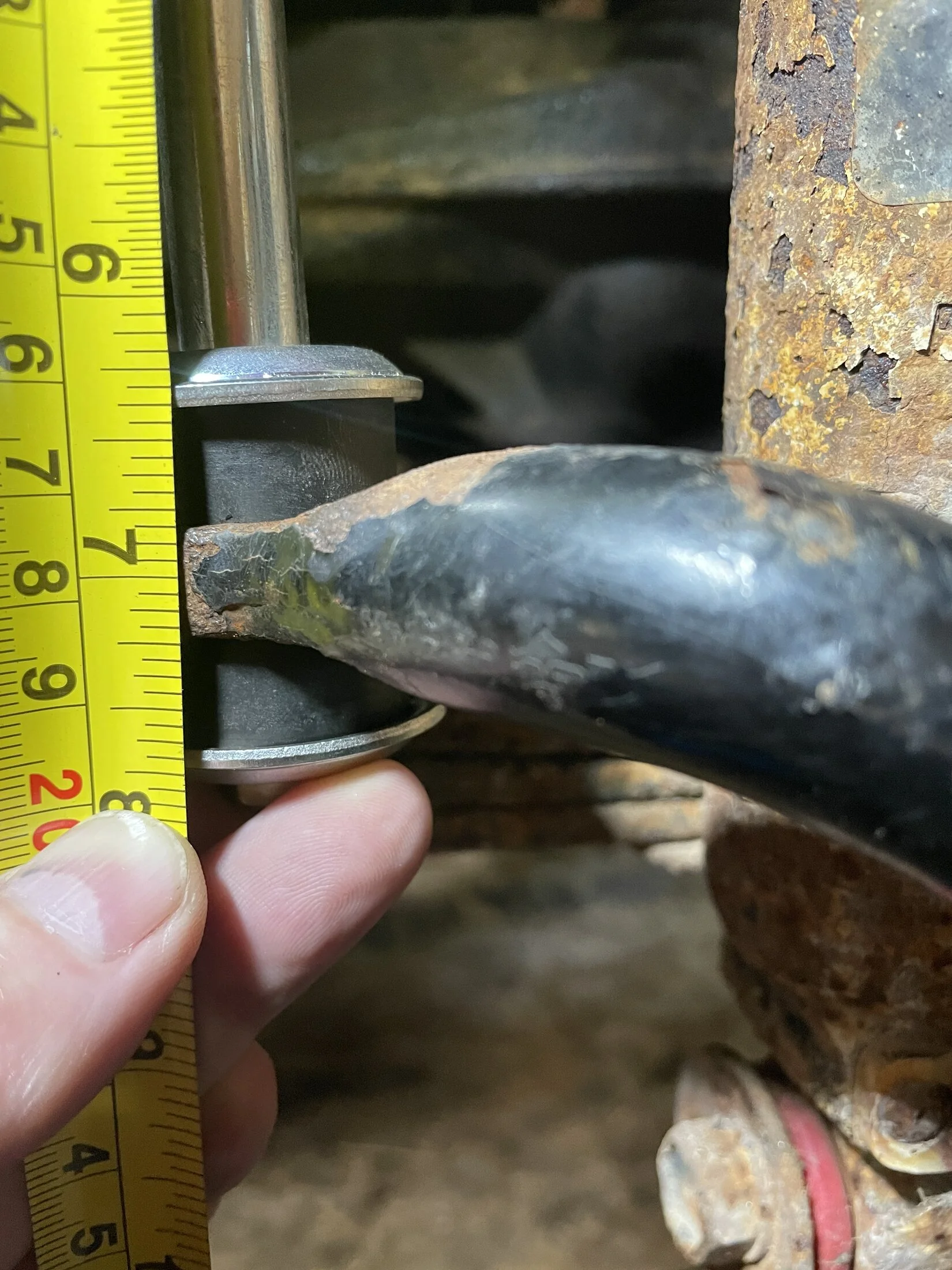

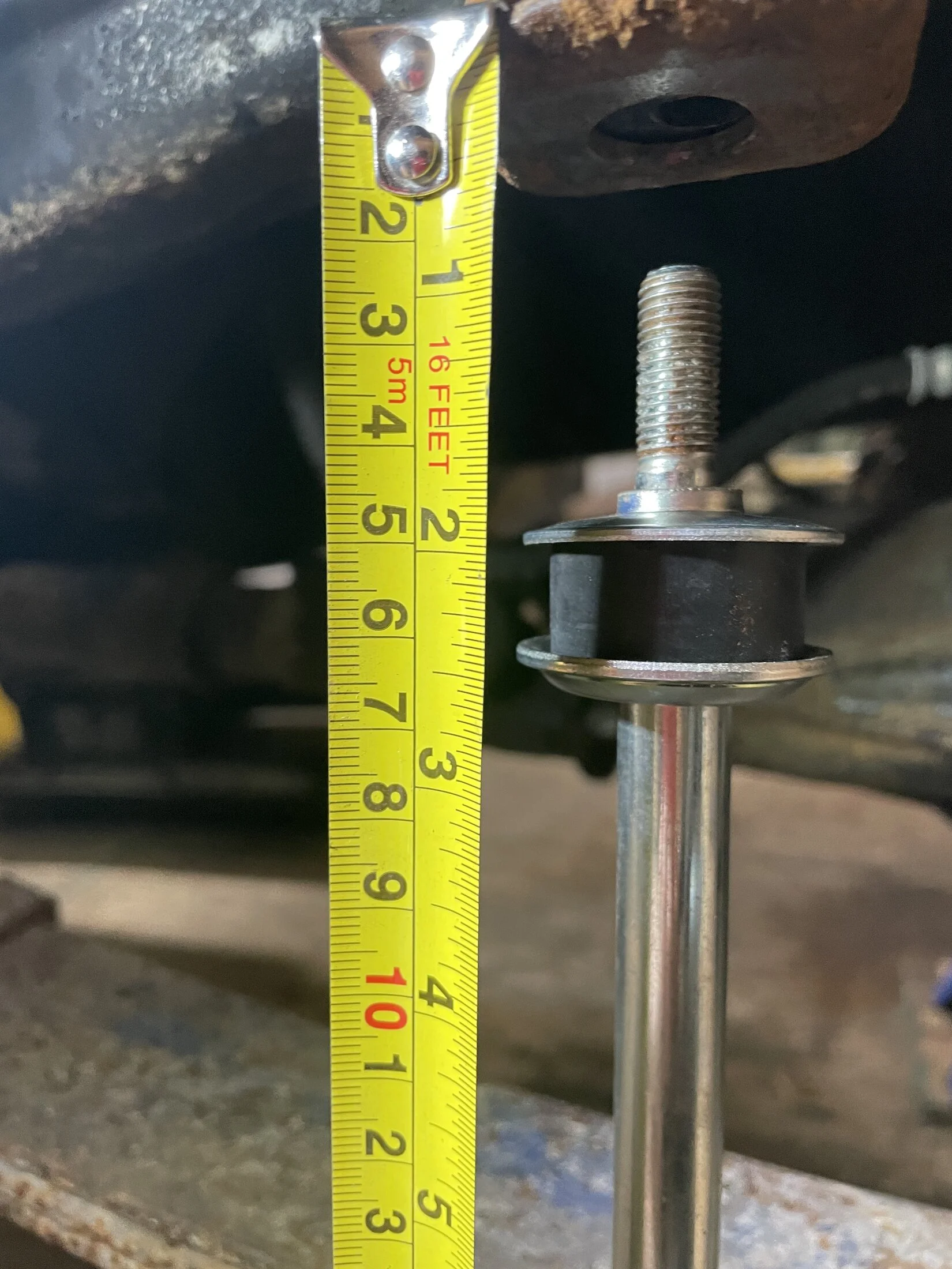

I went out and did some measuring on the weekend. The ’73 is up on jack stands that are under the axles so I think that should be accurate for a proper measurement. The “A” length is about 7”:
Does 7” seem about right?
The longest Energy Suspension sway bar end links are 6”: Universal Sway Bar End Links 9.8121 - https://www.energysuspensionparts.com/9.8121
I think I’ll get them and see how they look when tightened up. If they are still too short, I’ll extend and lower the bracket that bolts to the frame the correct amount.

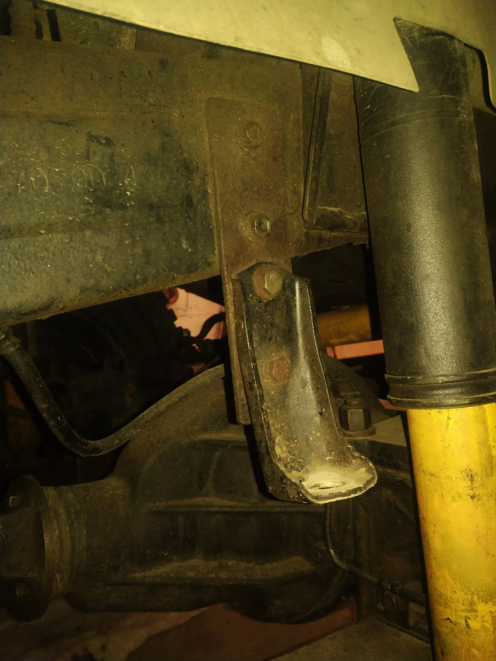

if you are going to space your top mount down you are in a good place right now as you want the mounts to have a clear spot to run bolts through the flat bar and not hit frame.... id go with what you have and some scrap metal

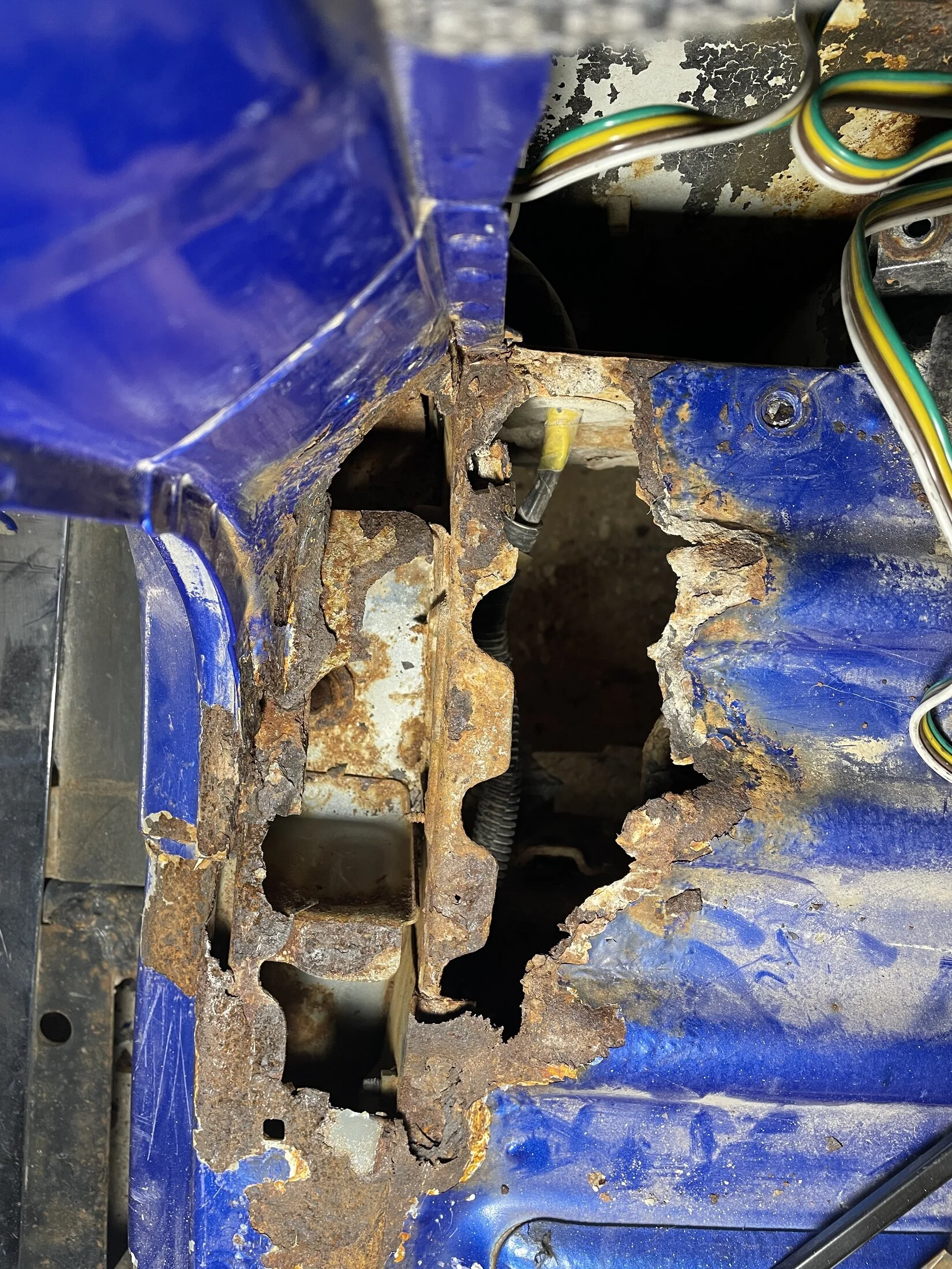

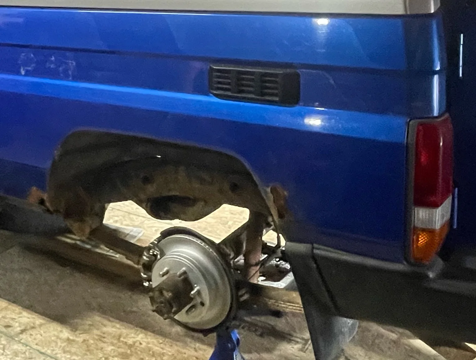

So, it’s been a busy few months, working on everything but the Land Cruiser. I got out last weekend to start the rust investigation and remediation. The back left corner needs the most work, so I started there. I’ll need to replace most of the quarter panel from in front of the wheel arch back and down from between the top of the wheel arch and the first bend, a hole in the rear lamp bucket, the lower 2 inches of the door bracket and about a square foot of the floor in the corner! FUN!
The quarter panel

The left rear corner of the floor looking straight down from above 😳
I’m going to assess the right rear and both rockers tomorrow.

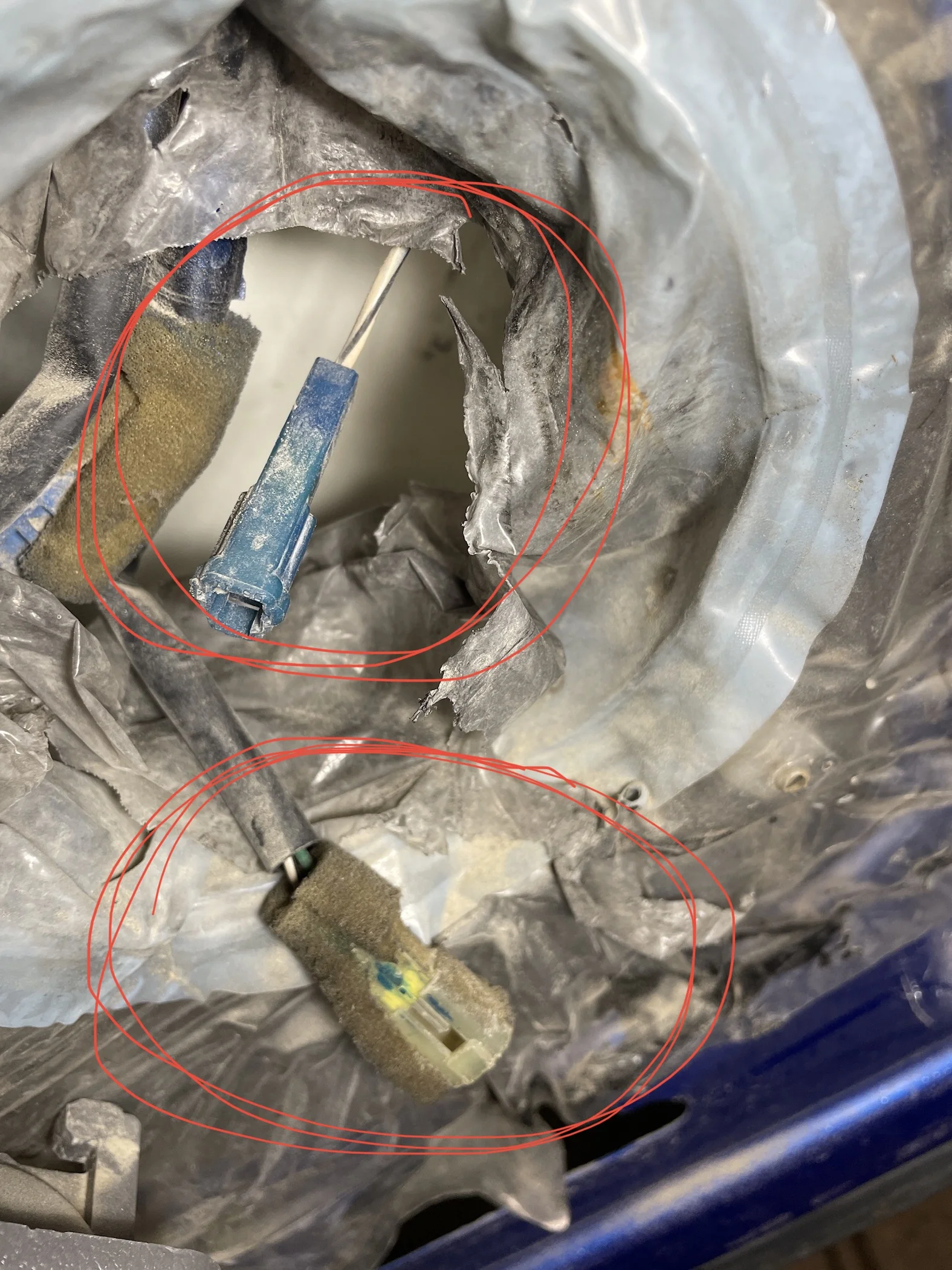

  1. There are two connectors inside the left door. The blue one has a single wire that is white with a black stripe. The yellow one has two wires, one green one white. I believe the yellow one is for the light assembly, yes? What’s the blue one for?

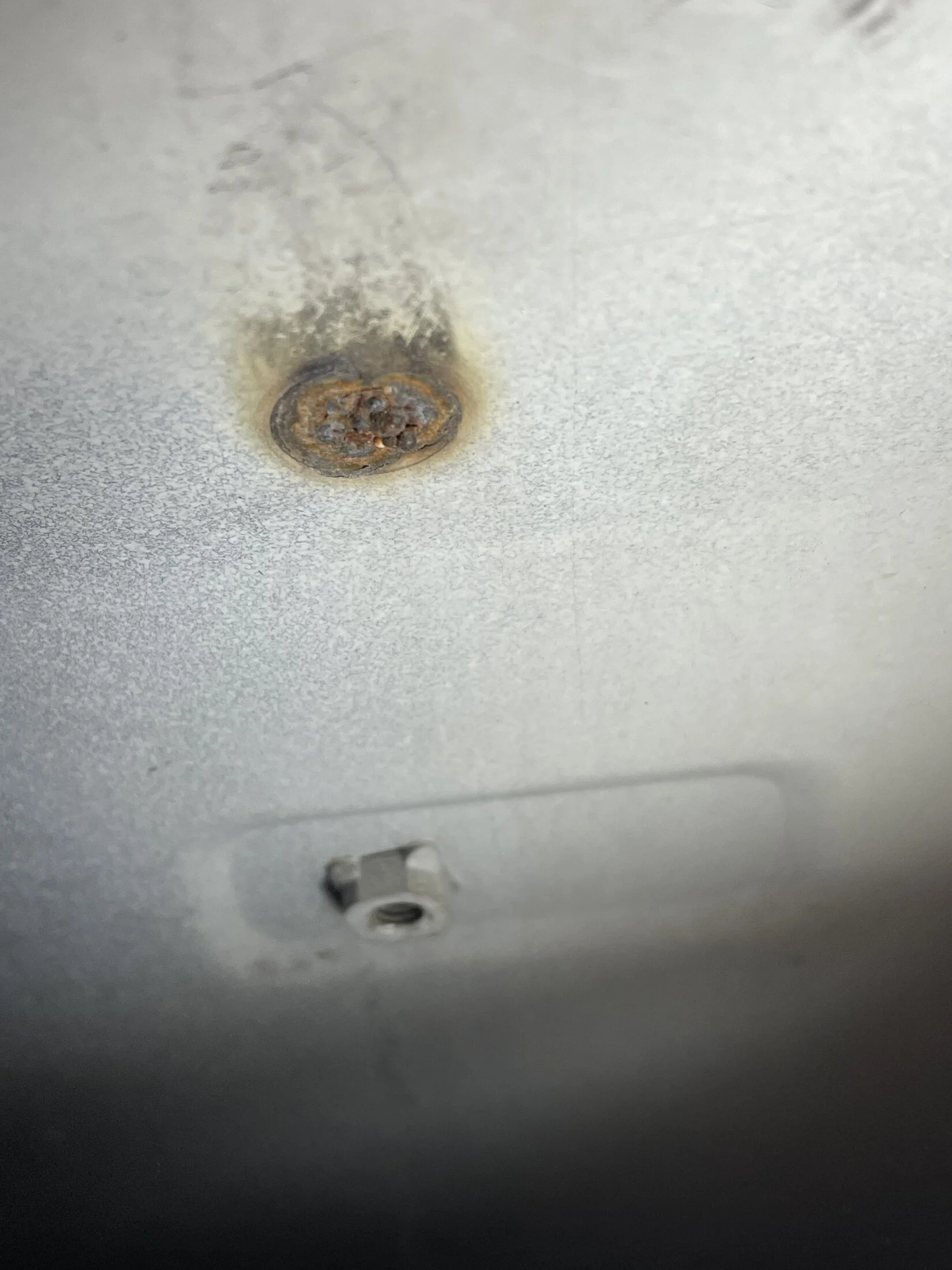

  2. It looks like two holes were filled, as there are two rusty spots, both above and inboard of the license plate mount nuts. Is that where the licence plate light assembly would mount? I think I just need to find a light assembly, drill the holes back out and mount it, yes?

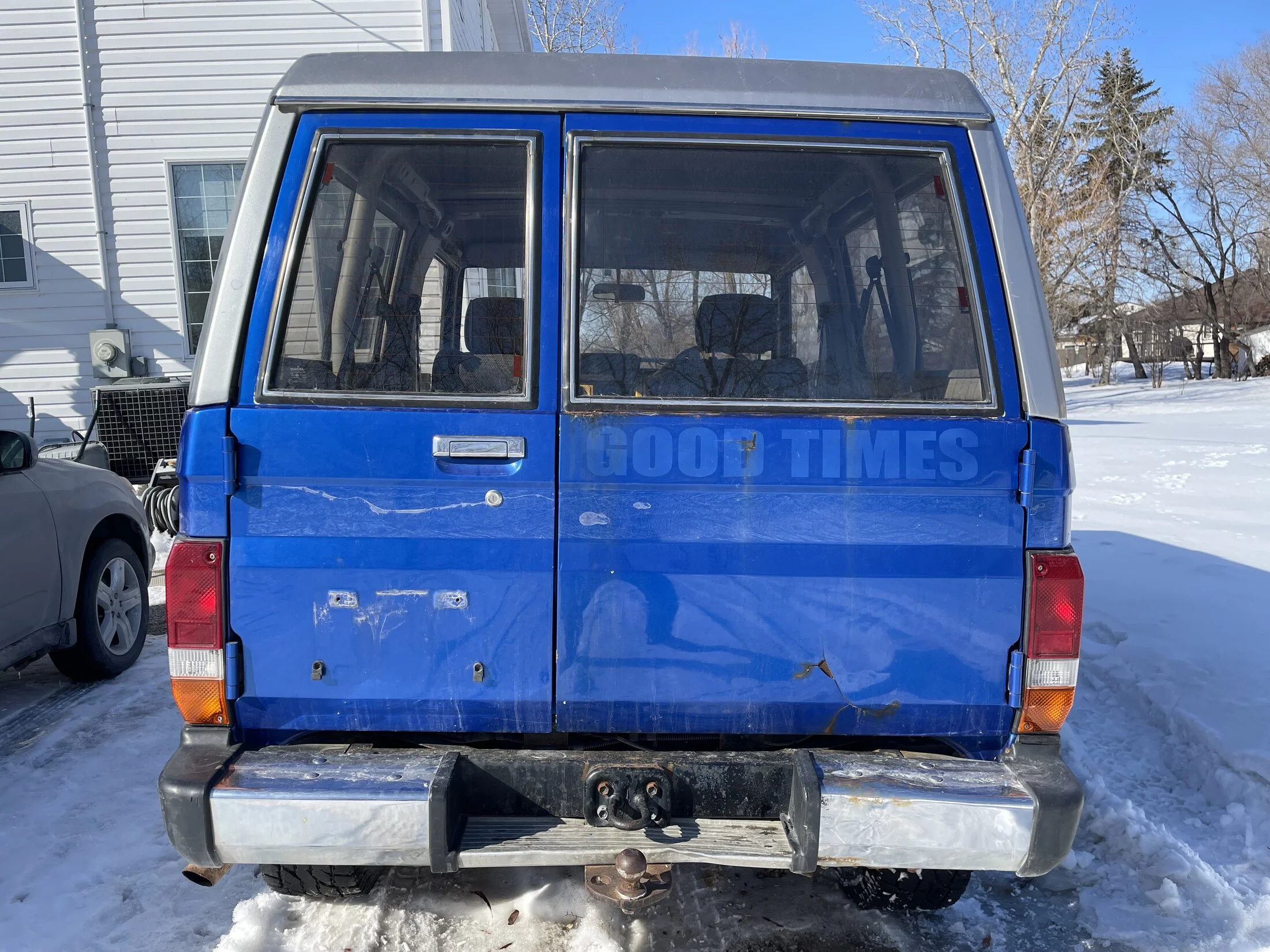

  3. The right door looks like it’s reinforced for a spare tire mount. There are two vertical brackets inside. How do I tell for sure? Would my HZJ73 come without one? It’s an LX.

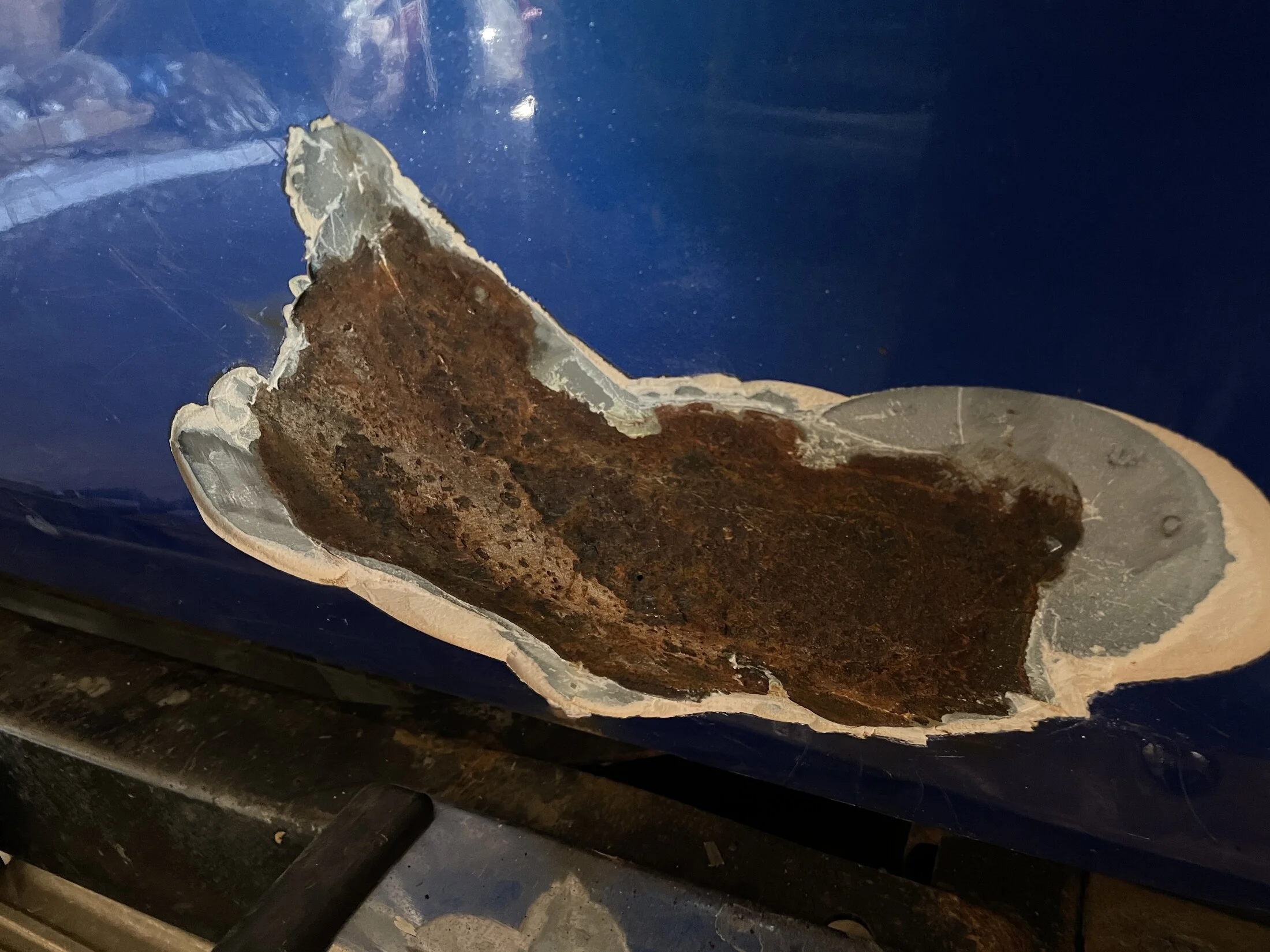

There is a good layer of bondo (bog for our Aussie and Kiwi friends) in the right door that’s cracked and starting to flake off. I’m pretty sure the PO in Canada either backed into something hard or was hit, resulting in the cracked and flaking area. I chiseled it out to good metal as I need to stop any further rusting.

As for back door I *think* OEM was standard spare on back door for most 70s. Troopy mightve been an exception... Possibly dealer installed in some markets?
