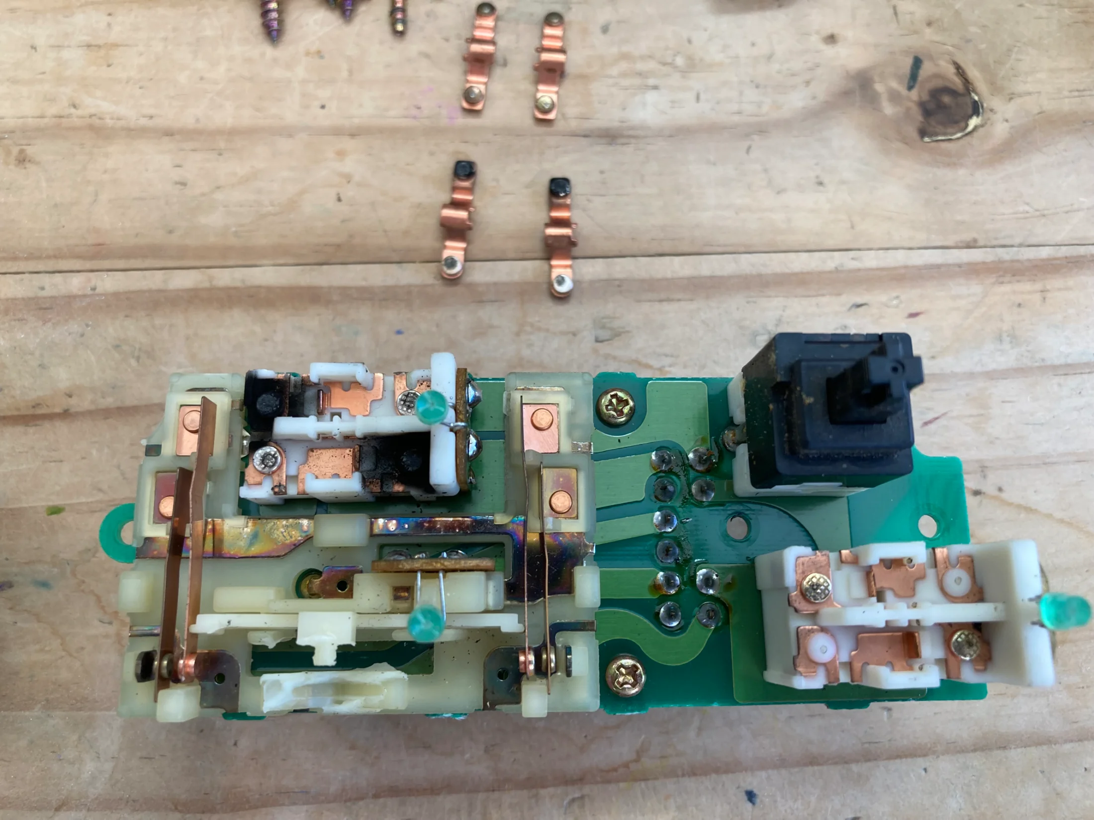

I didn't test the motor but the switch looks pretty used and I when I took it apart some of the contacts fell out. I'm going to clean the contacts but I have no clue how the contacts go back together. The top left is the passenger window, the bottom left is the driverside window. Any help would be greatly appreciated.
Hello,
Top left goes to upper left on the switch assembly. Top right goes below. Use the carbon buildup as a match mark.
Bottom left and bottom right go to lower left on the switch assembly.
The buttons balance over the contacts. It is a pain to put them back properly below the button, and not really worth the effort.
Judging by the amount of carbon buildup in your switch, it is likely it gave up the ghost. You can clean the carbon and put it back together. It will work a few times before failing again.
Ask me how I know.
It is time to replace your switch assembly.
Juan

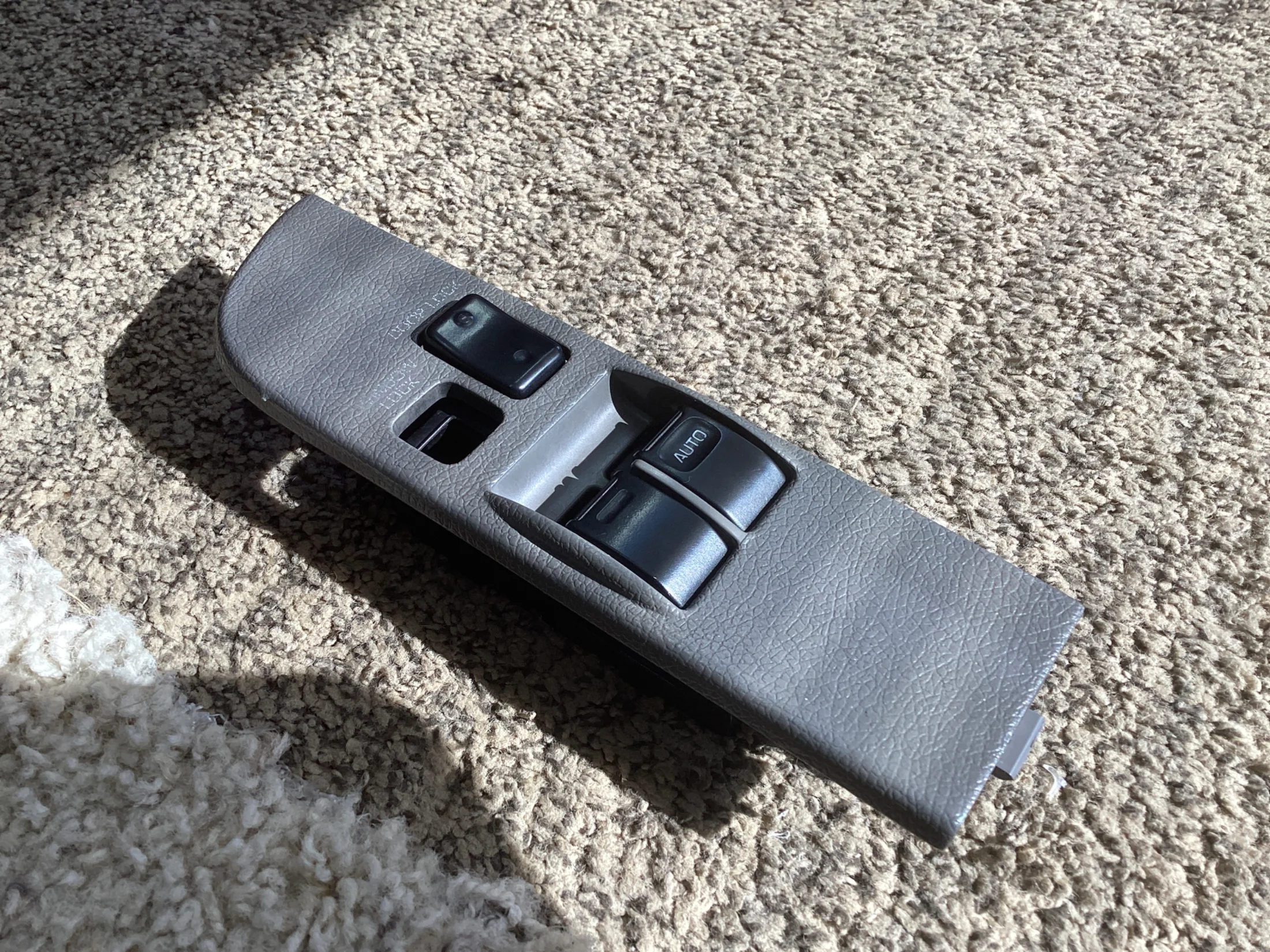

I tried to find a new one to buy but I had no luck on my search. Anybody know the part number? I has to be 24 volt. Or maybe someone will sell me a used one?
The parts page I posted will lead you to (as far as I know) all the part numbers once you find your specific vehicle. And you may be surprised what you can get through Toyota sent to a dealer.
I searched and had no luck finding a part number. I would much rather have a new part than a used one.
Maybe I'll order at 12v switch from a RHD vehicle, part number please?
