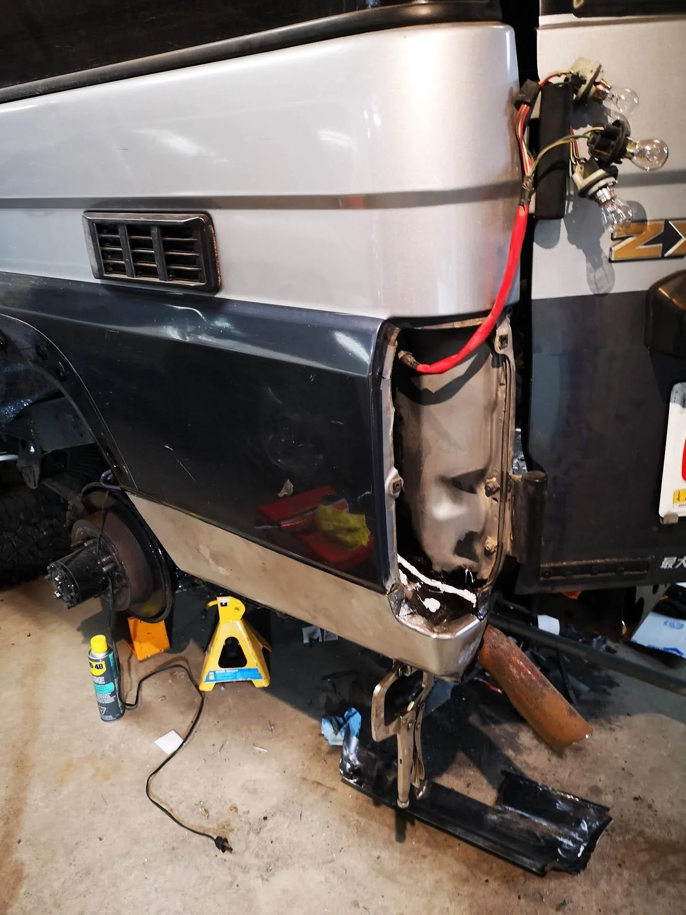

I finally got to work this weekend. It was -13 on Saturday and -5 Sunday. Balmy!

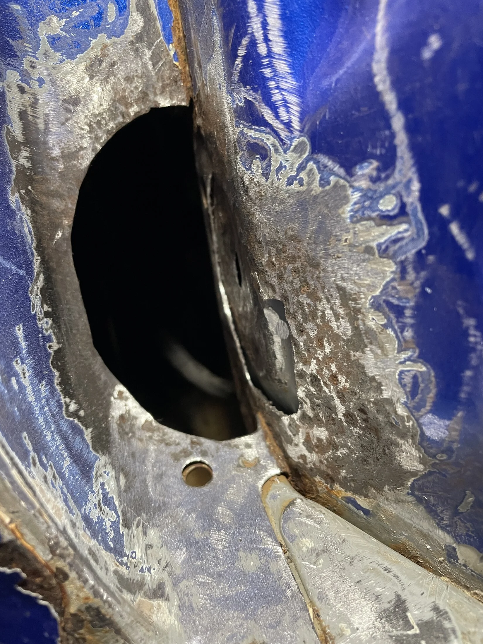

I bought a WEN 6307 1/2" detail sander to help make cleaning up rust and drilled out spot welds. It came in handy for the left taillight housing.
Before...
After...
Ready for repair!
I will have to do the same on the right side.

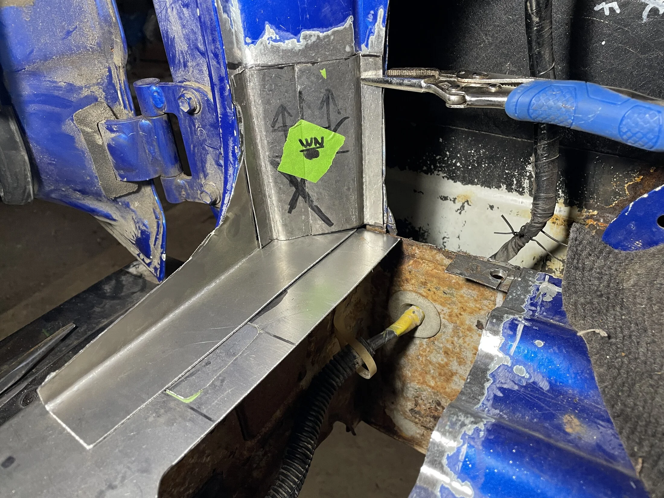

I started on the inside back corners. I've never done any metal forming or bending so I dove in and made the first patch for the left side of the sill.
The first bends, with the piece of what remained of the corner...
Trimmed up so it fits...
And in place ... whoops....I marked the correct spot, but cut on an old line, so it came up a little short!
So I cut a piece to fit and I'll fix it with the welder.
I still need to drill holes for the spot welds, but it's ready to go. I need to run a new electrical circuit for my welder, so I've got to get that done before any serious stuff can happen. It's going slow right now, but it's going.

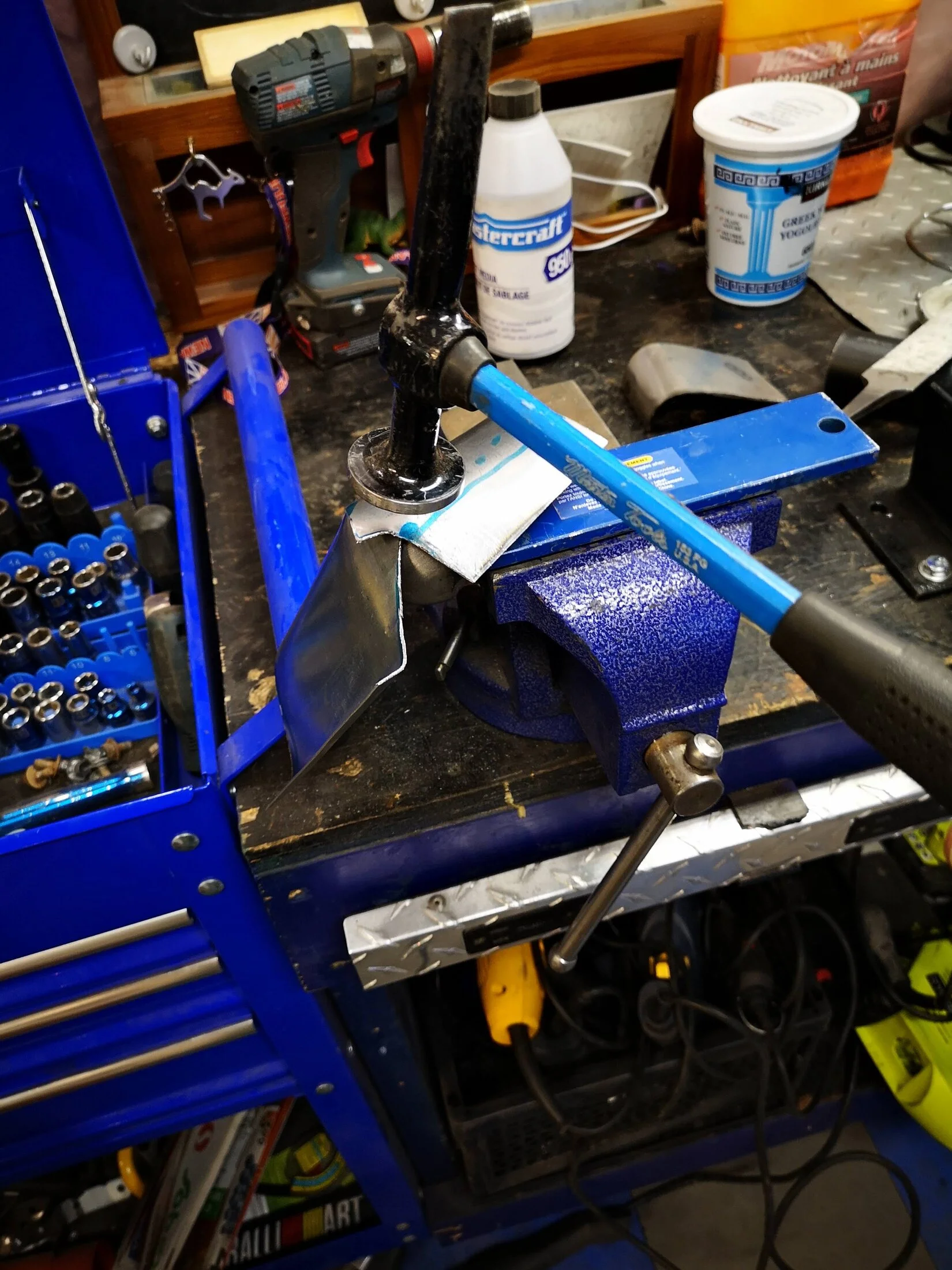

I bought exactly that and it helped quite a bit. Mushroom dolly held in a vise was also helpful. I made my pieces from paper first and then tried to replicate in metal.

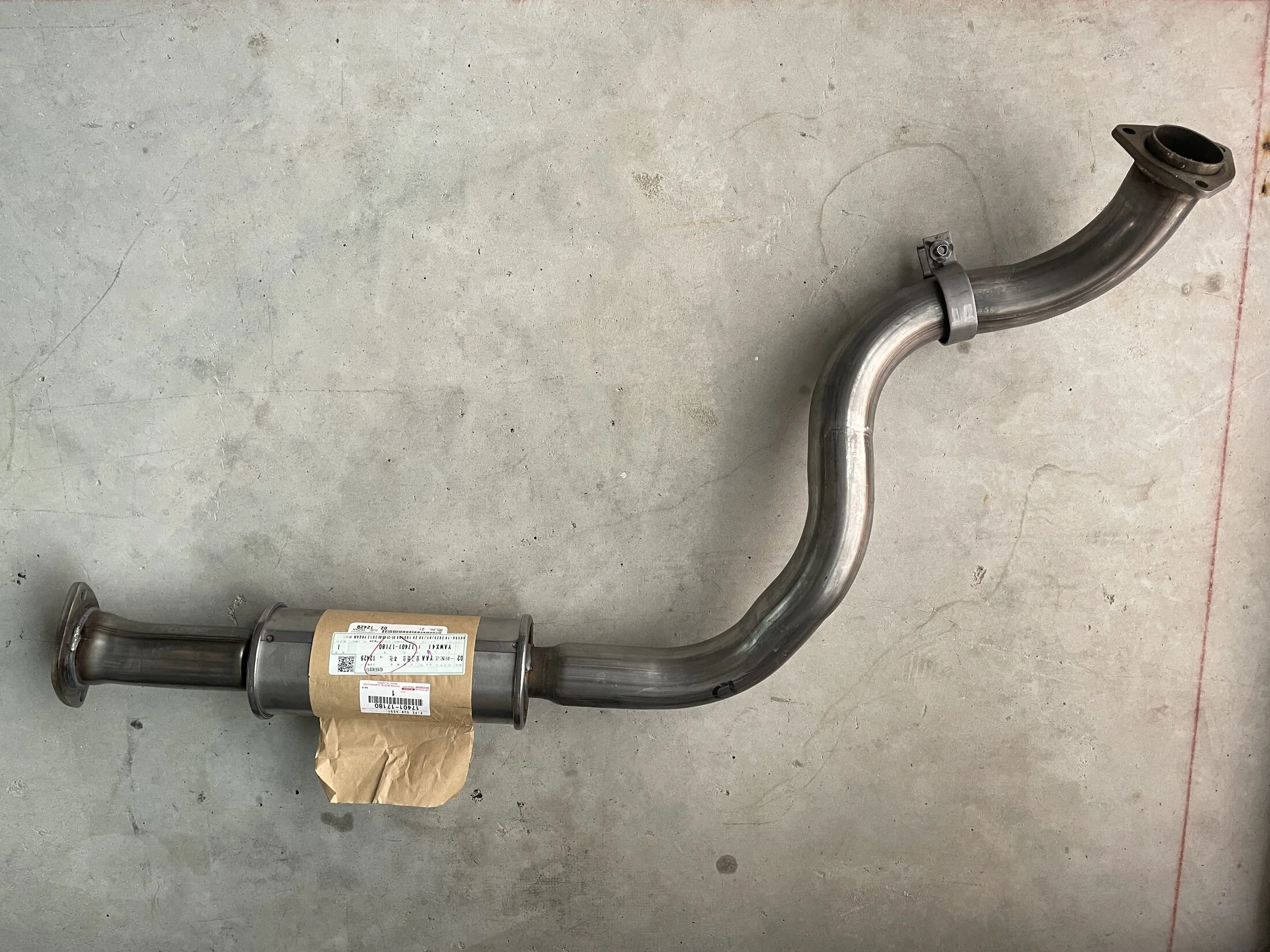

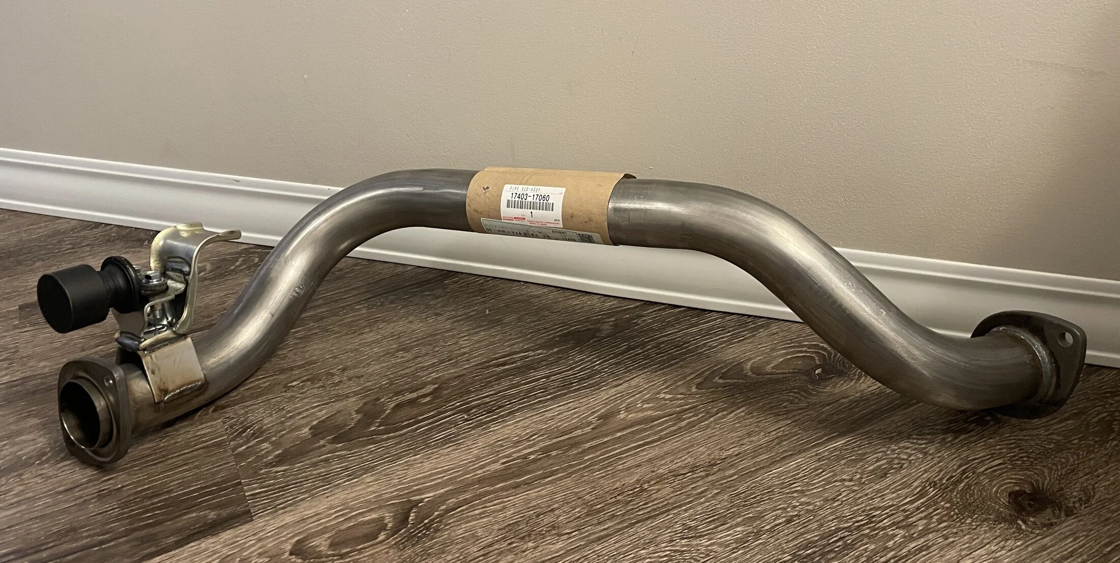

It’s been a slow winter for working. So, shopping therapy to the rescue. Megazip had a 20% off sale, so I decided the sale would offset the shipping costs so I pulled the trigger on some exhaust parts.
Front Assembly: 17401-17180
Middle Assembly: 17403-17060
Plus the various parts to make exhaust parts happy:
Gaskets for the between the pipes: 90917-06054 * 2
Gasket for the header: 90917-06059
Header studs and nuts: 90126-10006 * 3 and 90179-10070 * 3
The cushions and bolts for hanging everything: 17567-17010 * 3 and 90179-06007 * 12
The nuts and bolts were out of stock (wtf???) so I'll have to get them. I'll fab have up the muffler and tailpipe section, but I figure I can make that happen :)

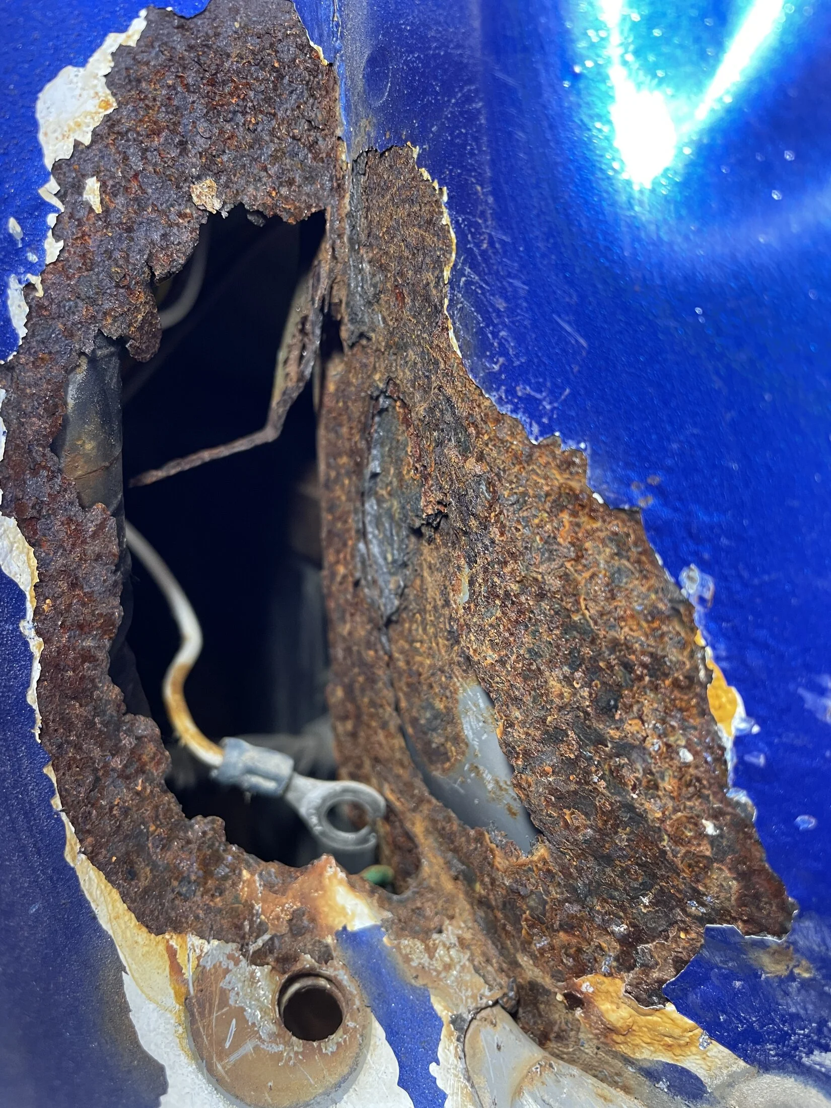

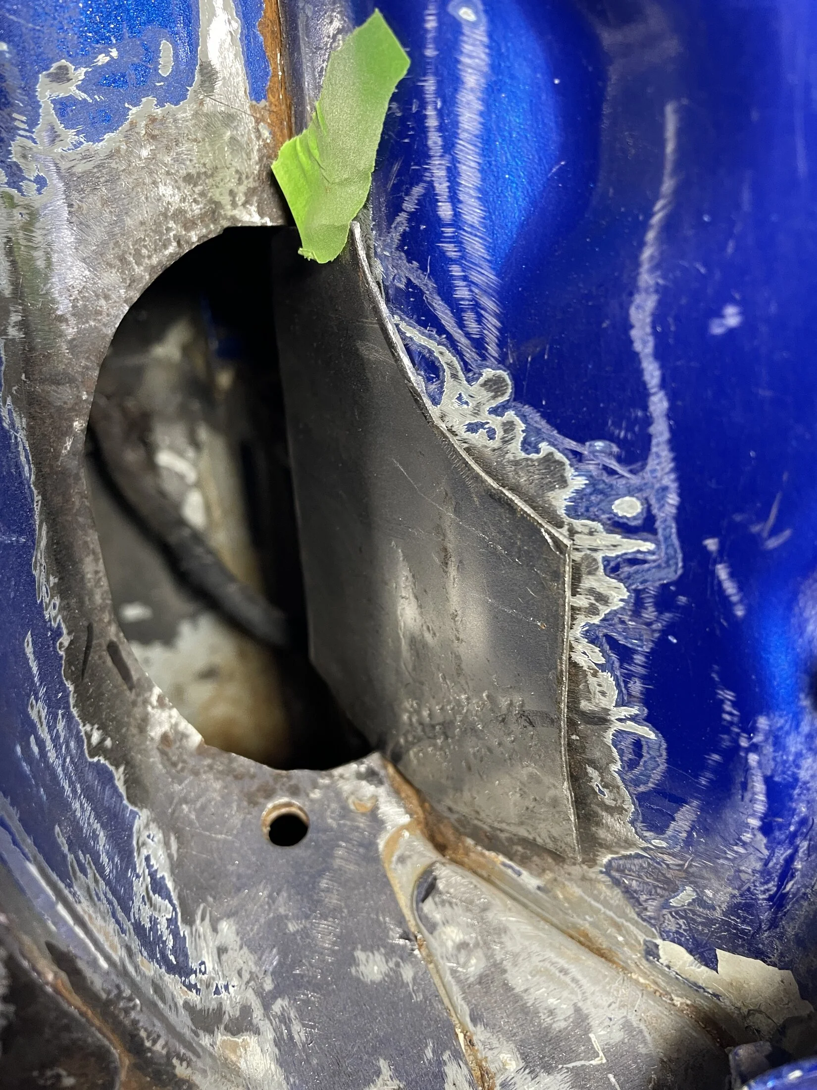

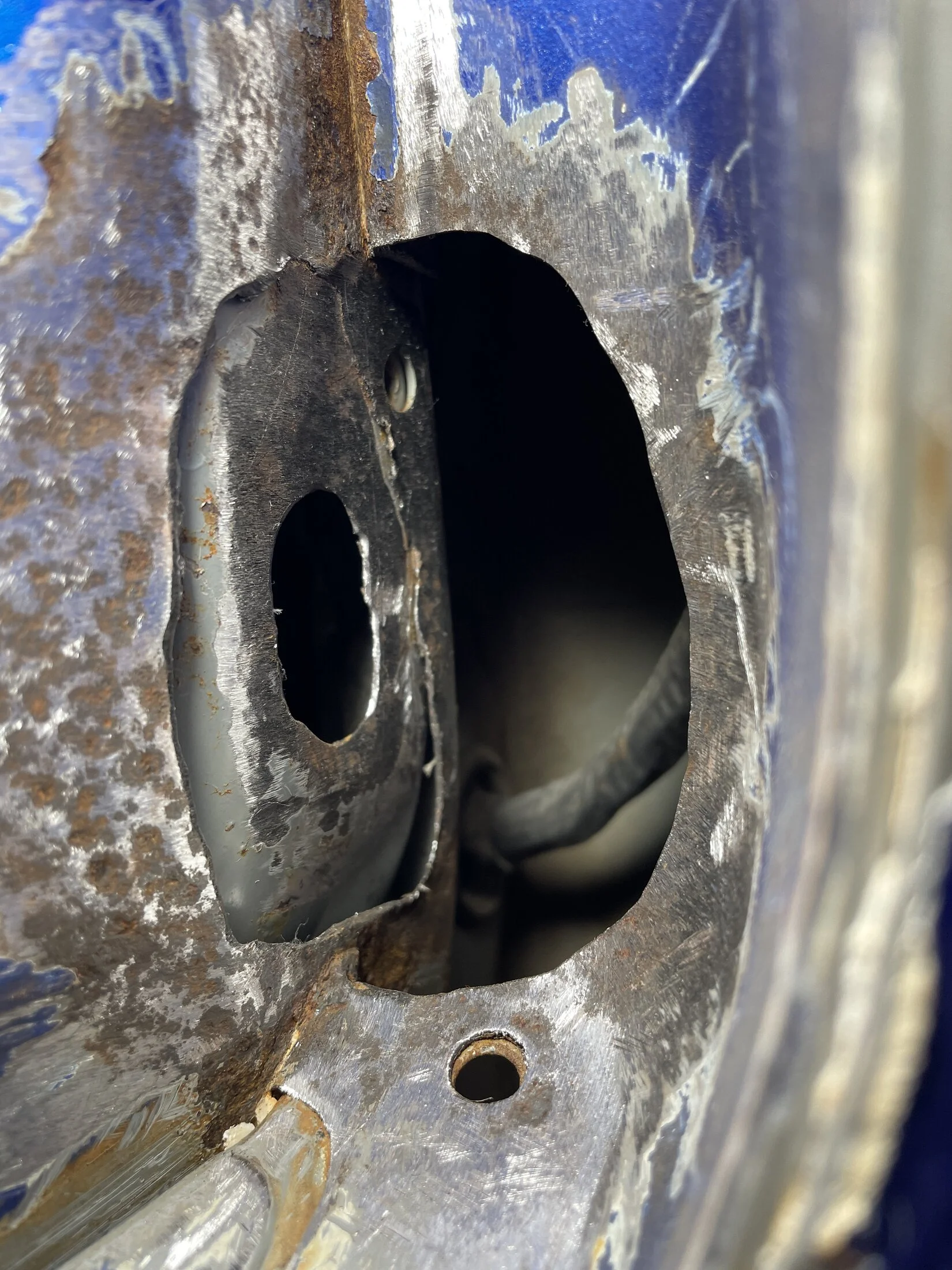

I’ve been working on the little, fiddly, areas in the back. Taillight buckets and the rusty corners. I posted some pics earlier, and I’m making progress.
Left taillight before:
Cleaned up with my mini belt sander:
Three hours later… a two part patch. I’ll weld in the flat piece on the door frame side:
… then the rusted out section of the bucket:

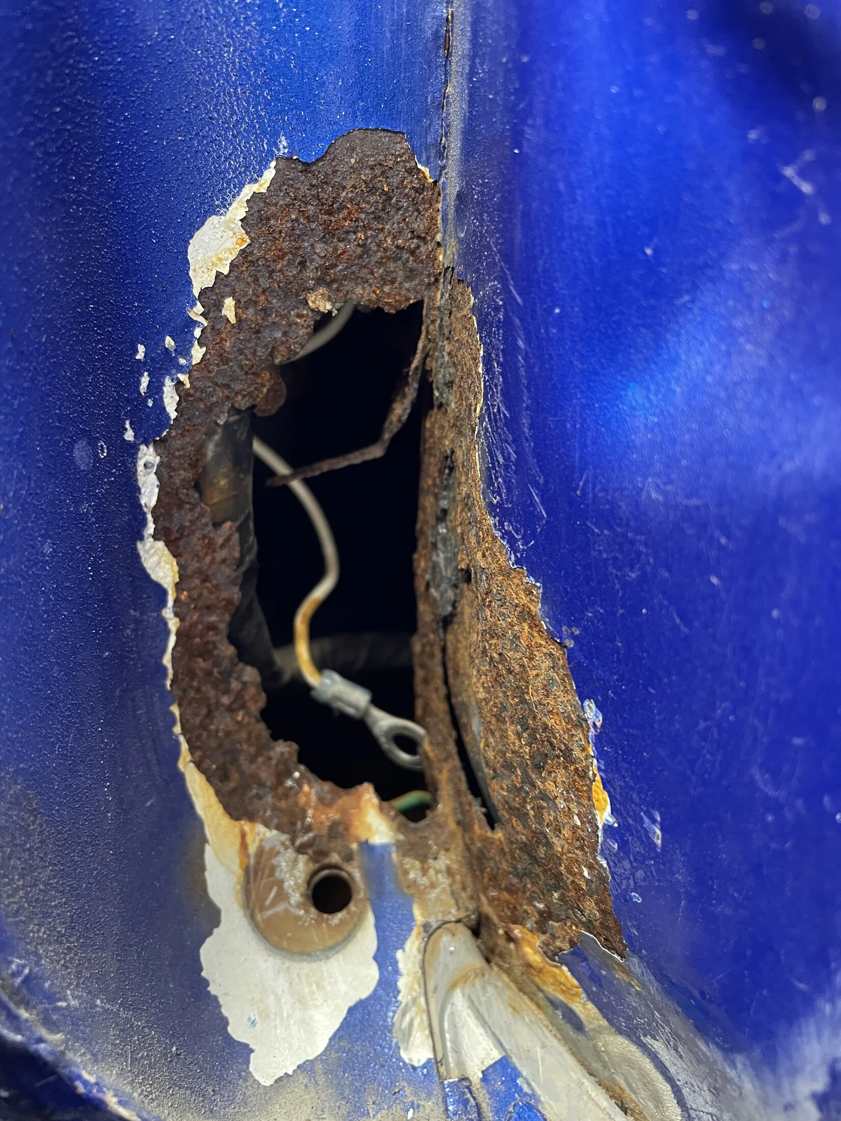

I don’t have a before of the right side taillight bucket, but it was a little worse the the left. Here’s the after, after chiselling out the seam sealer and sanding with the mini belt for about 3 60 grit belts
A close up. The body side was a lot more rusty
I’ll fabricate two pieces like the left side to patch it up.

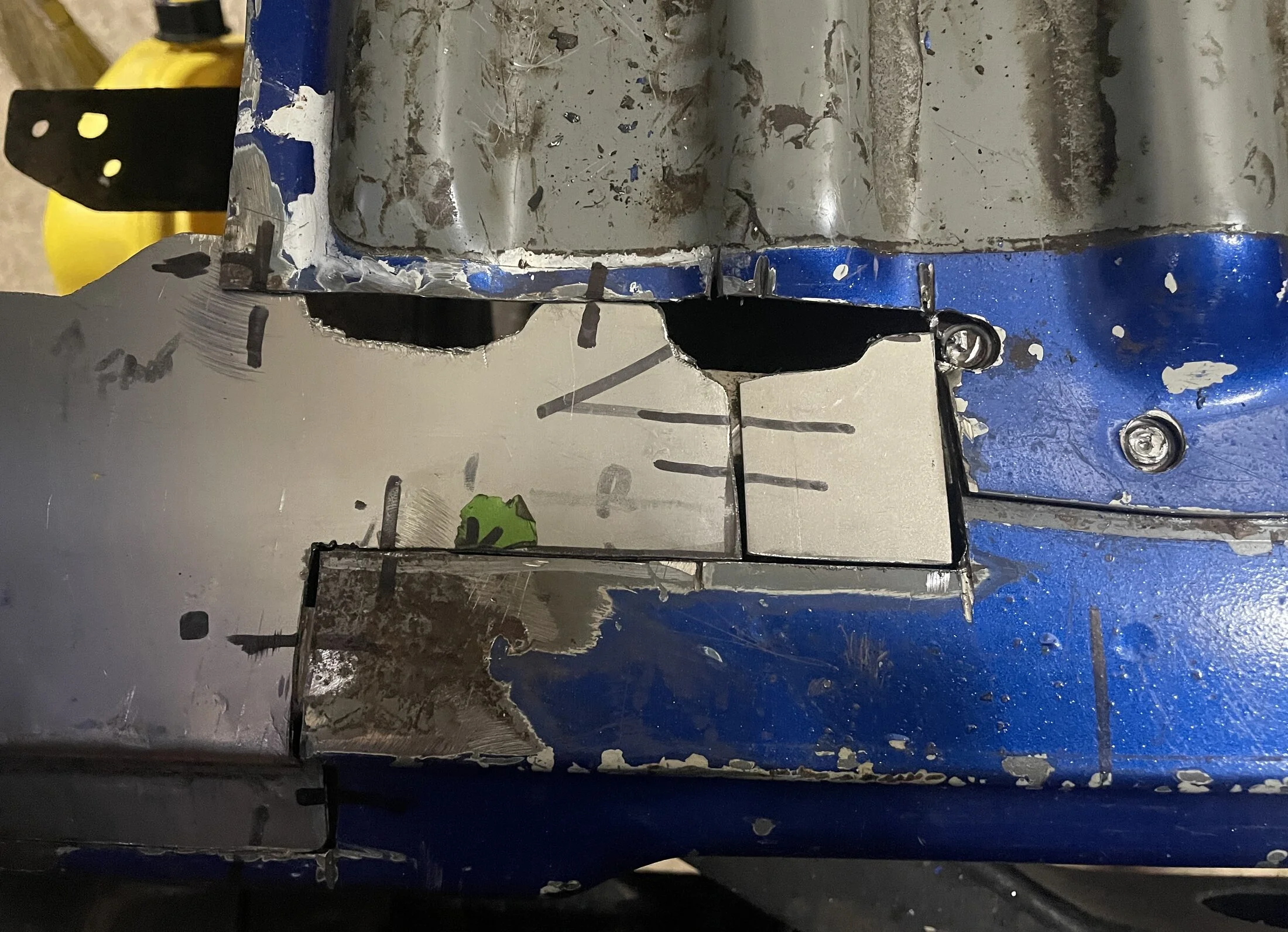

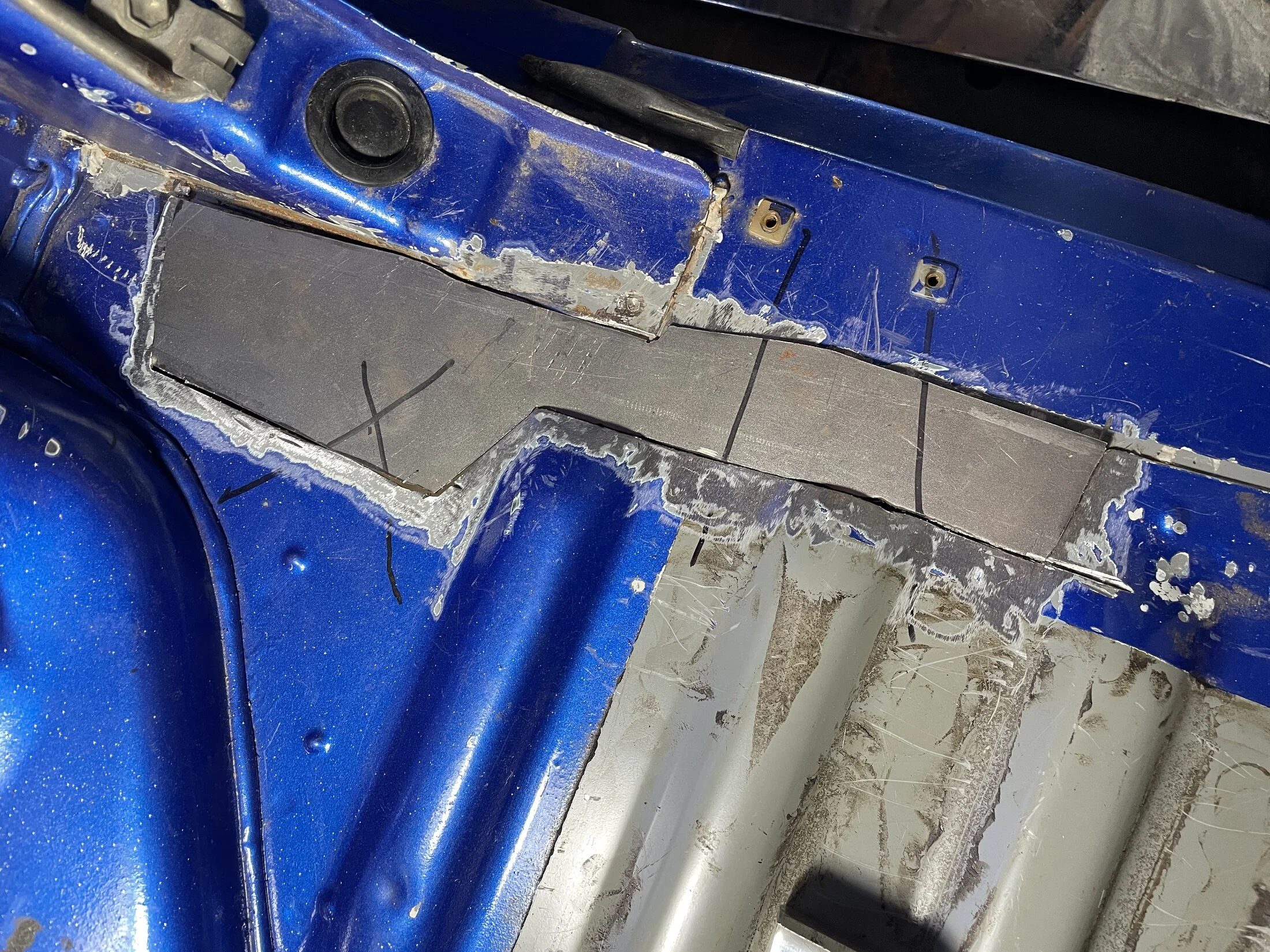

Other then the floor piece on the left, I’ve got things fabricated and ready to go in the back
Left side from the door opening
And looking towards the door
Right side:

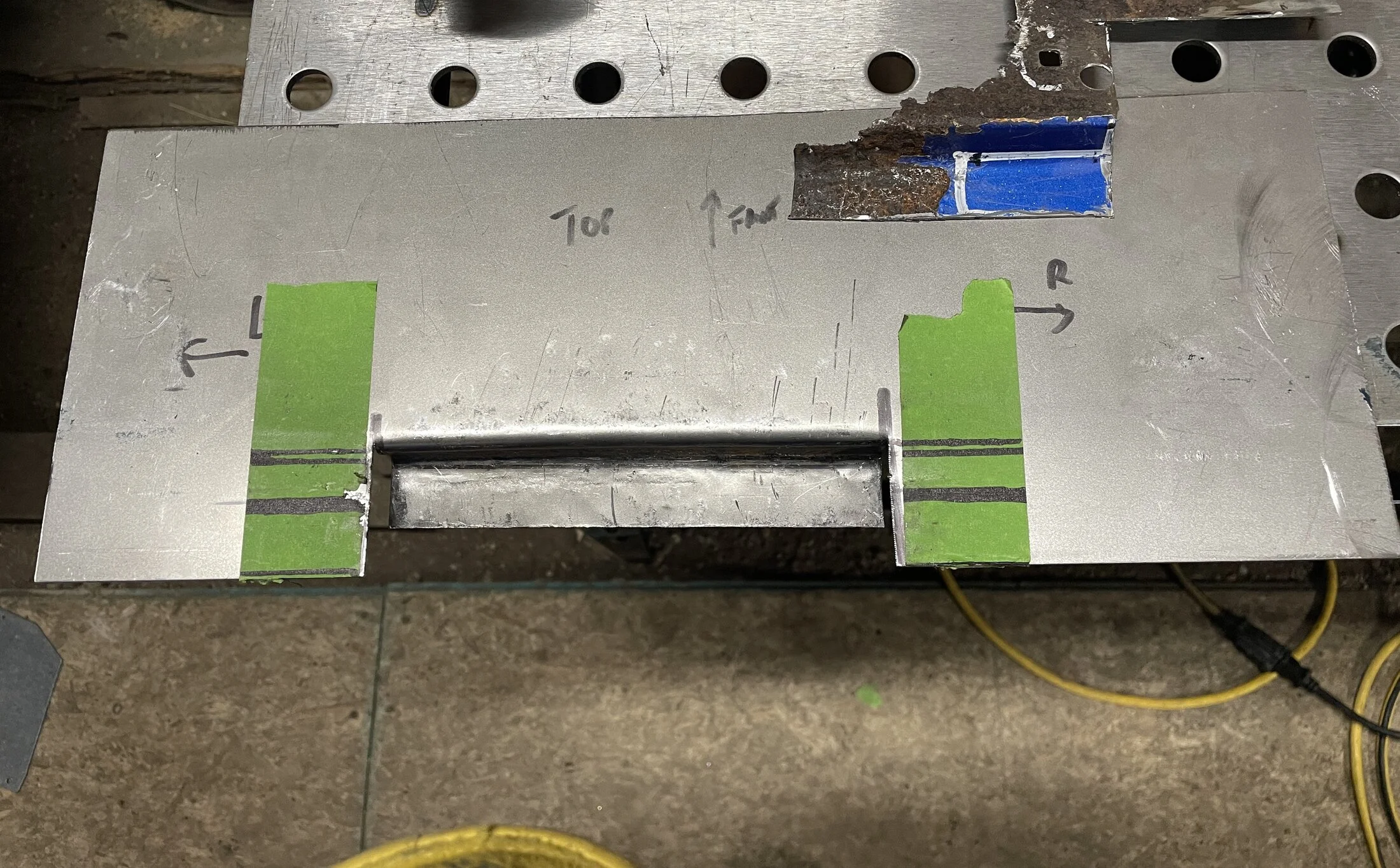

After some contemplation, I’m just going to weld in a flat panel where I’ve cut out the floor. I’m not going to bother trying to shape the three beads of the floor section. There is only about 4” so I’m not fussed.

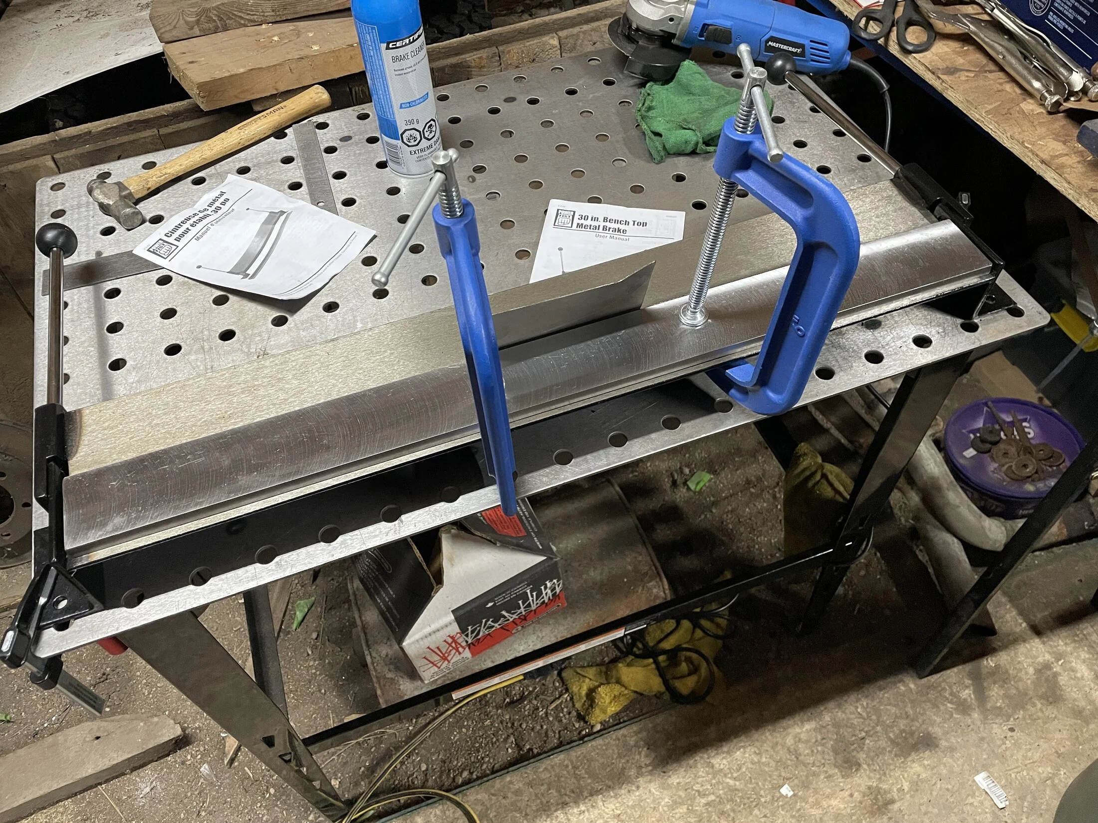

I used my new sheet metal brake to bend the one piece for the inside of the door lip.
Soooooooooooo much easier. $100CAD well spent. It took about 5 minutes, from out of the box, to set up, to the bent piece. 😃 I wish I bought it earlier for the other pieces that I hand bent. 😳
