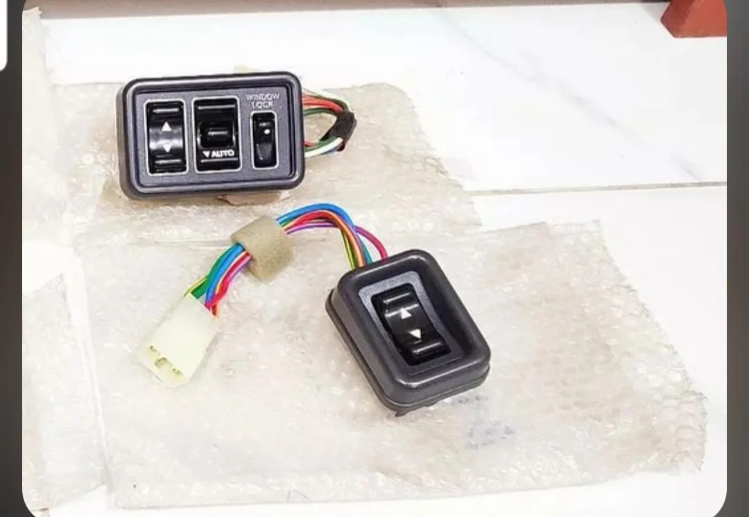

You have a much newer vehicle than I do. Mine is a 1988 B J 74. The switch is may or may not be different. This is what mine look like.

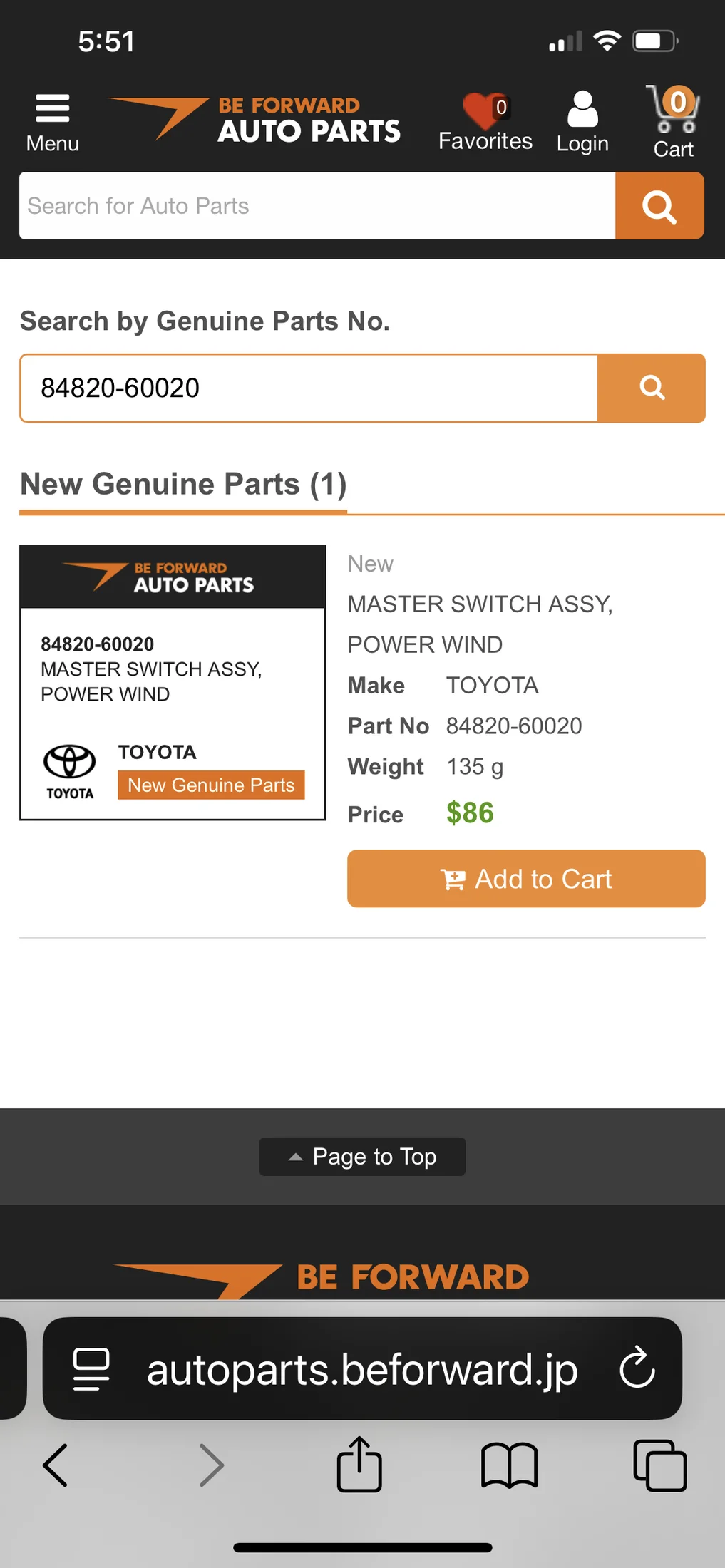

I came across this. Might be worth a shot.
It’s not available. It’s discontinued. We’ve already ascertained this.
Well at $86 I can guarantee it’s not a genuine Toyota part. It’s probably a Chinese knock off so it actually may exist if you took the time to check it out.
