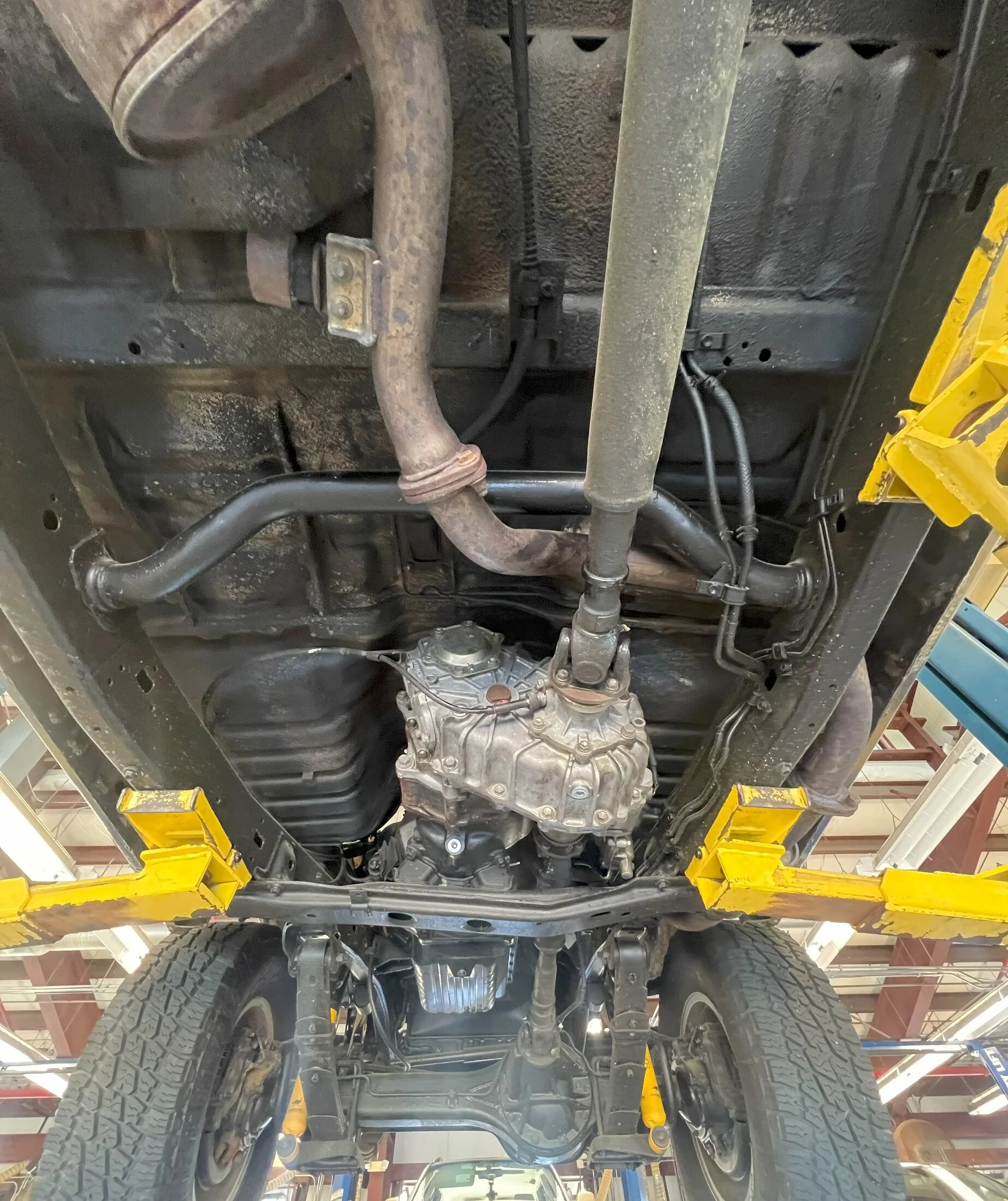

Got her on the lift today for:
Oil Change - AMSOIL signature series 15W-40 Synthetic Diesel Oil - filter (90915-30002), plug (90341-18021) <- thanks OGBeno, and gasket (90430-12031)
The newer 10mm allen bolts work great.

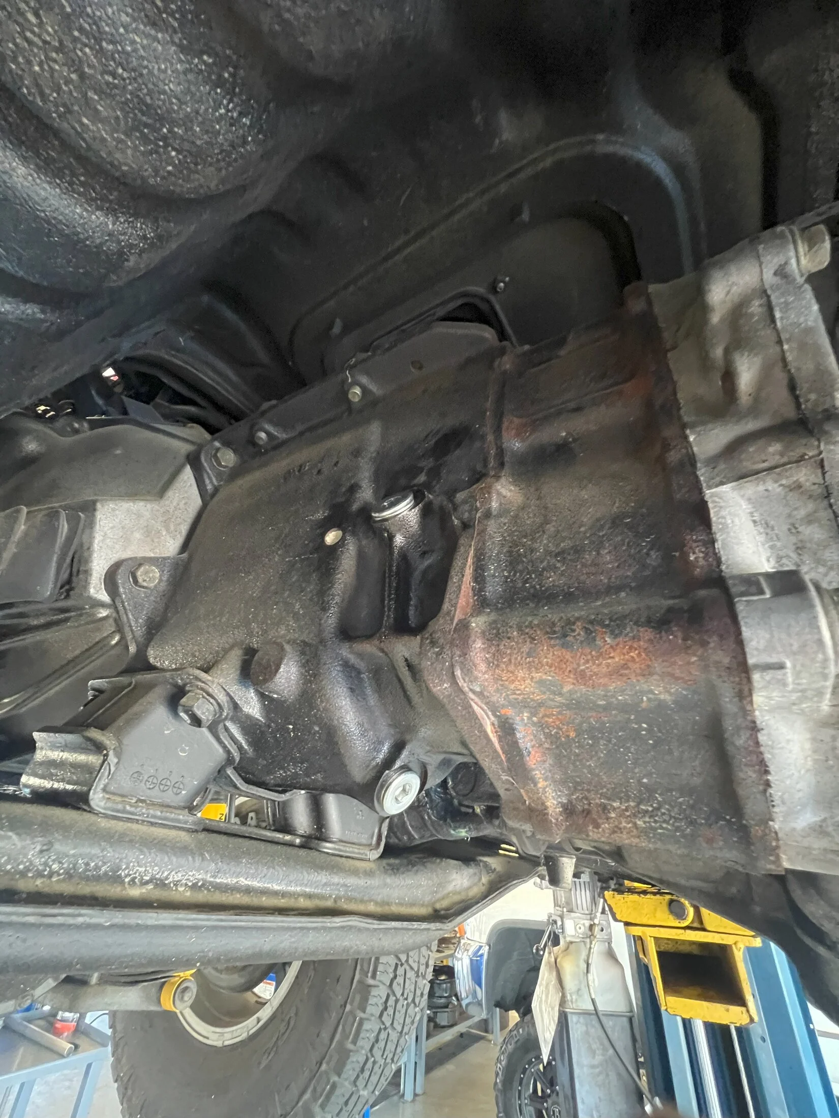

Transmission Oil change - (The severe gear instantly made the shifting smoother. It obviously needed the new forbidden jelly.)
Amsoil 75W-90, fill & drain plug (90341-18021), and gaskets (90430-18008 x2)
Transfer Case oil change -
New air filter - (17801-61930)
Greased Axel with Valvoline Lithium Grease - I noticed when I added grease to the Slide Yokes, the center section slid back, is this normal? I believe it was the cover moving. I could see grease coming out of the spiders just fine, but dont have experience on Slide Yokes.
Not every day you get a good look underneath, it had some coating applied at some point and overall it looked really good (at least from my eyes)

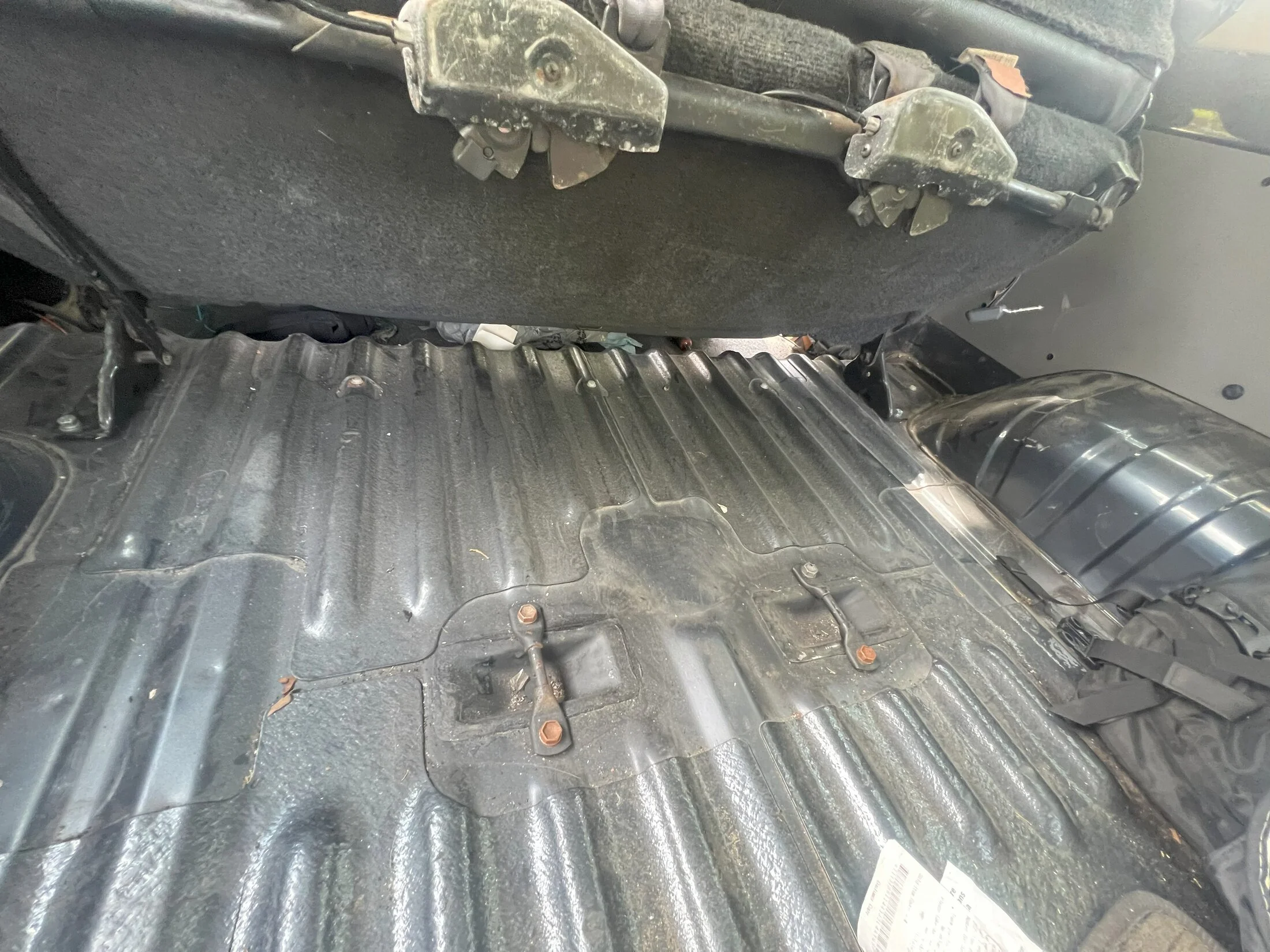

Also - I was able to snap a few pics of the rear seat too, it locks in and seems sturdy, so 💁‍♂️.

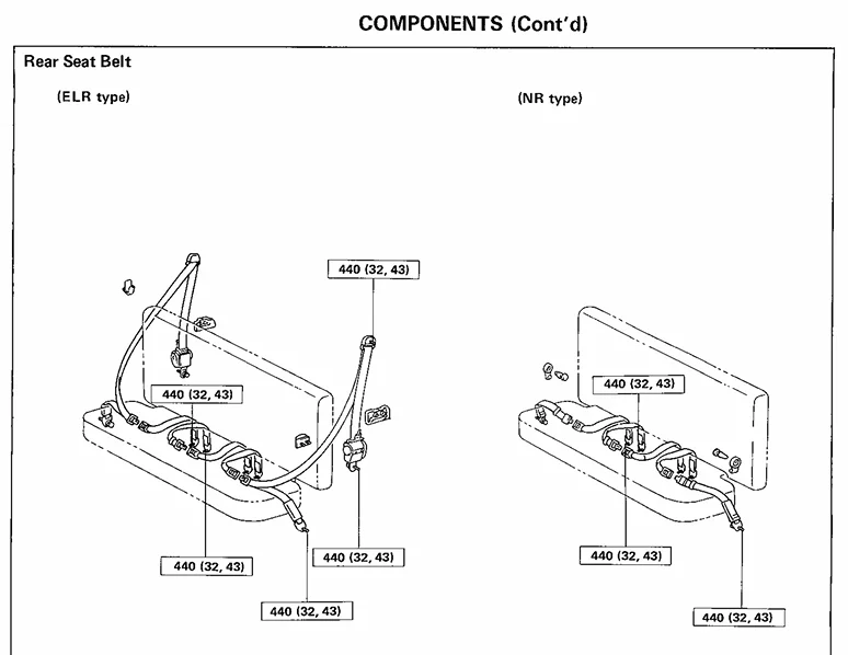

It seems odd they would go through all that work to install a back seat and only 1 of three seatbelts lol.

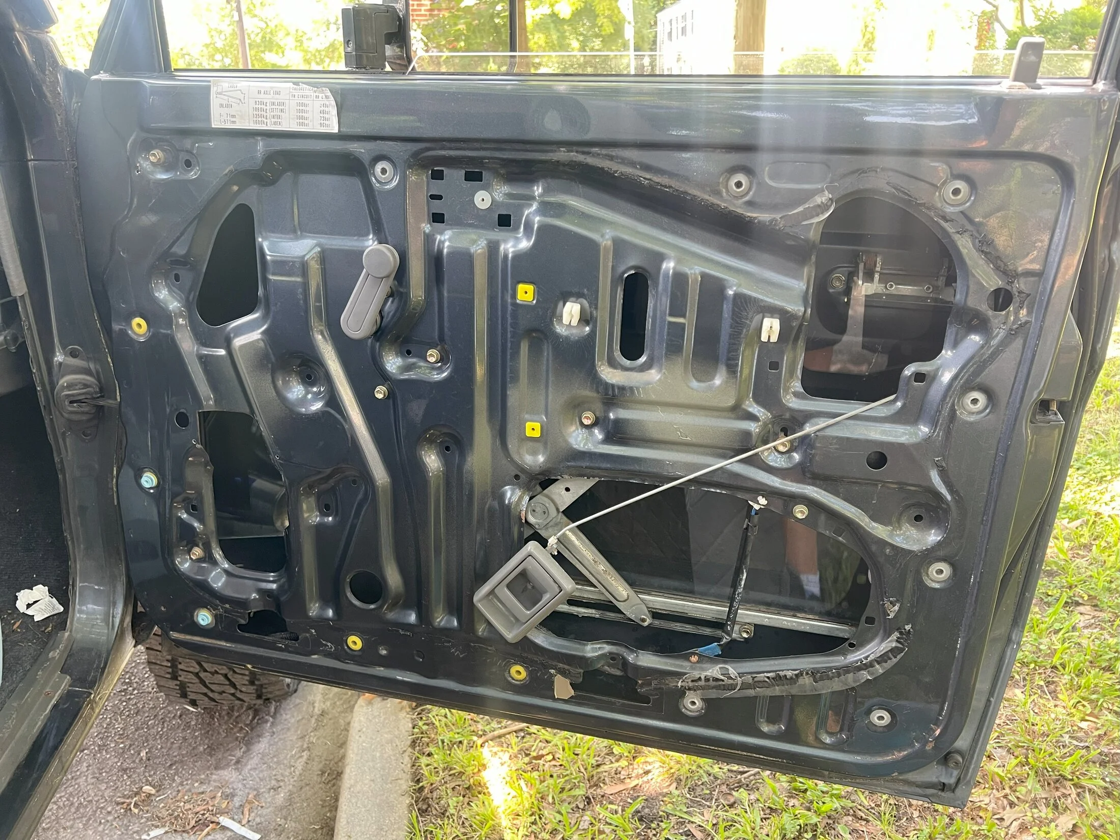

Got the doors off and cleaned them down followed by some silicone grease for the window rubber and lithium grease for the track pieces.
I tried my best to fix my power door locks. The button on the driver's side doesn't do anything, and I tested power at the relay (85980-60090) and it is getting 25V, and the relay board looks ok, but no idea. If anyone has any expertise here I'm all ears, or if someone knows where to source a new one/a different part that will work.

For the doors:
Put a piece of foam on that actuator rod to avoid rattle, and glue a plastic cover back in place to make them watertight.
You also may want to put some rust protection (e.g. fluidfilm) in.
Cheers Ralf

For the doors:
Cheers Ralf
I learn something new every day from this forum. I will go grab a bottle of fluidfilm today.....I went down the rabbit hole watching videos of people doing it to their entire cars.
I'll look around for the foam that will work, and where to source the plastic.

Hello,
Both the foam and the plastic are available from Toyota.
The plastic cover is 67831-60180 (RH side) and 67831-60090 (LH side.) The foam part number is 69759-30021.
The foam does not need adhesive to stay in place. However, and given that we are all anal when it comes to our Cruisers, a bit of double-sided adhesive tape will help to keep it in place.
You will need double sided adhesive tape for the plastic covers. They tend to go missing with POs.
There is provision for three seat belt buckles and one seat belt in the rear seat.

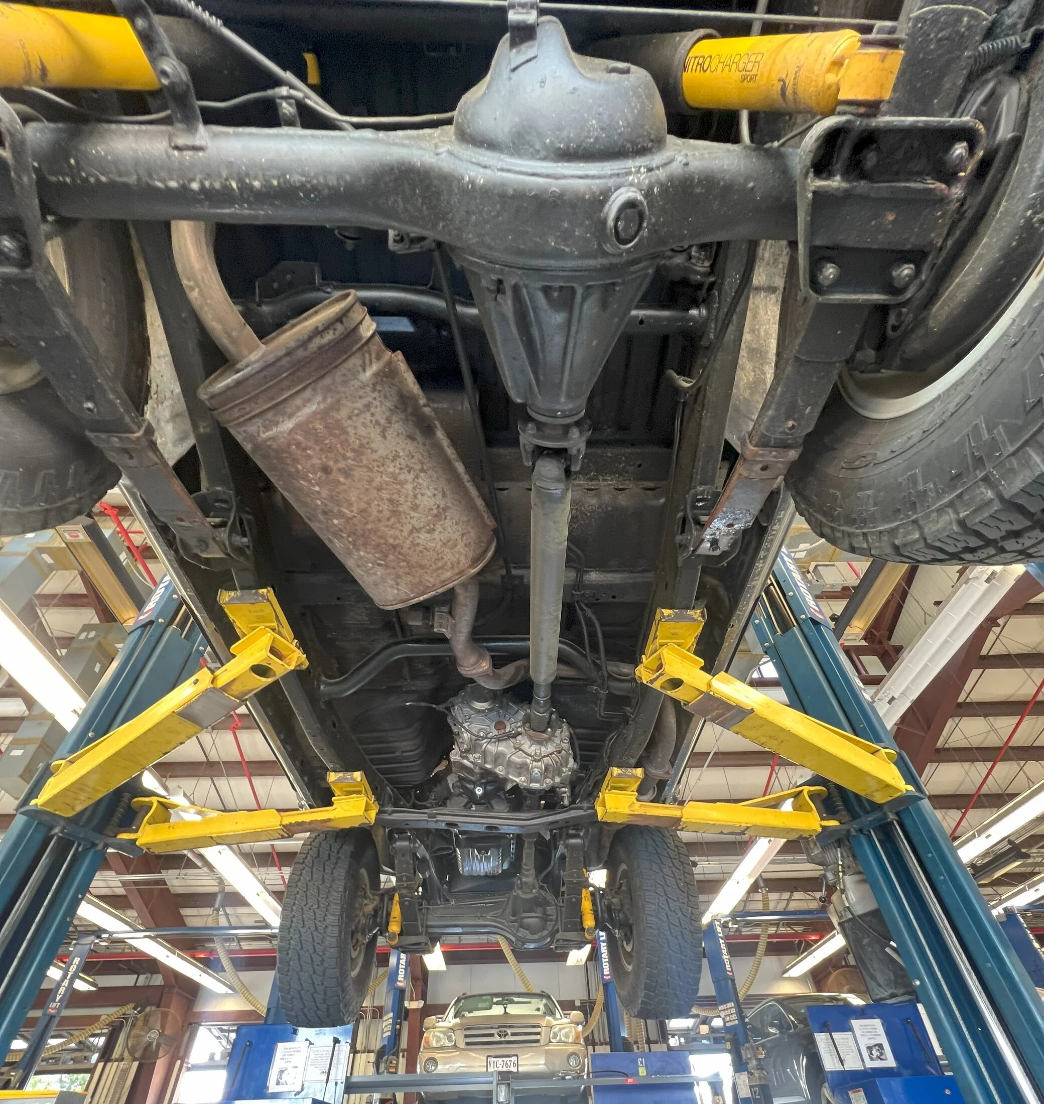

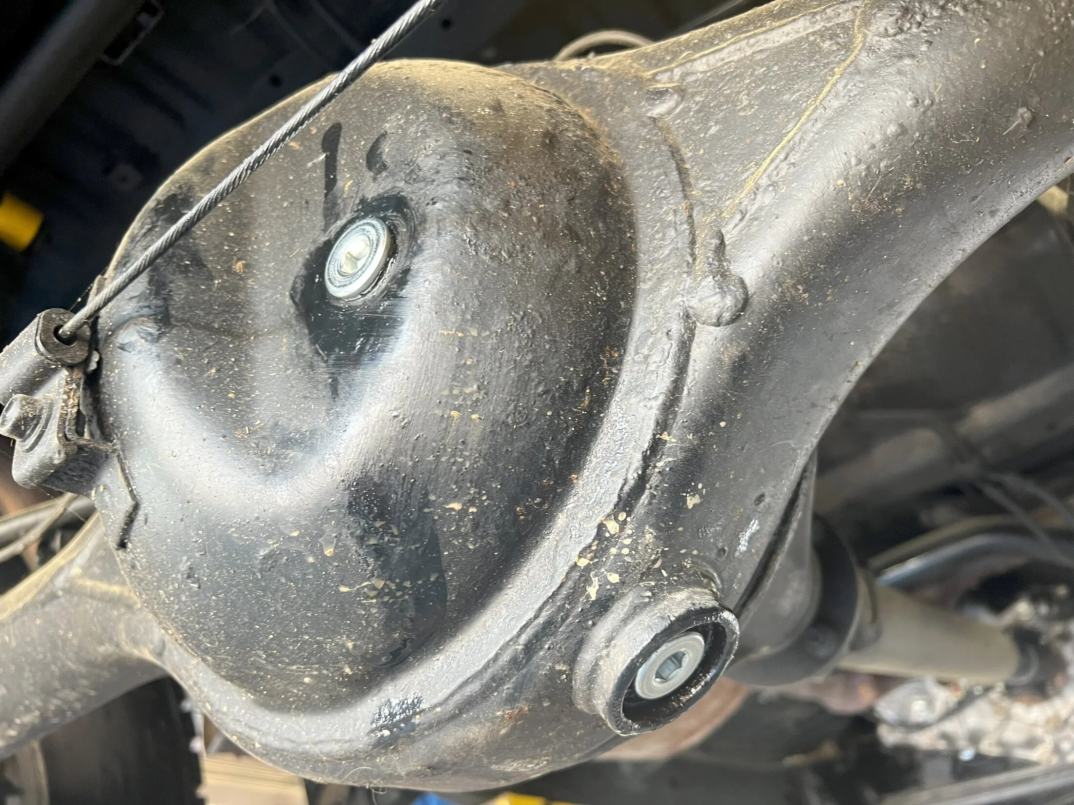

Drained and filled the front and rear diff (AMSOIL 75W-90). Replaced the fill and drip with the new 10mm bolts and crush washer.

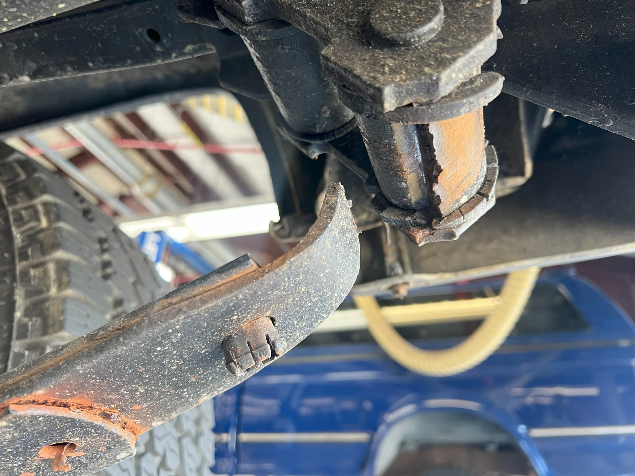

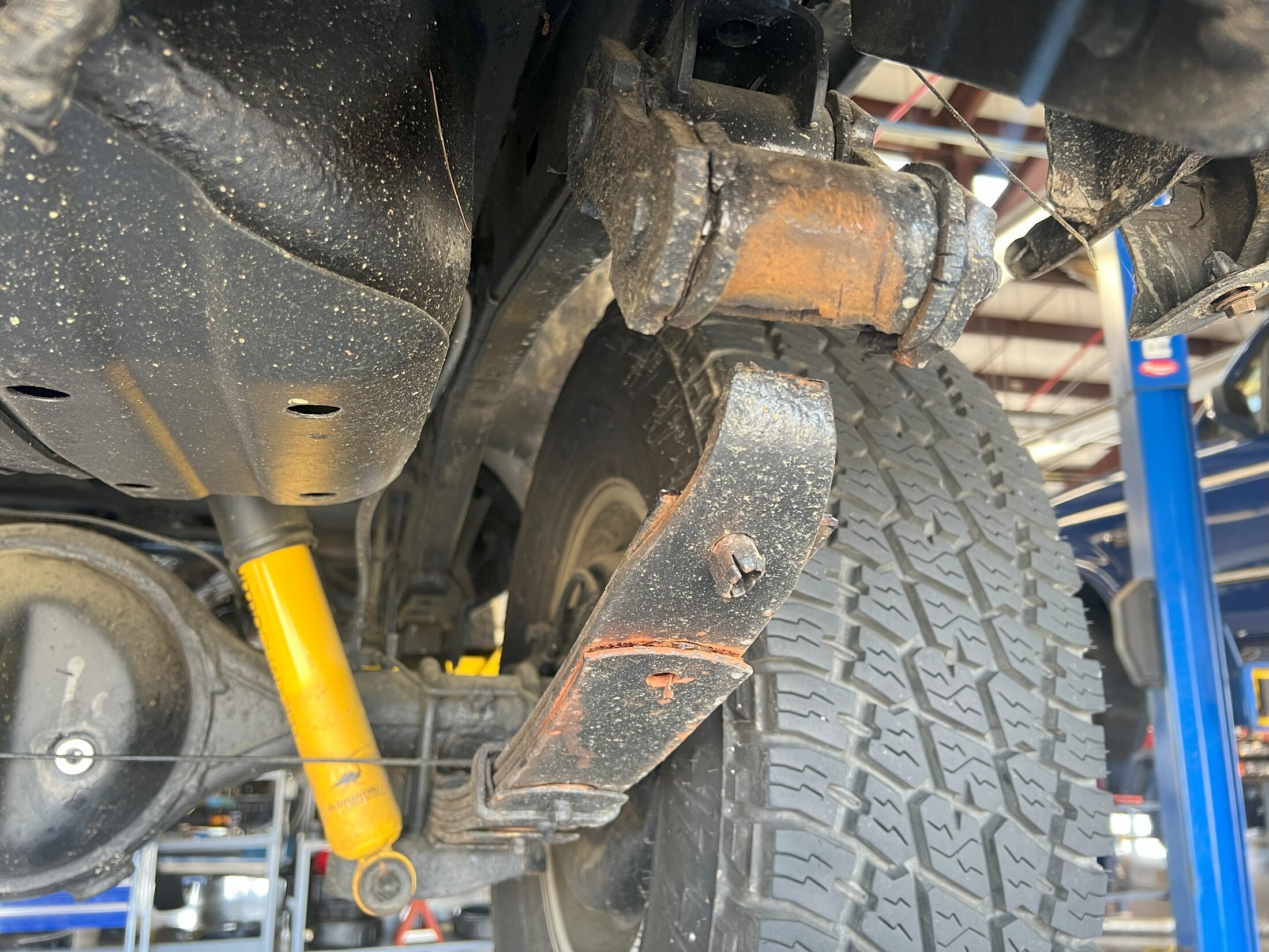

Unfortunately while up on the lift I discovered the right rear leaf spring broke. I can only surmise it was going to happen then the lift just took the weight and it snapped. 💁‍♂️
The rust kind of freaks me out, and I'm wondering if a previous owner painted over some potentially?
Anyways, I assume I at least HAVE TO replace the two rear leaf springs. The car has "new" OME Shock Absorbers" but now I'm way outside of my understanding here. I've seen kits like the ones on Cruiser Outfitters (Cruiser Outfitters - https://www.cruiseroutfitters.com/sus_70series_dakar.html) that feature a ton of stuff like the U bolts, bushing, greaseable shackles and pins.
So I guess I'm looking now for expertise in the matter. I assume I have the stock leaves and will/should replace all 4. Can I still use the OME absorbers or is this a full replacement?
View attachment 3938217View attachment 3938218

Can you move that rear shackle? The bushings look all cracked like it’s super tight. Possibly so tight it couldn’t move and snapped the leaf?
If it does move, then seems like those springs or at least that one is bad.
I would replace the whole suspension for peace of mind. I would look at parabolic suspension by terrain tamer, sold by valley hybrids here In The US. That’s what I would do if I were redoing my suspension.
Honestly the OME shocks are quite a bit rough compared to others. Would be worth it to do a full kit and then just sell the OME shocks.
A broken spring can happen to anyone anytime, as above work out your options whether you just replace the rear springs or do a full suspension upgrade, overall your truck looks pretty tidy underneath. I always like greaseable shackles and pins they make the bushes last a lot longer with some lube in them.

Thank you both! I'm now in the exploratory phase for the options available and plan to have a post to just get opinions.
