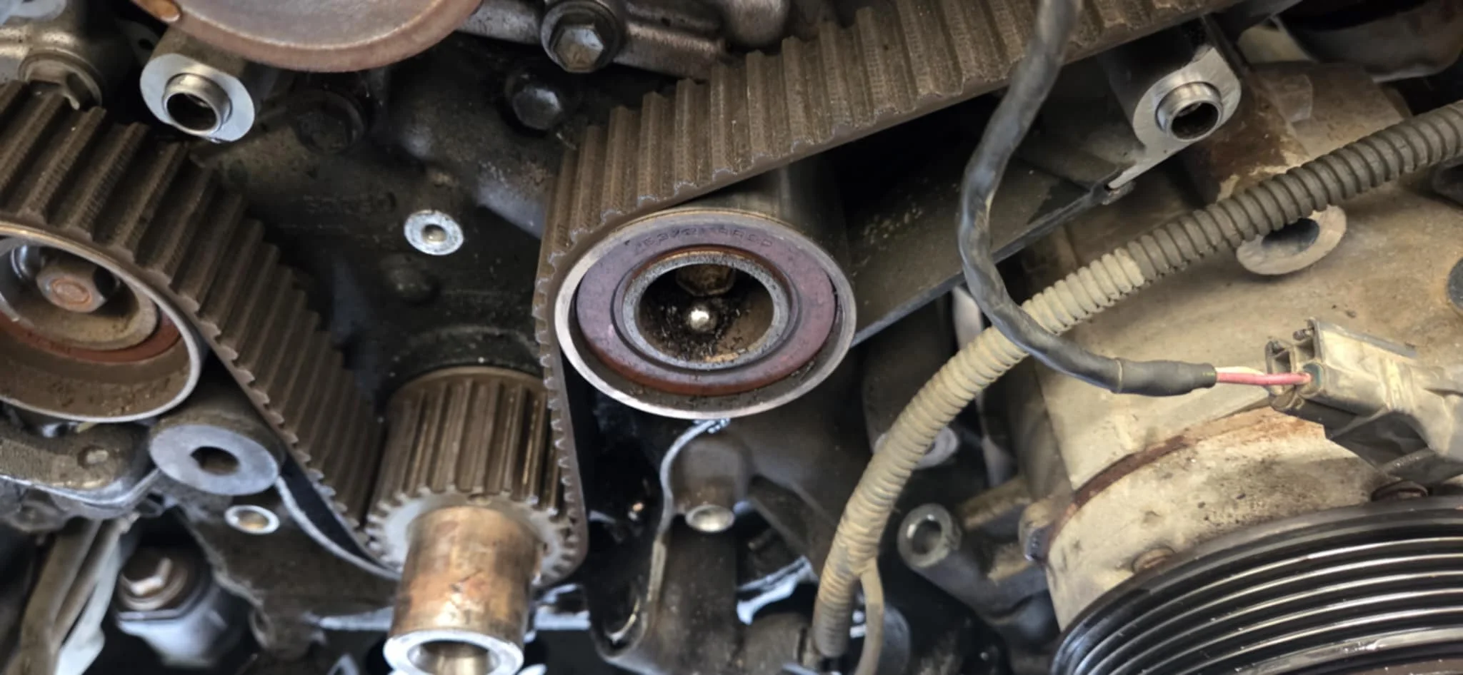

Recently, I purchased another 2UZ (GX) with 250,000 miles. The fan bearing failed and let steel bearings fly into the timing belt. This caused the belt to jump off.
No engine damage (e.g. bent valves) followed. A luck break of sorts.
The bearing failure caused damage to any pulley hooked to serpentine belt to the point of bending the alternator mounting bolts and sending the fan into the radiator.
Much destruction occurred on the wake of bearing failure. This could have been avoided with preventative maintenance when the timing belt was changed at approximately 235,000 miles.
I cringe when I think about how this could have been a lot worse on a VVTi engine. Now that our 100s are joining the Quarter Century Club, consider taking the next step with maintenance items and look for things that could leave you stranded or bring $1,000s in repairing to other damaged components.
UPDATED 7/16/25 - Fan bracket ball bearing resting inside the pulley. This was after the belt was repositioned post jump.

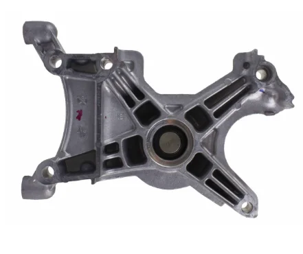

the fan bracket is what the fan clutch spins on, that is its only purpose, the fan bracket needs to be removed when doing the timing belt

Here's a back view of the bracket. The original bracket dumped ball bearings into the timing belt area causing the belt to jump.
Note this happened on a 2UZ that I purchased as a non-running vehicle. I changed the one on my LX a few years ago when it started to make noise.
