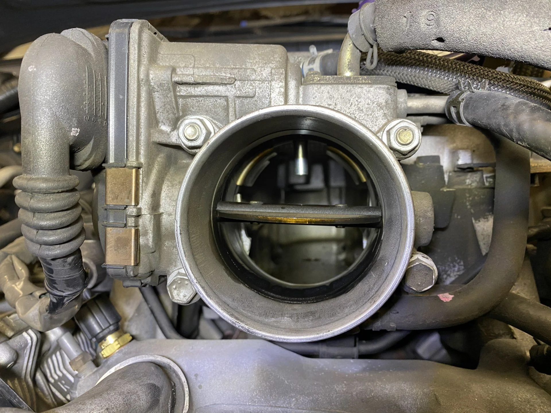

Throttle body wet and gunky behind butterfly. Looks like some gunk blowing "out" the front. Like is was clean just recently and this is flesh coming out, rather than in.

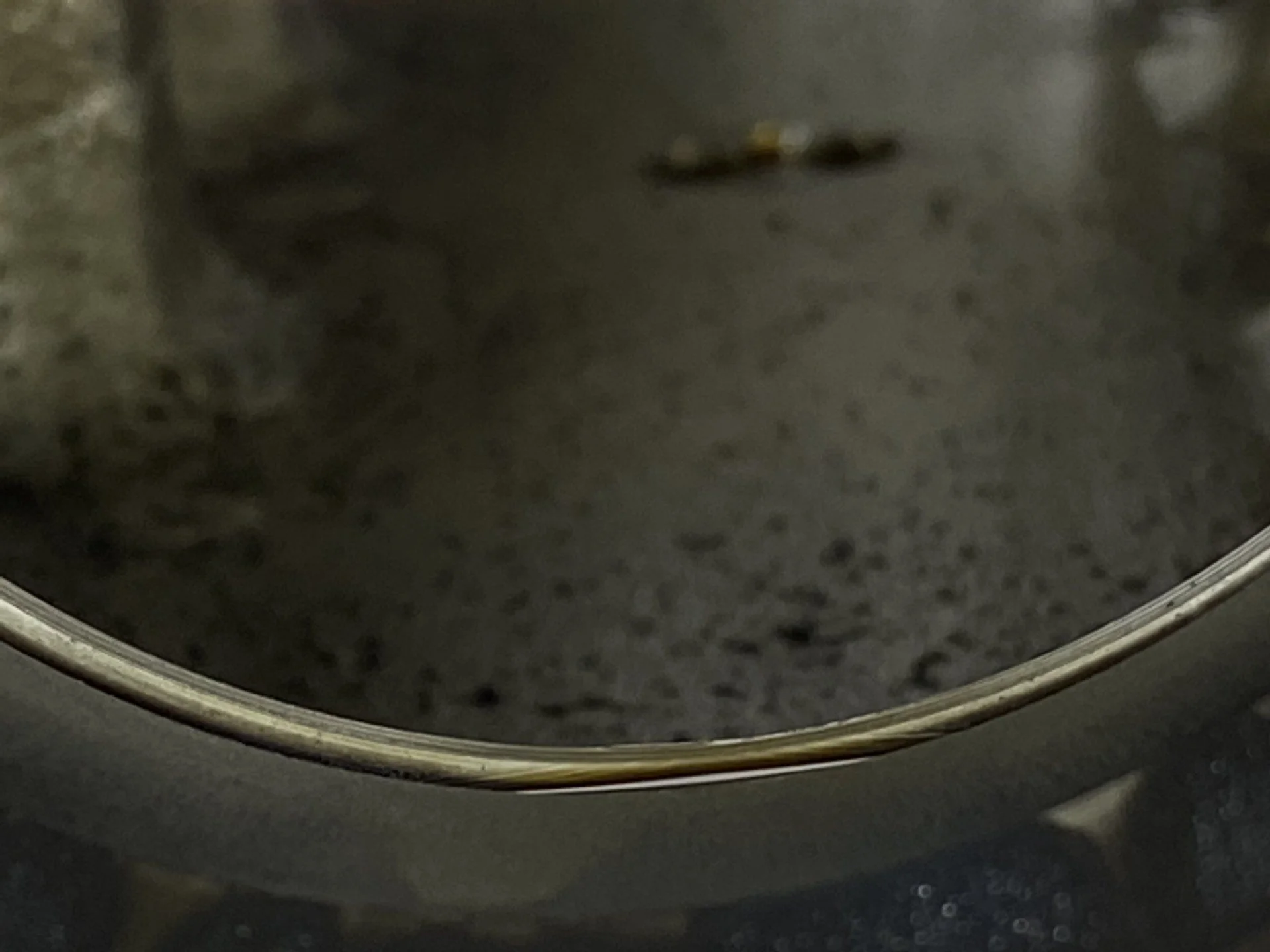

Floor of intake manifold had what looked like fresh specs/splashes of wet carbon.

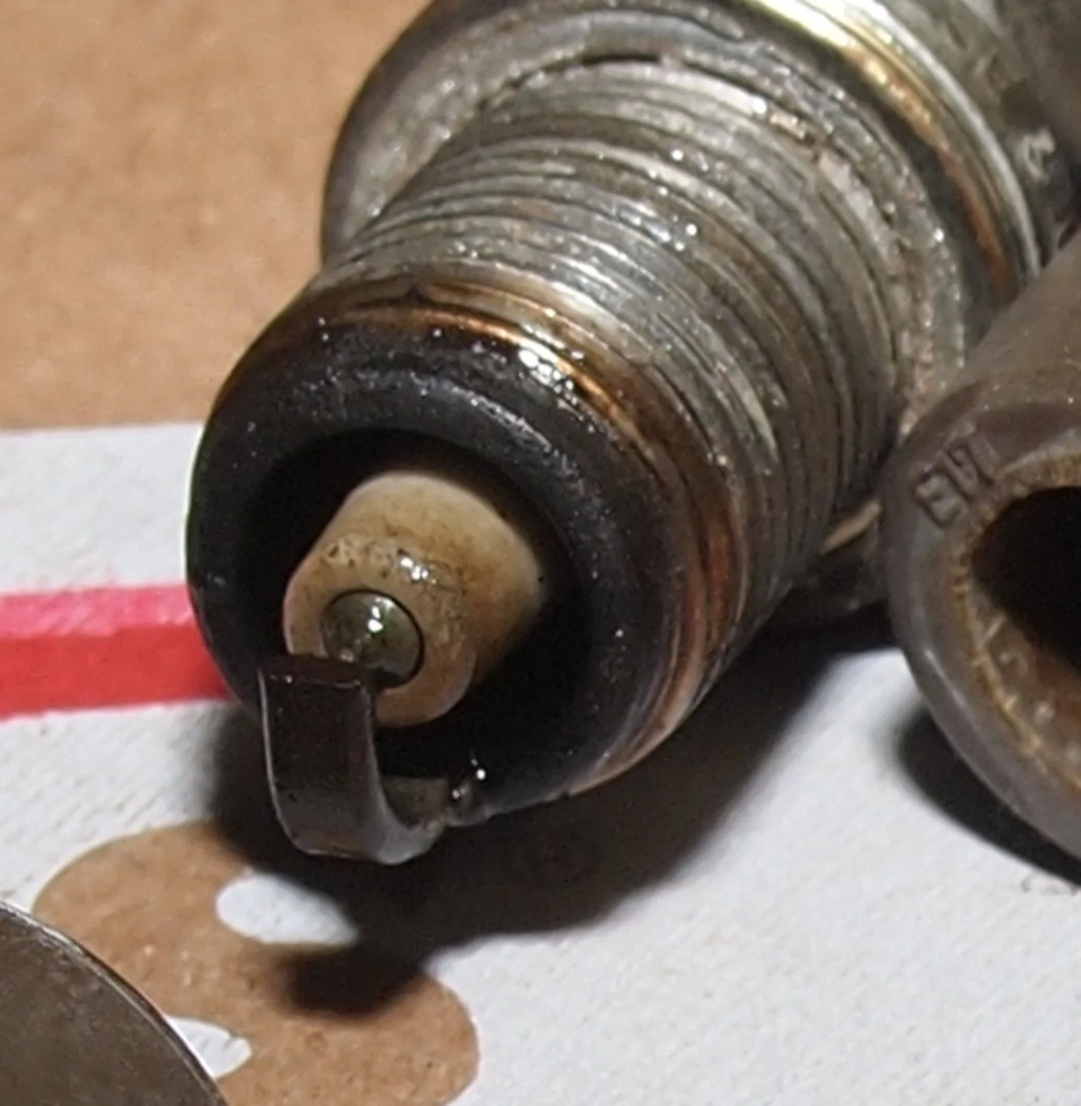

Spark plugs all 8 wet and glazed. Some to clean only #1 had some old carbon cake/build-up remaining on ground electrode.

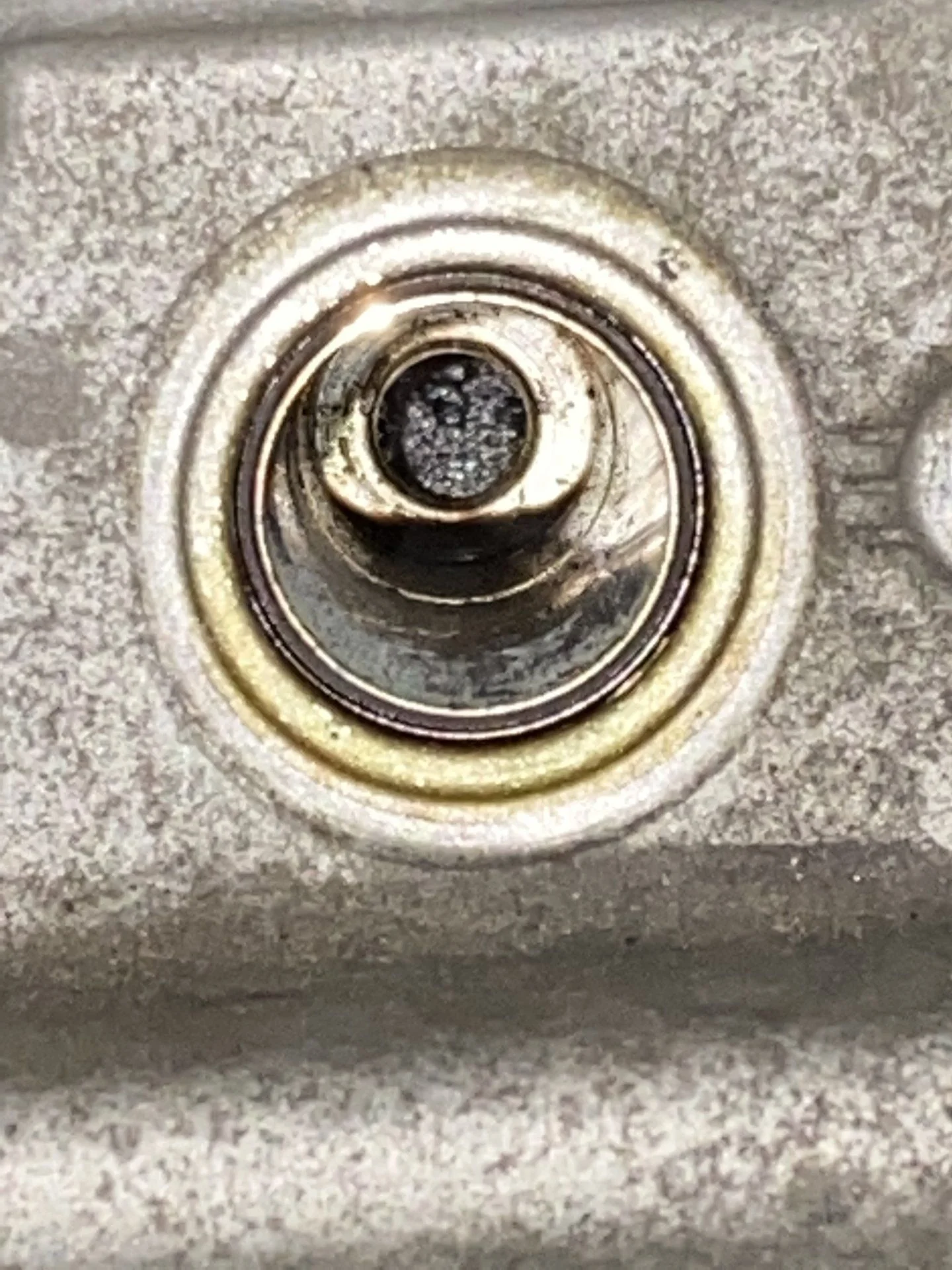

Puddle in #2 spark plug tube after plug pulled. Subsequent evaporated over night.

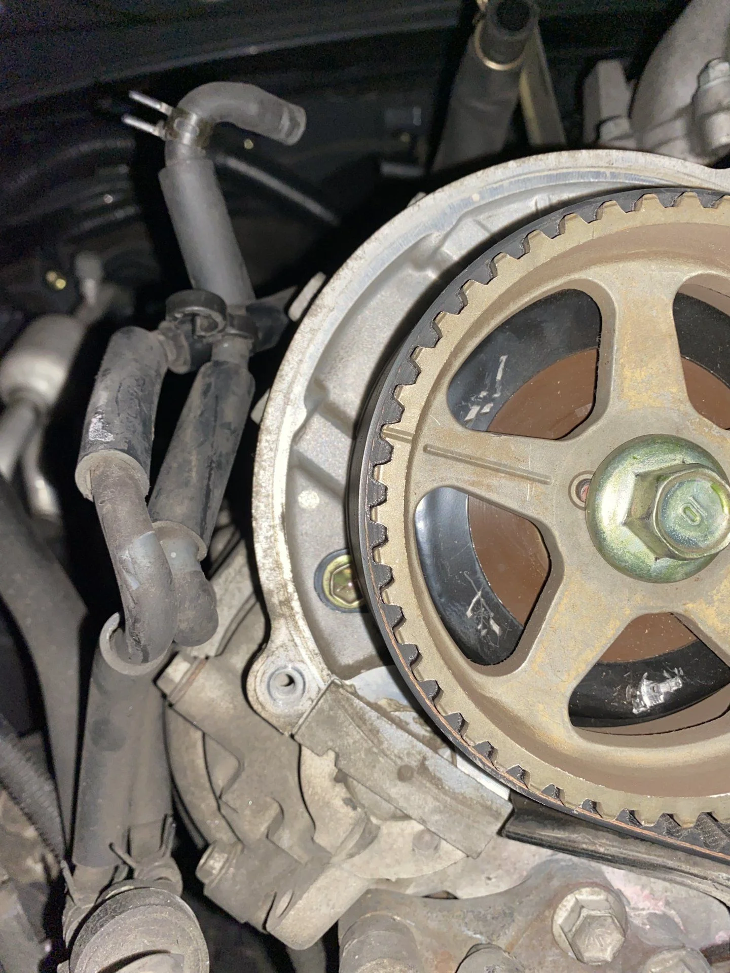

Pictures of timing marks.
Her's crank (harmonic balance) dead on mark at zero on plastic timing cover.
Hers is cam just a hair before mark, with above crank mark at zero.?
Here I was turning crank until cam came up to top dead center. Now crank 3 degrees pass zero (below
Seems moving one tooth on cam is not going to get these marks line up prefect. One tooth on crank may. But one tooth does not explain no more than ~10 PSI compression in BK 2 and 150 PSI BK 1.

Tooling marks from cam removal. Also knock pin looks okay and in place.

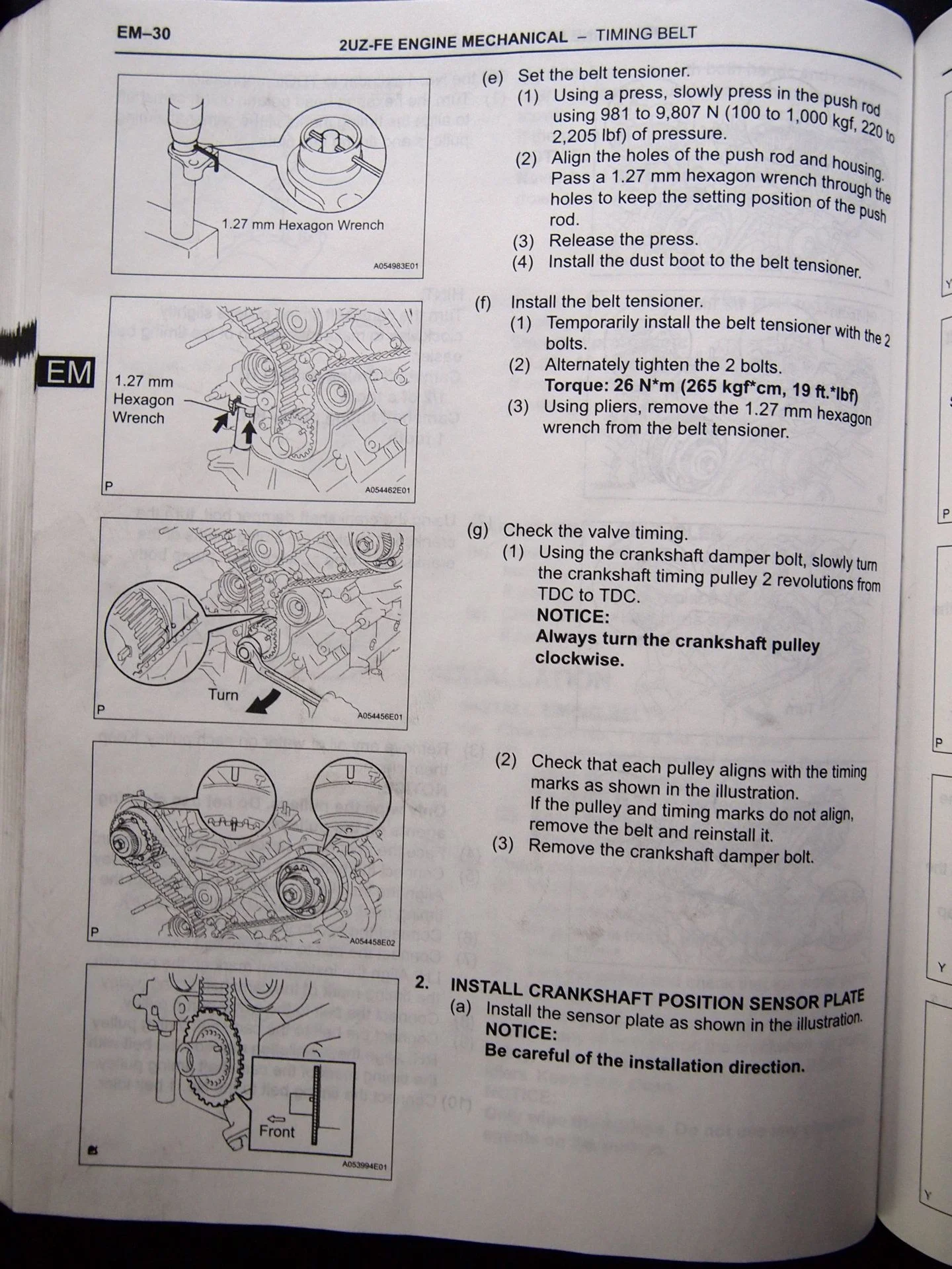

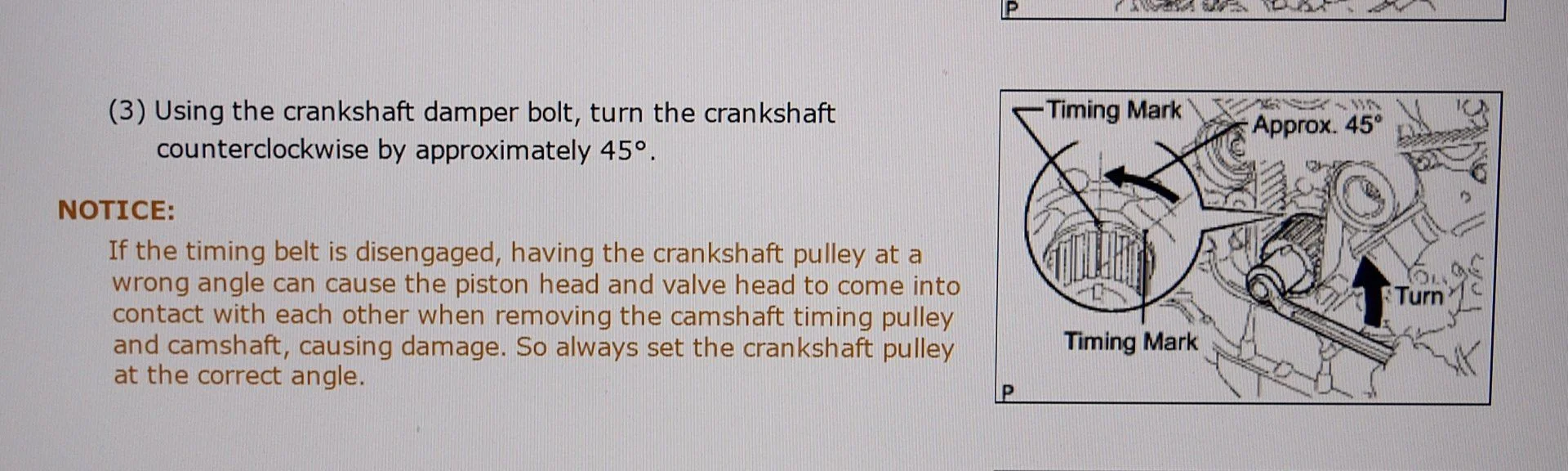

I got the instinct impression he only saw one mark on crank.
Stock photo of how it should be.
Is that the picture of the crank on this vehicle or on another that you've done?
The above image is set correctly.
Yes! Not this job. Sorry I did not clearly identify that as stock photo from old job I did.
The mechanic that did the job in question, mentioned only one mark on crank/belt. I posted up illustration and photo to show we've more than one mark in relation to crankshaft timing.
