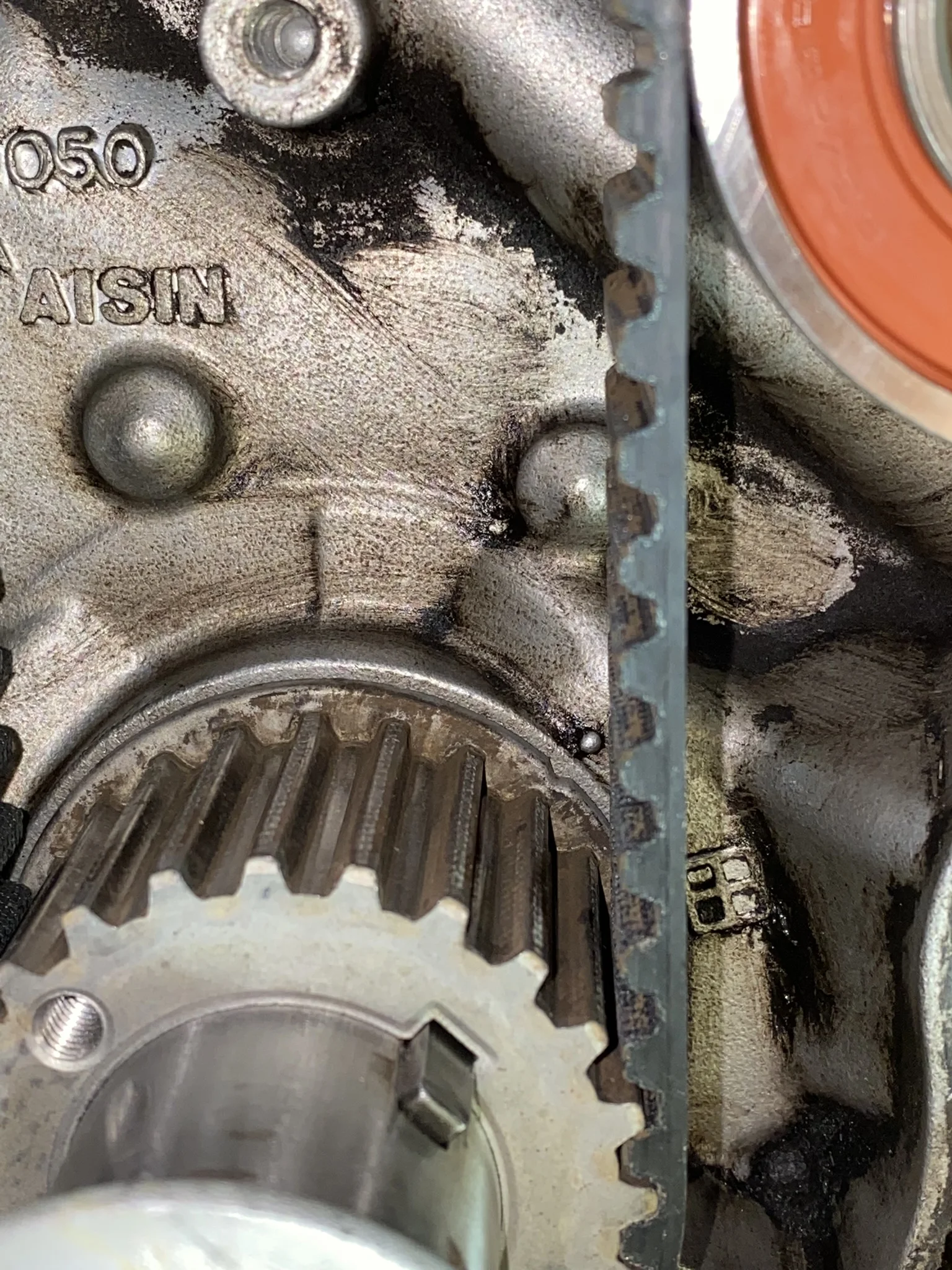

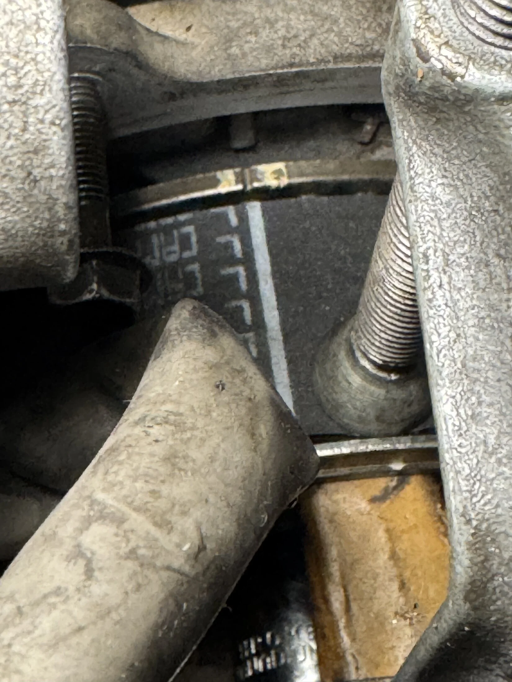

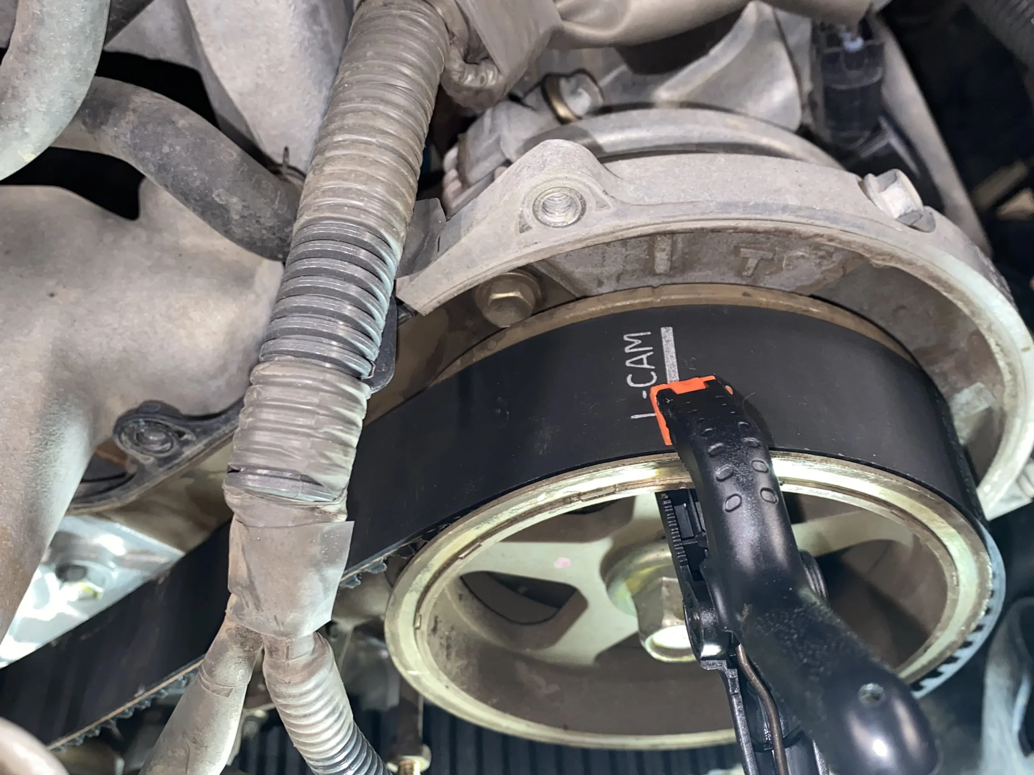

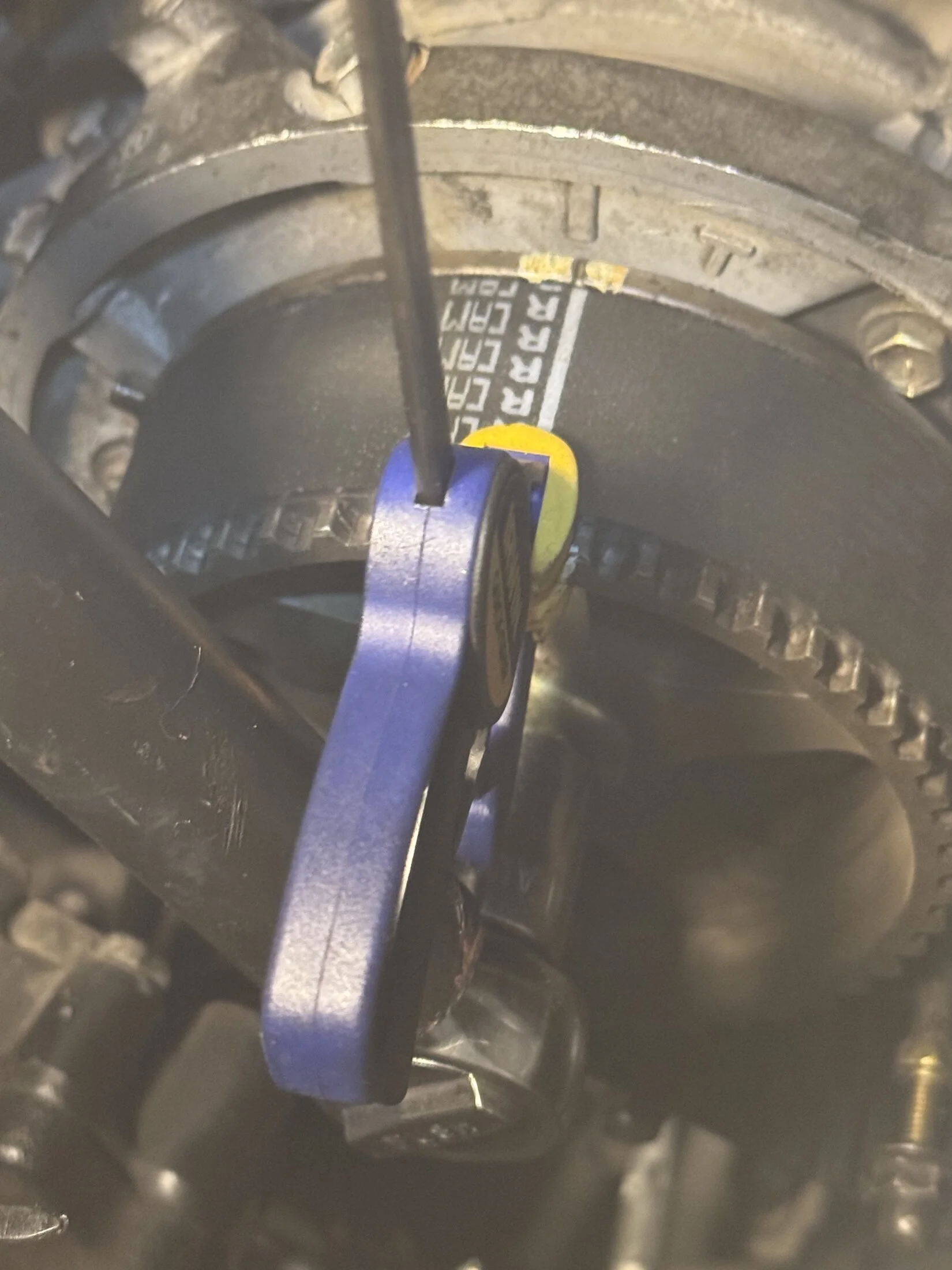

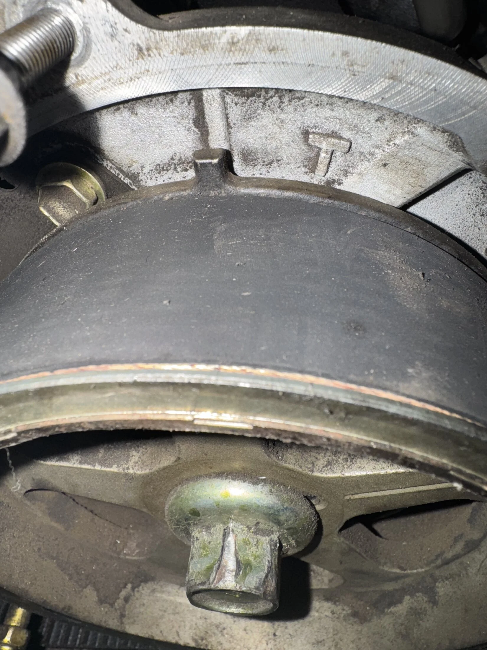

@2001LC and @Teddy, thanks guys! I think I figured out the problem…

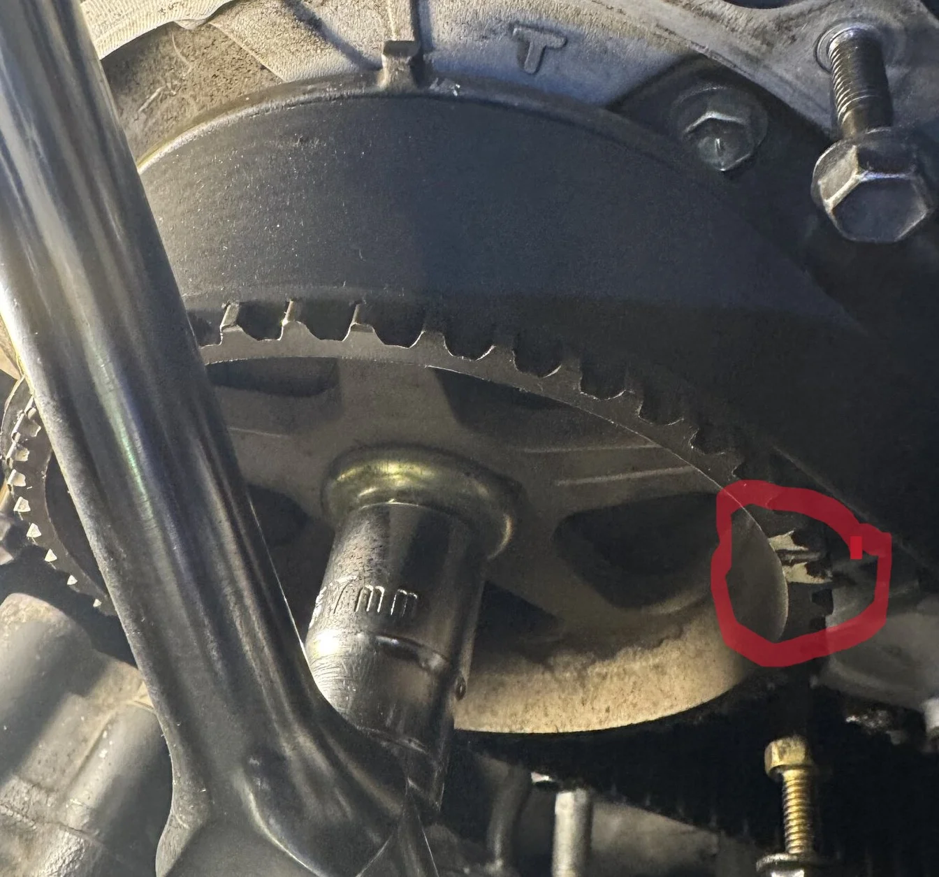

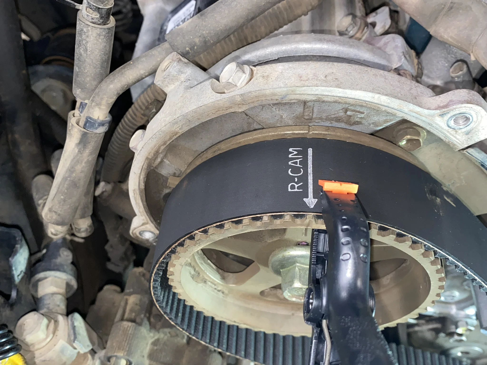

Here are the pics as requested. I am pretty sure I used the wrong marks on the cams😩
The worst part is, I’ve done this before😅 it has been about six years but believe I did the same thing last time as well😂
If you look at the images, I used the solid bar as the timing mark and not the notch. I got it taken back apart last night and will try again using the notches this time and let you all know how it goes👍
You did.
Looks like it's over where I circled in red:
I asked you: "Which is LEFT CAM? Many are confused by markings LH & RH on belt."
This is important, when installing a new belt. RH is your right when sitting in driver set.
RH is BK2. LH is BK1

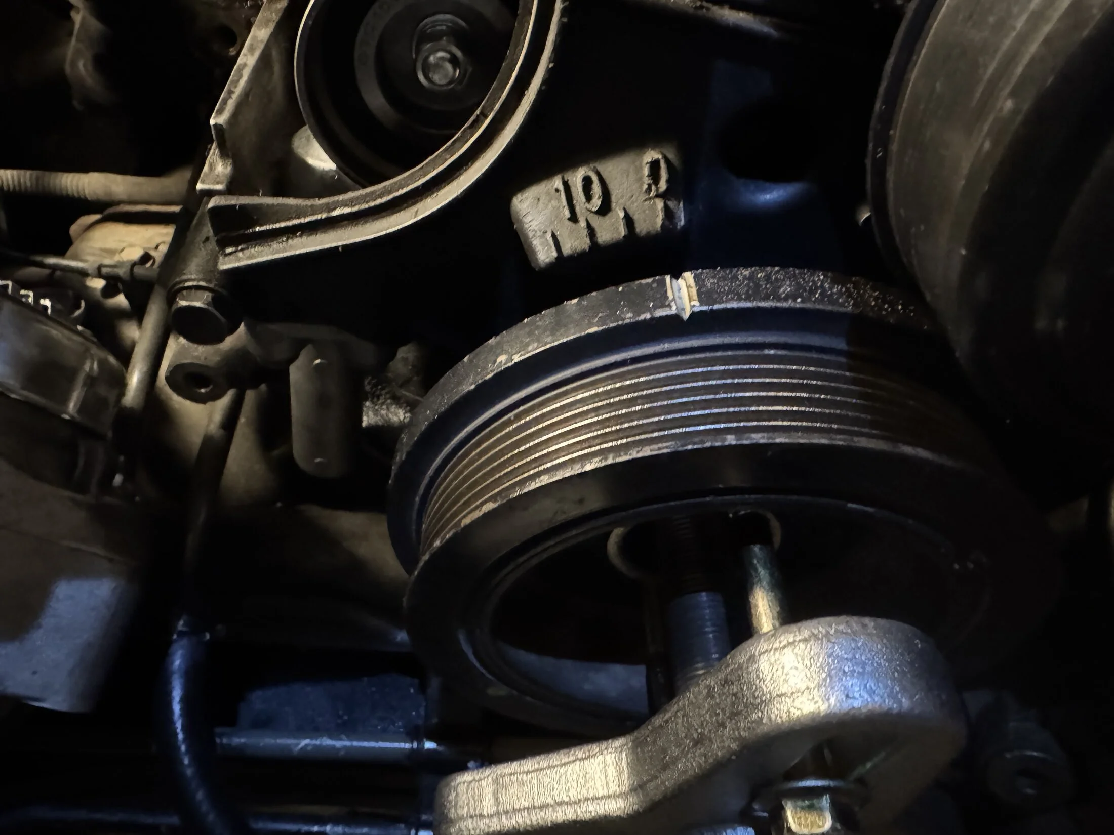

You should turn the crank bolt CW, not the cam bolt.
I use the hard marks on crank sprocket/oil pump.
