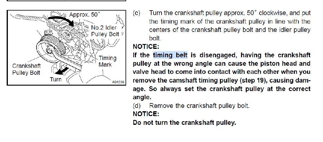

Turned the crank 360. Maybe I got lucky, just wanted to add my data point.
Did you have cam timing marks point on I or T?
From Service Manual Model Year 2000.
Seems to indicate "Interference Motor"

I removed interference from the opening post and make a reference to VVTi

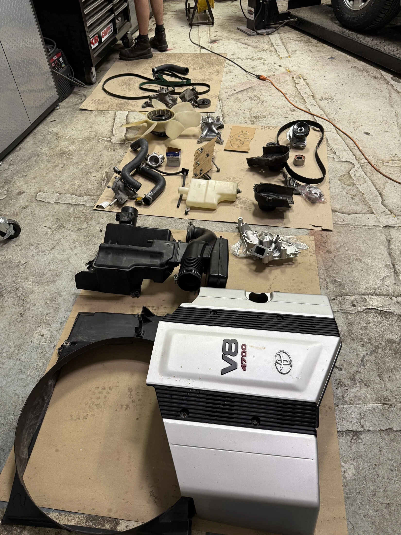

I just did my Timing Belt Change on 2006 LX470 at 334,000 miles. Replaced the fan bracket, bearing definitely felt worn. Also light squeal after startup that lasted about 1 min. went away. I used this bracket from Amazon:
https://www.amazon.com/dp/B0031GCUEY?psc=1&ref=ppx_pop_dt_b_product_details
Casting marks match the original so I believe it is a genuine replacement part.
Thanks for all the great advice in this forum. not sure I would have takled the job without it!

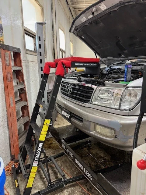

The topside creeper saved me last summer when replacing the starter.
I was reading the shop manual and saw where the starter was located and thought WTF? Then I figured it was to keep it out of the water. And it is re-buildable. The more I learn about these rigs the more I like them.
In my case, a starter every 325,000 miles with the number of creeks that ford, the design is worth it.
