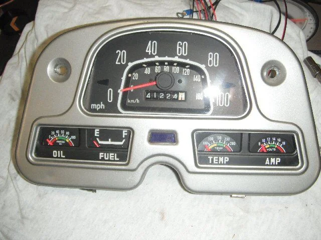

Continuing the cluster mod
1. Repainted the fuel gauge needle and added orange to the new ones to match.

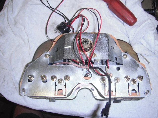

2. Gauge mask painted and LED's installed, EL wire installed.
3. Instructions didn't address the 2 tabs on top of the speedo. Must be a speed sensor feed for something I don't have anymore. 2 screws fortunately set it free.
4. Final install back view.
5. Finished! :grinpimp: Slick!

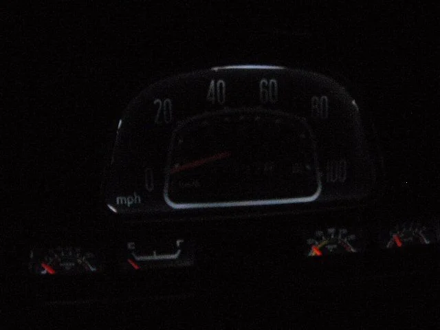

Best pic I can get in the dark of the new lighting. Not as bright as I was expecting, which is a good thing :) I had done the light shield mod in the past and was happy with that. This is nice warmer light.
The kit is pretty easy to follow and complete. I Wish there were labels on the LED's and more help on how to hook up the wiring. But the MUD data banks quickly got me pointed the right way.

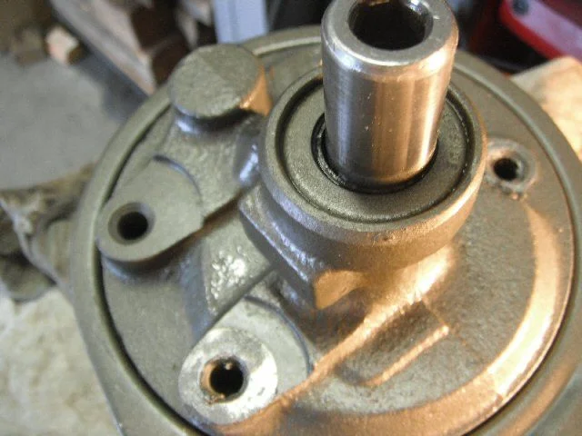

The bad: While running the engine up to temp, the fresh rebuilt PS pump sprung a leak on the shaft :bang: Not looking forward to removing it with everything in the way now :mad:
I'm stumped:confused:
How in the world does this happen? :hhmm:
Pull it apart, they are simple. Is the seal driven crooked or the bushing bad or... If the hard parts are good, the seal kit is only ~$10. :meh:
If it wasn't fresh from the rebuilder bench I would do that. They said bring it in and they'll take care of it if no abuse is apparent. We shall see. Still weird looking. The shaft seems smooth and tight. Seal looks square, just the centers don't line up.

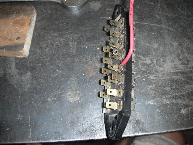

On hold for now with the PS pump, so back to lingering elect issues. Looking for better locations to tap into existing circuits I discovered that the stock fuse panel already has taps in back for always hot and switched on. :bounce:
Still needing an accessory tap I soldered a wire to the back of the fuse holder for that circuit.

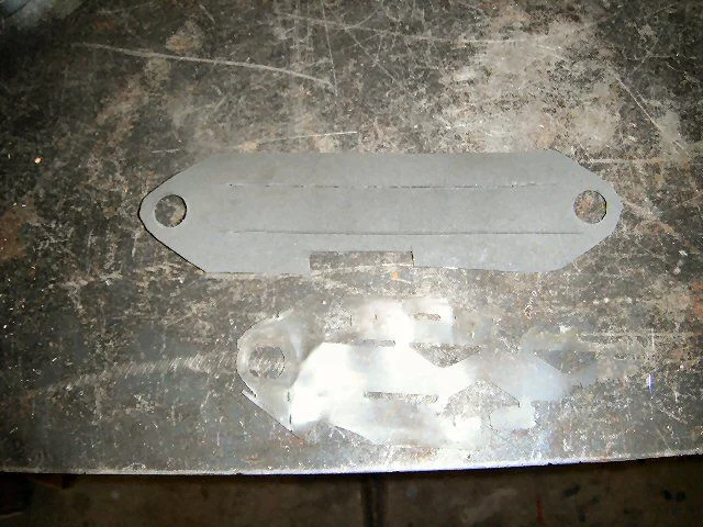

Also made a replacement for the disintegrated fuse panel shield out of some gasket material.
