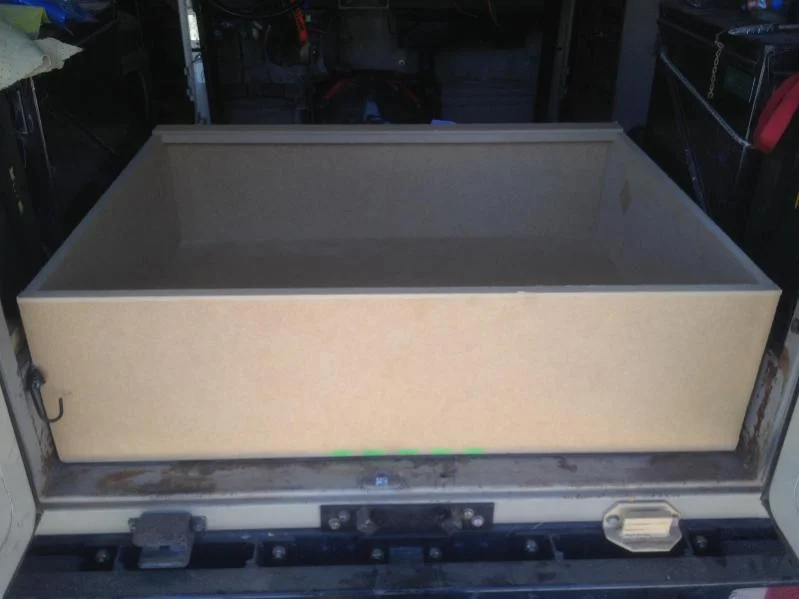

You can hear music over the sweet music of the V8? I wasn't going to bother installing a stereo because my 40 just seems too loud to make it worthwhile. Maybe it's the years I spent in (terrible) metal bands... but I don't think my ears are good enough to hear music over the 283...
I'm still trudging through your build so forgive me if you covered this somewhere, but where/how do you have the speakers mounted?
Sure, all you need are watts! And somewhere back on page 22 is this:
attachment.php
I'm planning to put a pair of 6x9s and an amp in a compartment in the front of this box.
Being a musician in a rock cover band for 30 years myself, I've probably lost a little hearing too. But not enough to give up on tunes in the ride.:D
