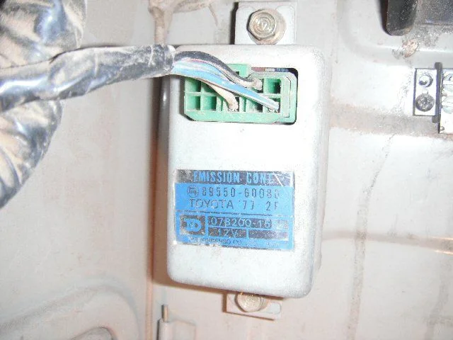

What did this box used to do? Not the igniter is it?

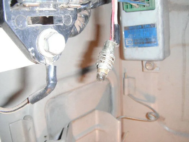

And, found this curious little light wrapped in tape and tucked up out of the way.
With your setup, it's a useless relic, remove or abandon in place.
That much I know. It's been doing nothing for a very long time. I'm just curious as to what it hasn't been doing
IIRC, counted miles and/or time, turned on the EGR light when it thought it should be serviced, useless stuff like that?
my guess is the speed sensor, or it could be the emissions "computer"

why do we need to guess when we can read the label :confused:
well, at least I can :flipoff2: granted, with reading glasses :doh:

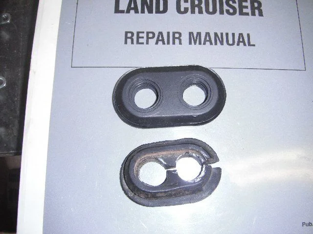

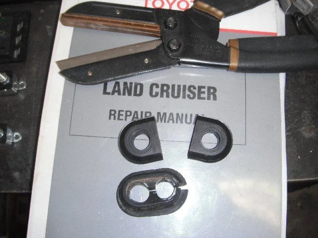

A long nagging little issue with an acceptable solution:
The grommet for the fuel lines to pass through the tub from the tank is apparently made of nonobtanium. I noticed that the grommet for the heater lines in the firewall was similar, but larger, yet available.
:idea:
So I bought a firewall grommet from Cruiser Corps and performed the surgery depicted in the following pics. Coulda done some more square chops though.

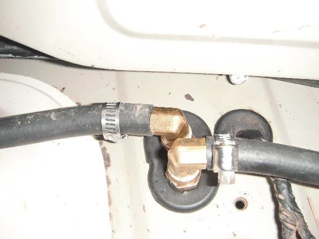

Modified grommet installed with my home brew fuel pipes. Took a little shoving with a screwdriver on the edges, but it squeezed in place.
Not perfect, but better that the old crispy one it replaced.
:hillbilly::hillbilly::hillbilly:

The light pictured is way to big for the light switch. That light is a fraction the size of the one pictured.
:confused: So maybe it's a PO mod? I might take the switch out to see it's altered or has it's own light.

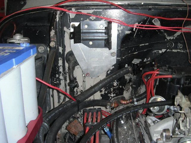

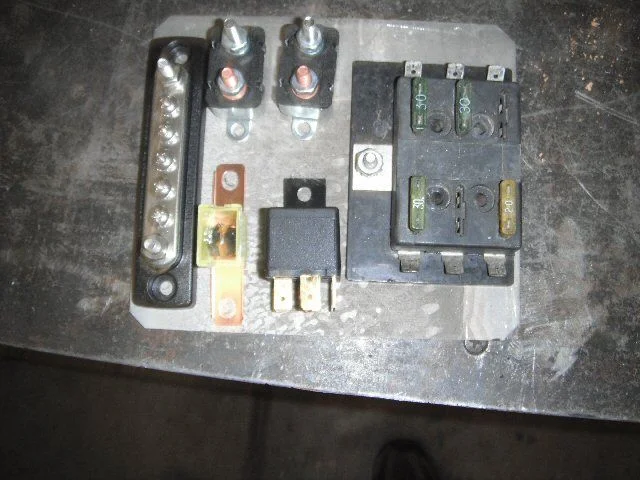

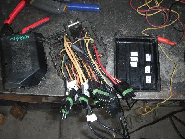

Meanwhile, I started down a futile road trying to build up some sort of power distribution for the engine compartment.

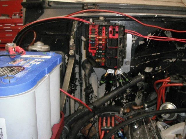

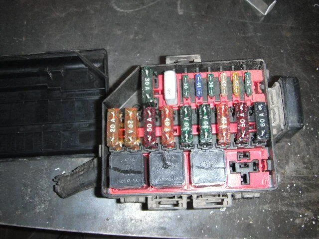

Came to my senses and realized the auto industry has been doing this pretty well for awhile. So I spent a couple hours browsing the local PnP. Dug up a nice compact distribution box from an 89 Cougar. Way more circuits than needed, but better than not enough.
Built a mount plate for the fuse box and mounted on some standoffs in an vacant firewall area.
Wired and rewired all the circuits with weather pack connections. Ended up leaving a few unterminated waiting for the future need because the whole bundle of connectors was pretty bulky.
Final install on the OE bracket waiting for wires. :hillbilly:
So the mystery light is solved. I found a place to put it in the light switch, and with a new bulb the knob lights up now. Although very dimly. An upgrade I never knew I had:D No telling why the PO wrapped it in tape.

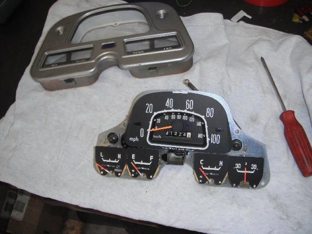

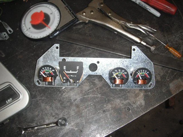

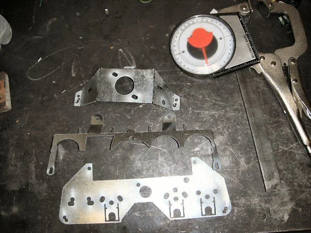

I've finally managed to slay 99% of the wiring serpents of Medusa and Hydra heads and it's time to get started on converting the stock gauge cluster to after market gauges with the kit I found here:
https://forum.ih8mud.com/40-55-seri...ven-mechanical-gauges-into-stock-cluster.html
I opted to get just the bracket kit while it was available because I hadn't made up my mind to go mechanical or electrical yet. I really liked the stockish look of the mechanical gauges, but went electrical for the easier install.
1st pic, separated the front from the back of the stock cluster.
2nd, brackets bent per instructions. Not as hard as I thought it might be.
3rd, Carefully destroying everything but the guts of the new gauges. :hillbilly:
