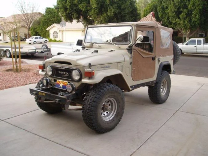

What I had was a piece of 4 inch channel welded to the original bumper brackets. With a couple of tow bar points attached. You may remember from these early thread pics:

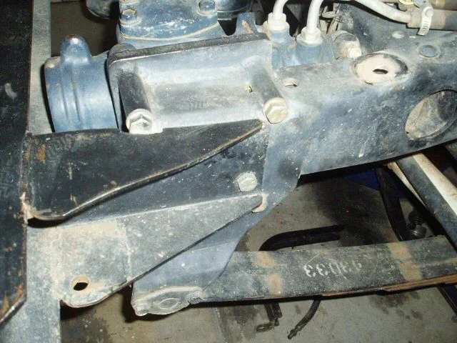

Since the complete re invention of the front spring hangers and frame made the old bumper mount too narrow and too far away. Time for some rework.
