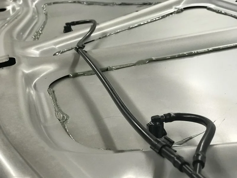

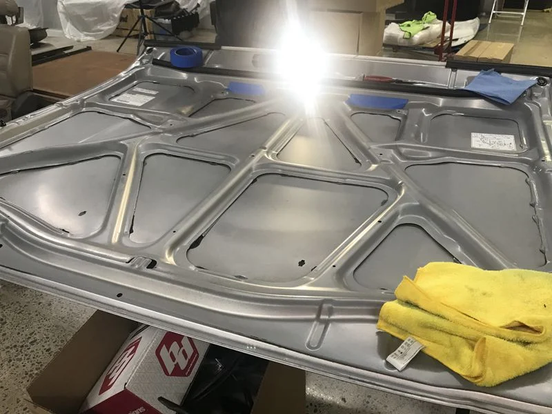

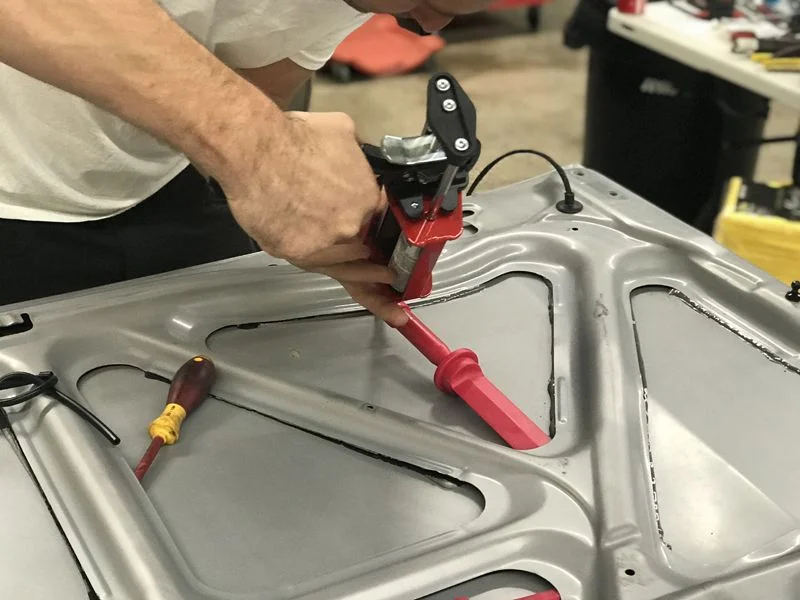

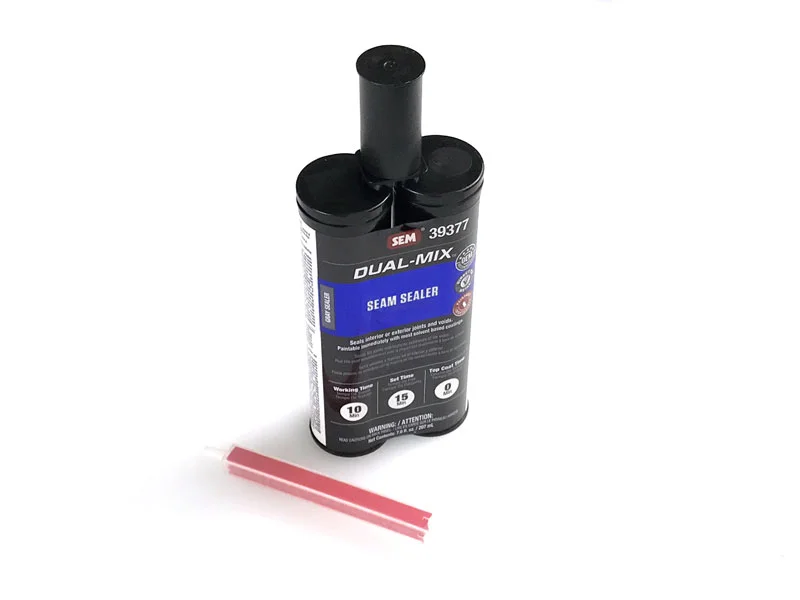

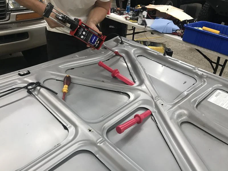

First step was to thoroughly clean the underside of the hood and then use a wax to get it to shine. Knew that the hood fluttered while driving so knew that the hood's sheet metal separated from the frame so first step was to order up some 3M seal sealer and then order THREE wrong applicators until I finally spring for the 3M applicator for $$$ :rolleyes:
Application was fairly easy. It was just using some plastic pry bars to slightly lift up the frame so that some of the seam sealer could be applied under the frame. Once applied the hood is turned over so that the sheet metal side is up and sets up in its natural state.

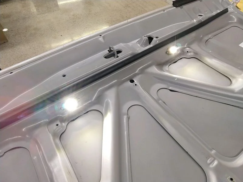

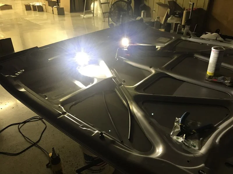

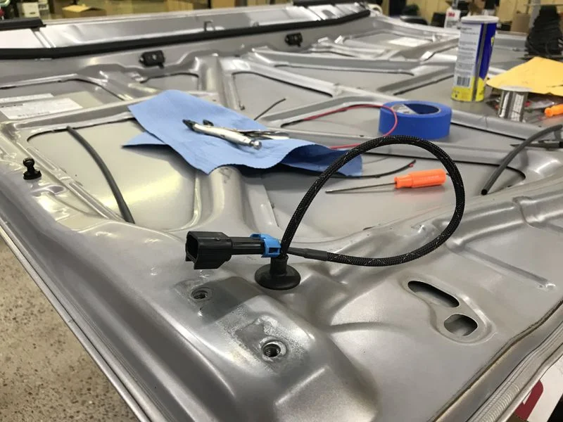

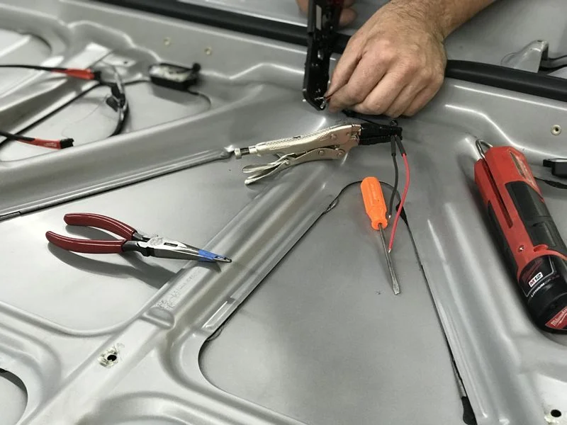

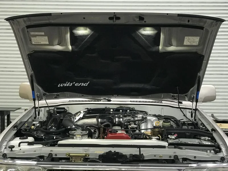

Then it was time to add hood lights. I have the typical cheapo LED light bar on the SC truck but figured I'd go a different out and go with the BajaDesigns rock lights for under the hood. These are the lights without a switch, didn't need it since I was going a different route. All of the wiring went thru the frame. Both lights were attached using M4 rivnuts and the wires went through a grommet that was drilled is just under the lights. Those two sets of wires were then wired together and tied into two wires going down the frame and popping out the bottom left hand side using a windshield washer hose grommet. From there it was terminated to a MetricPack connector.

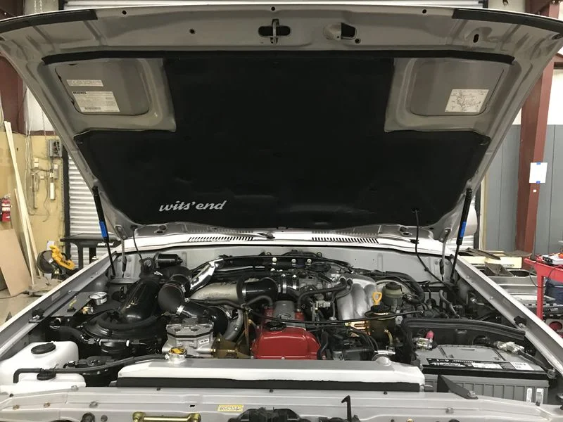

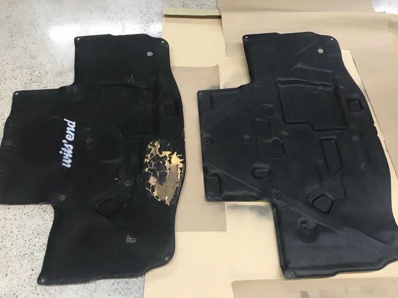

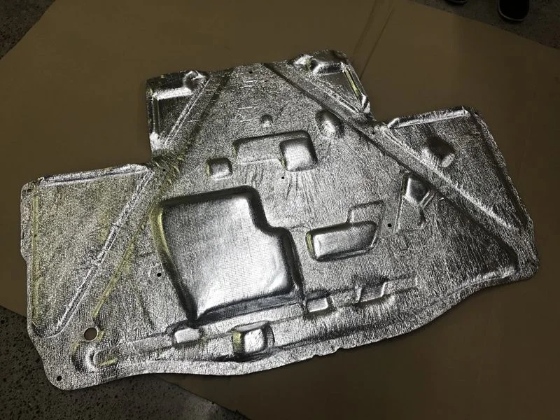

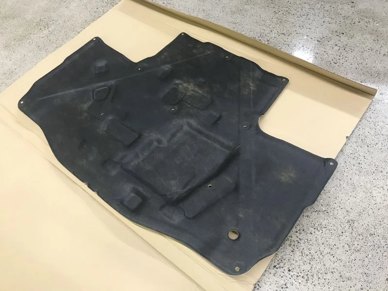

Now it was time to install a brand new OEM hood liner to replace the burned one. The trick here is to order direct from your local dealer because otherwise it gets shipped folded and you don't want that. The new hood liner is actually updated a little bit. Not identical to the older one. Also make sure to order 12 new clips. Cat not included.

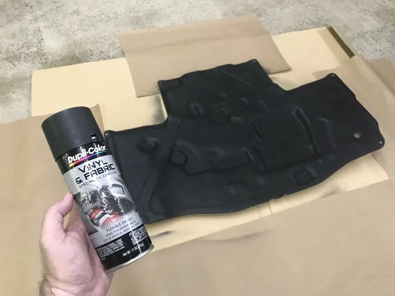

Now that the liner was here it needed to be painted because I felt too much of the yellow fiberglass material was showing thru. Using some matte black fabric dye and gave it a few coats. Sooo much nicer. Pick of the old liner vs new.

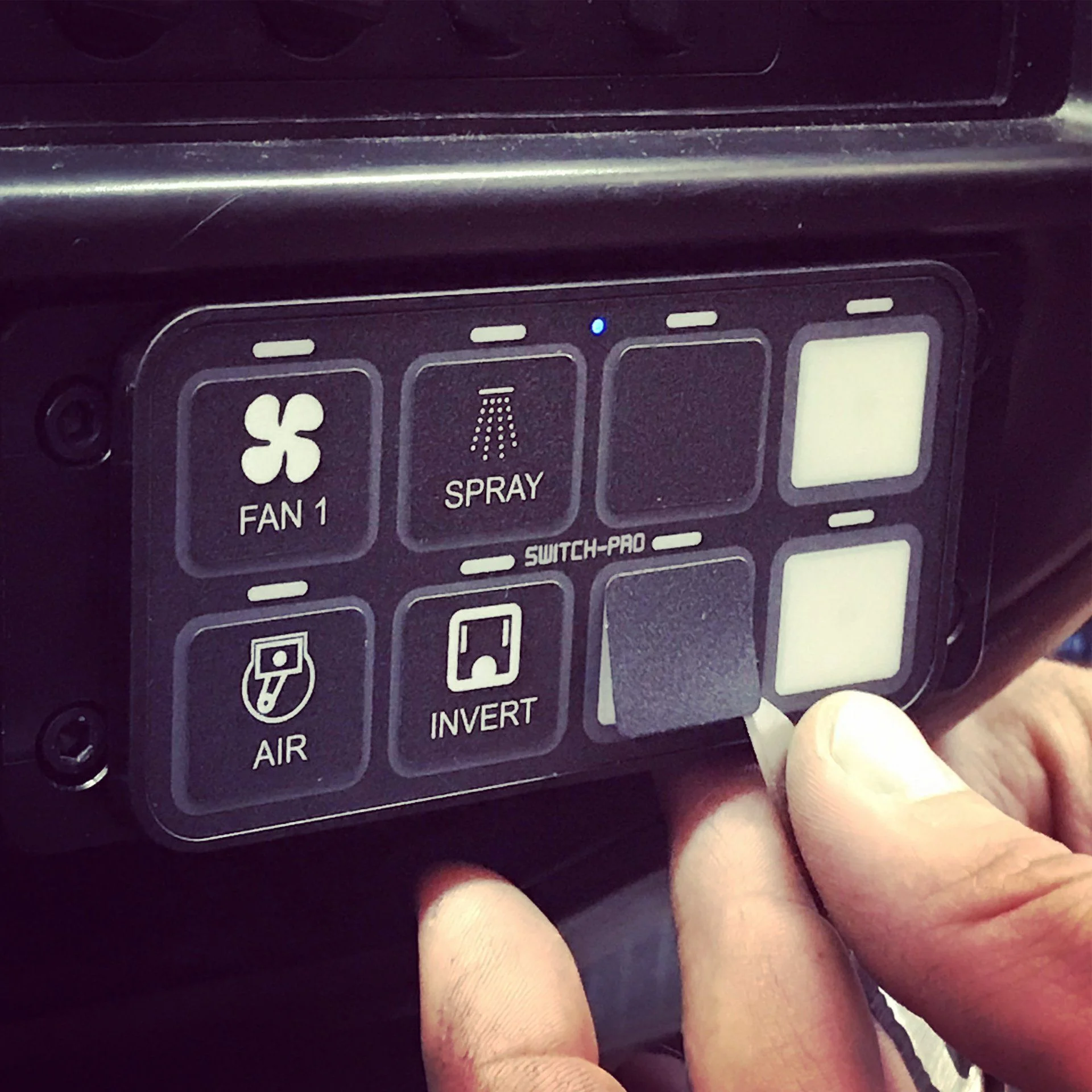

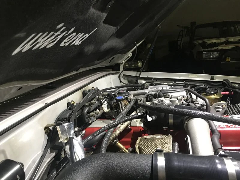

The wiring goes thru the SwitchPros and can be controlled thru the switch on the OBA manifold as well. Turn the truck off and the light goes off. If I want it on I just flick the switch.

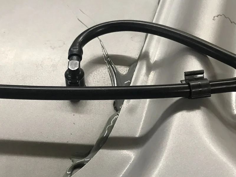

What is the spray for? Spring distiled water on the radiator like an old USSR ZIL truck?
