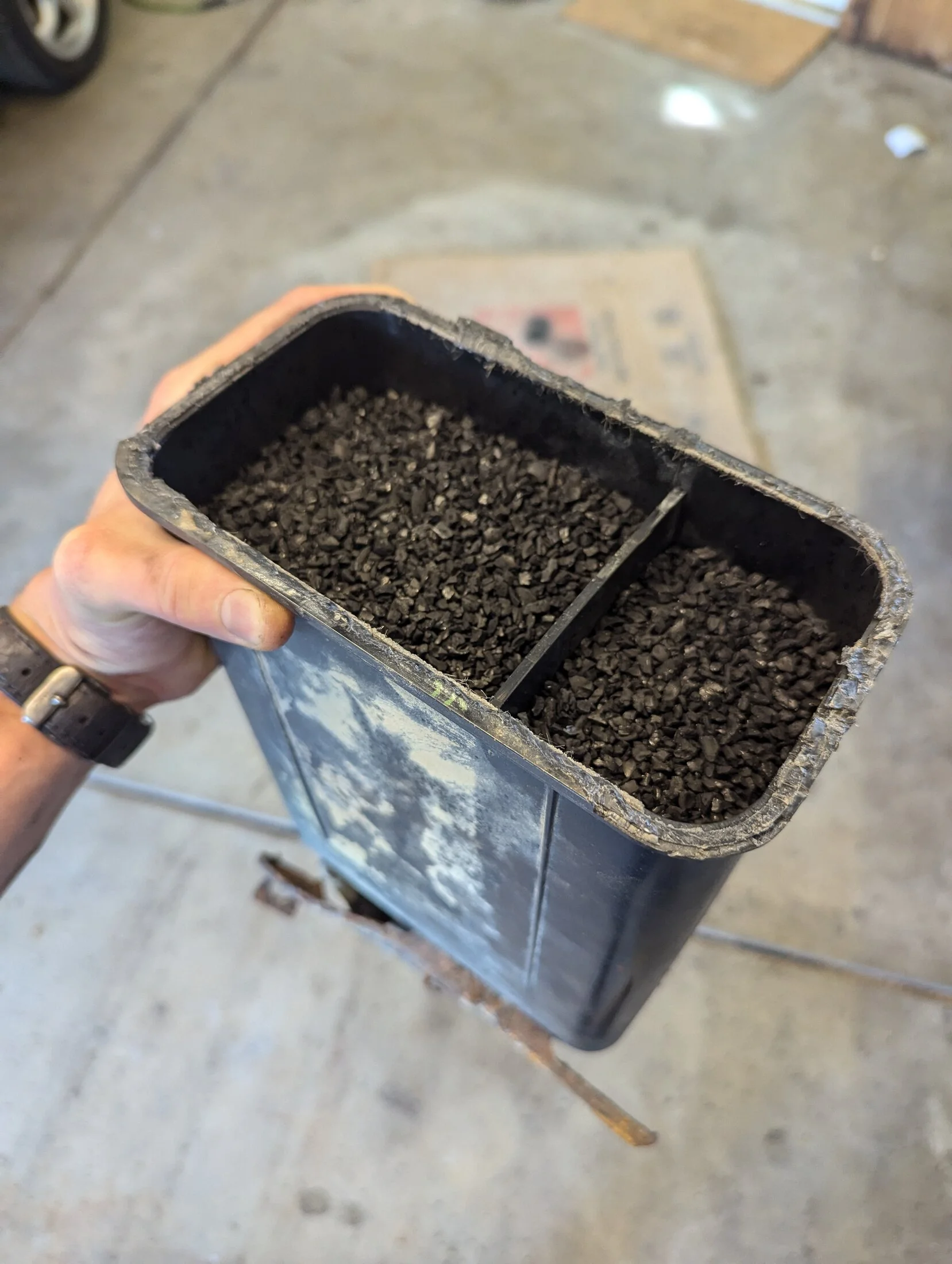

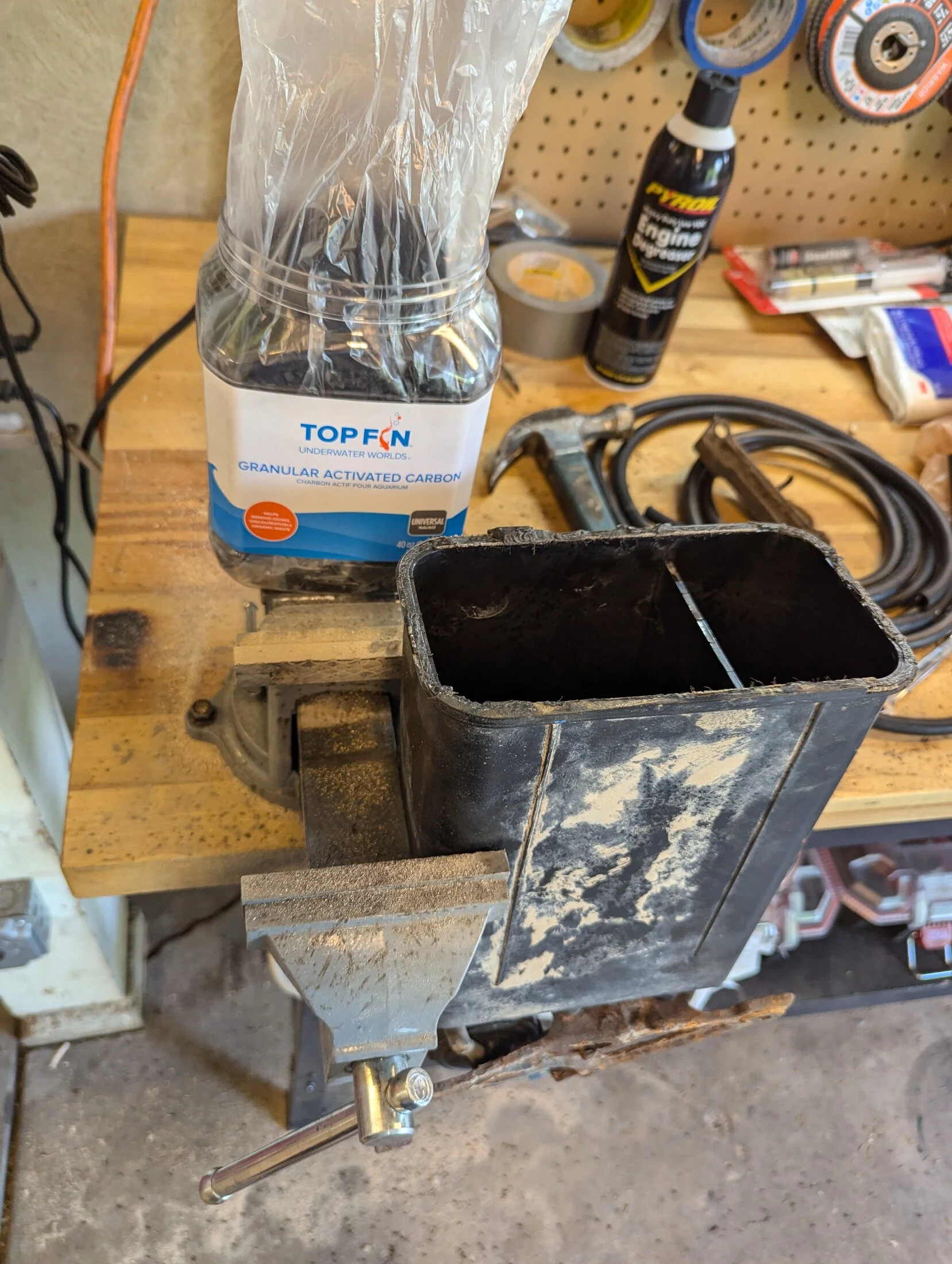

Do you know if people successfully opening the CC and refreshing the activated charcoal media?
I have heard of people doing this with charcoal for an aquarium.
I've not, I just use new OEM. But some in mud have. But IIRC, someone stated, it's not aquarium charcoal.
Did mine yesterday, straight from Petco :)
Whoever said that pressure in the EVAP leads to boiling is just flat out wrong. Pressure stops boiling. For example your engine cooling system is pressurized which raises the boiling point which is why coolant can exceed 212F without boiling. Water boils in space at sub-zero temperatures, because the pressure is low.
So again, we want the tank to remain pressurized and we want the temperature to be as low as possible.

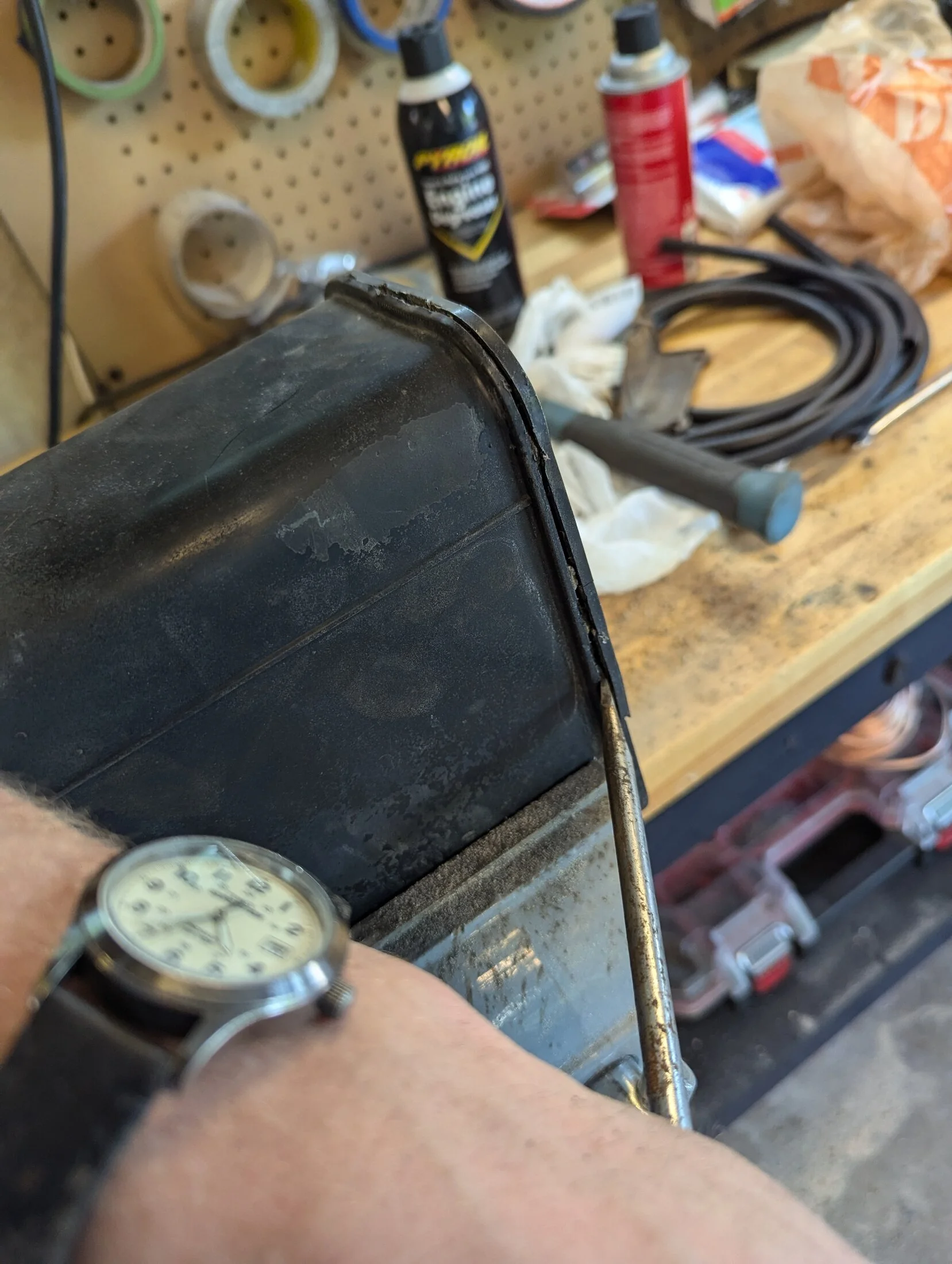

I replaced the charcoal in my canister but it started leaking after a year or so. Had trouble getting the plastic-weld to not dissolve from the gas fumes. If I tried again I would use a hole-saw instead of cutting off the end. Also I would try really welding plastic vs. using permatex stuff.
Really though, the EVAP canister from a Camry or Solara or even Scions from the 00s is the same as 100 series. Plug and play and half price. ('03+ only)
Lastly, if you want to try and dry out your EVAP canister you can run the hose directly to the vacuum port on the engine and bypass the switching valve for a few thousand miles. It may throw a CEL but it will dry out the canister.
