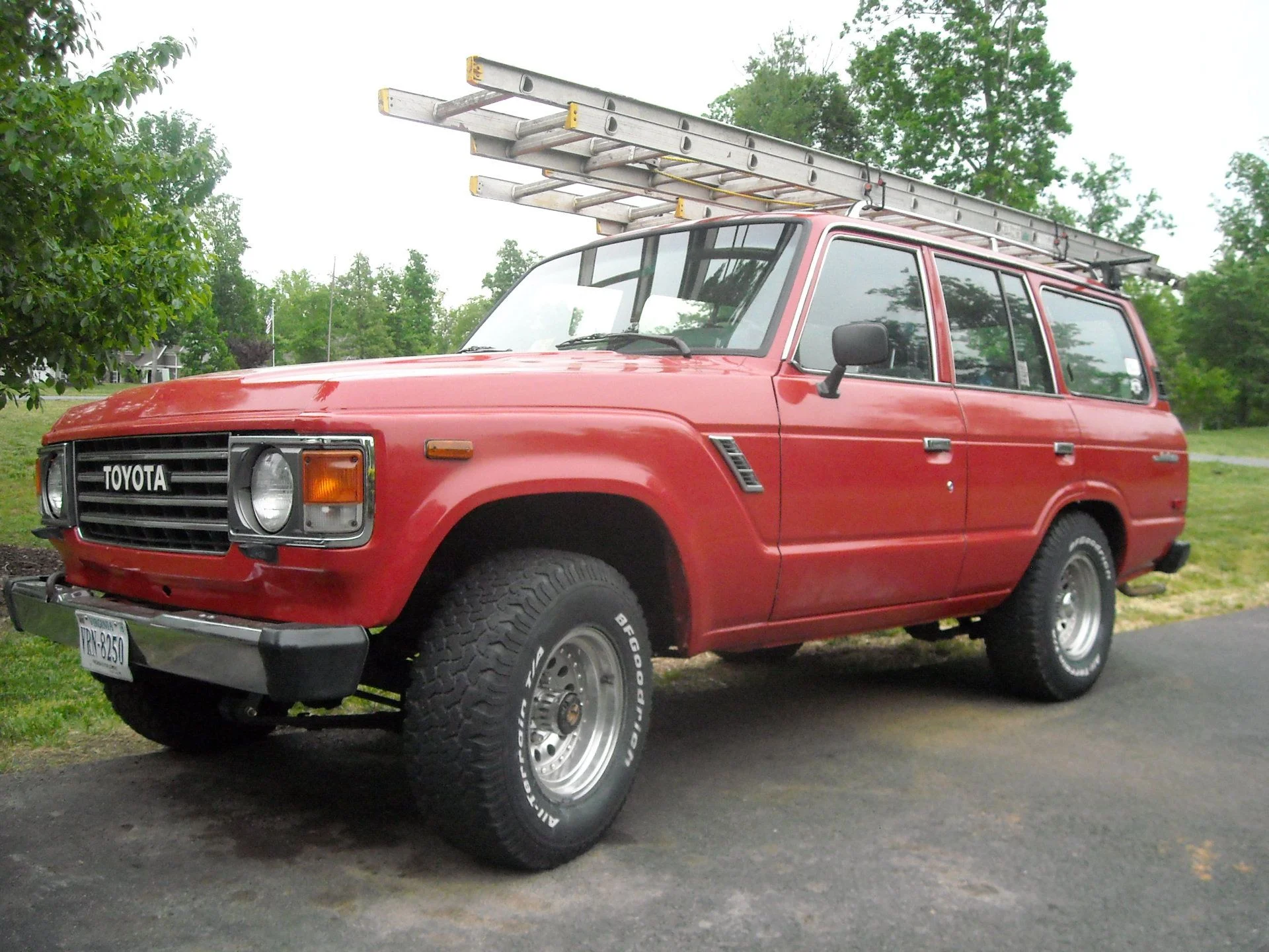

I was just asked about my cruiser by a Mud member and realize I never had a build thread or any back story.
I bought my rig (no name but maybe someone can help with that) in 2006 while looking for a work truck. I had just read Dave Ramsey's Financial Peace and was looking for a vehicle free and clear and with a budget of about $2000.00 every truck I looked at was rusted at the frame and had broken motor mounts or other serious issues. I needed it for gutter cleaning. My side business when I was not at the fire station. I retired in 2013. So I found this rig with a for sale sign on it 2500.00 in a local gas station parking lot. I had drove by it for 3 weeks and wondered why no one had bought it. Finally I called the owner and arranged a test drive. The engine was strong, but the 4 speed was worn with 212K miles. I had to double clutch to get second gear. Bent bumpers and rust bubbles in the quarters and front pass fender. The hood sank a little and looked sad ...only some rubber bump stops that needed replacing. I waited a few days then called him back. Would you take $1500.00? "yes" was the answer. So I sold my f250 and got out of payments. Been cleaning gutters since. Here is a pic of it today.

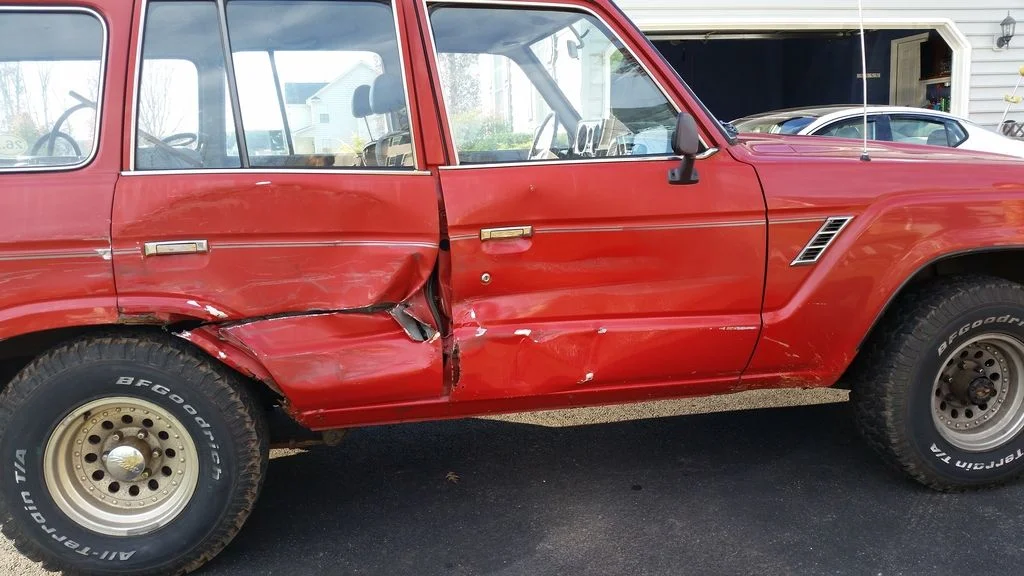

Since then I installed an H55f 5 speed, replaced the clutch, master and slave, rebuilt the carb, replaced the starter, replaced the radiator 3 times, replaced the smog pump 3 times, replaced the water pump, had the alt rebuilt, replaced the VR, replaced the headlight/turn/hazard switches, replaced the spring bushings, welded on the frame a bunch, had the exhaust replaced. Built a sleep platform and camping drawers. rebuilt my front marker lights...bla..bla..bla then in 2015 this happened...
six page thread detailing my fight with the ins. co.: fj60 wrecked today on the interstate
then this...quarter panel install

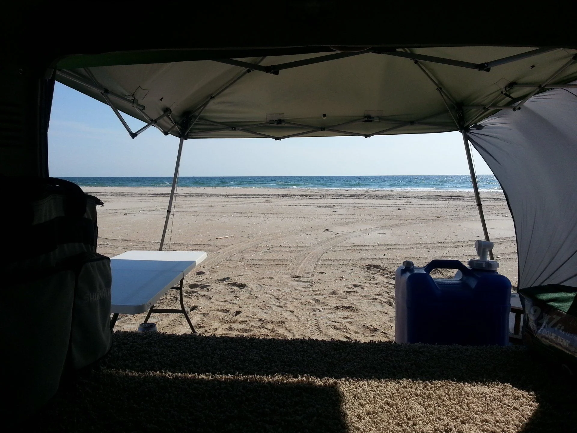

Then in June of 2017 I built a sleep platform and spent a week at Cape Lookout solo. My wife doesn't want to rough it that much. I'll probably go again this year. These pics are from the south end of the island about a mile from the point.
