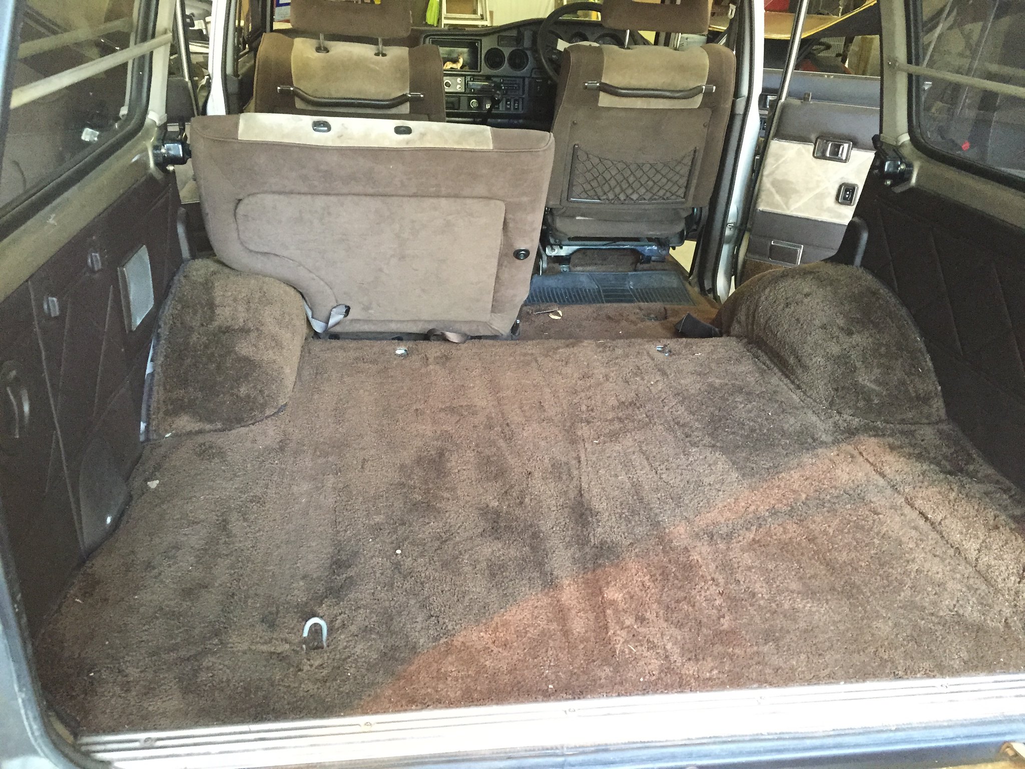

What are you questioning that doesn't look "factory"? This is the stock interior on my HJ61.
Ah. HJ. Hadn't seen any of the US spec FJ6x with split rear. I grabbed a set of seats out of an Izuzu Rodeo for my front and back, and it looks just like those. Was going to ask for pictures of the mounts you had to fab for the rear, but not applicable. Nice build BTW, and thanks for the reply.
