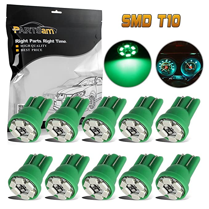

Put some of these LED's in my instrument panel. Much better I can see my gauges at night.

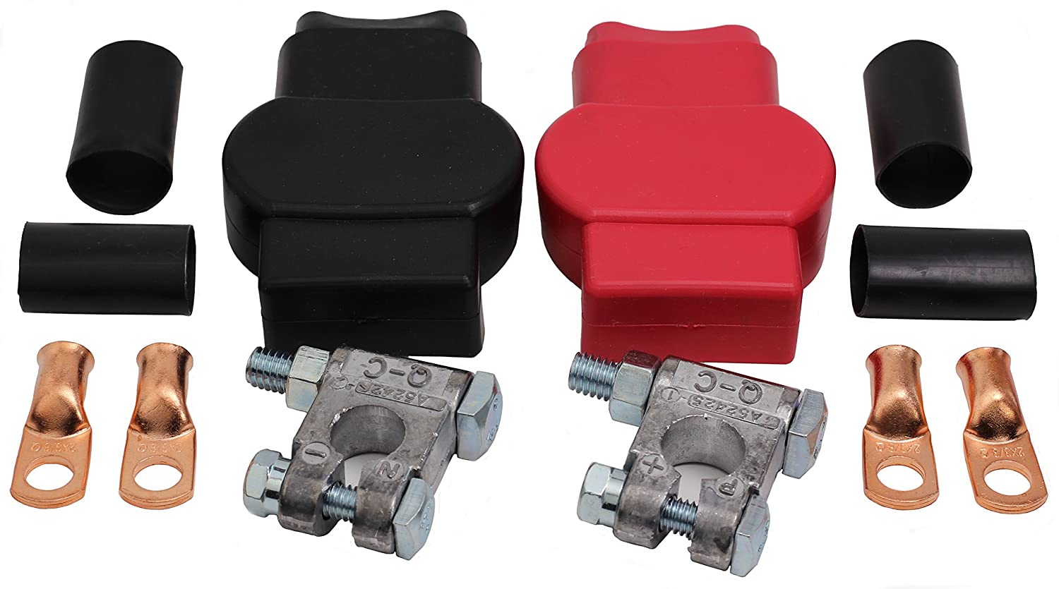

Then bought military battery terminal kit:

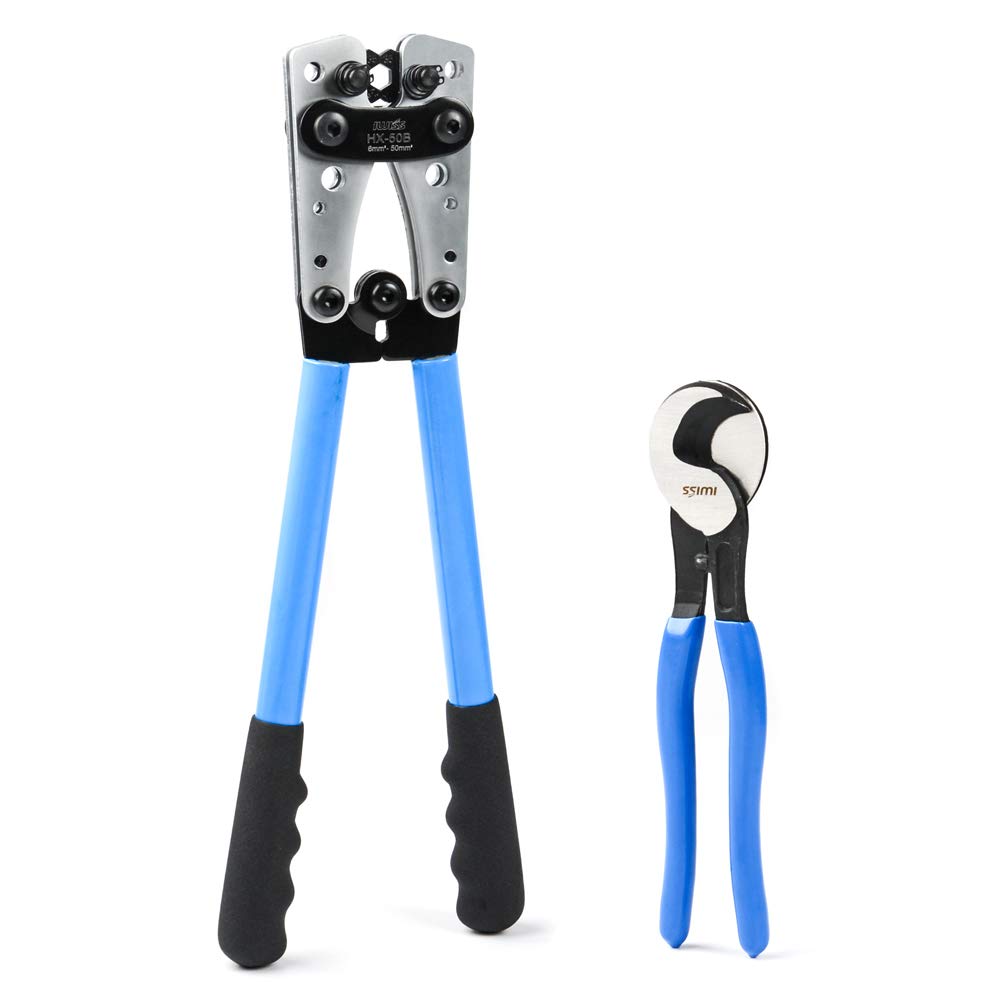

and installed with these crimpers and cutters:

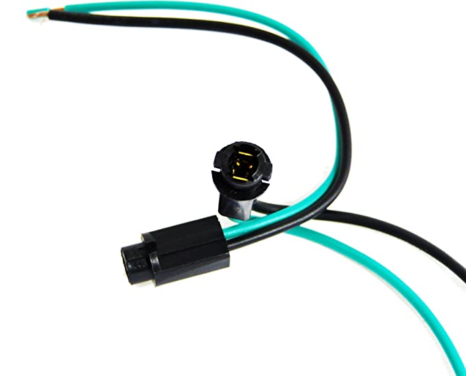

And figured out how easy it is to get the heater control panel light. Just push in on the pass side of the black rectangular panel that protrudes and it unclips from that side, swing it out and the other side comes out. Then pull the white bulb cover off and there is the 3022 bulb. Thinking about trying a LED here.
