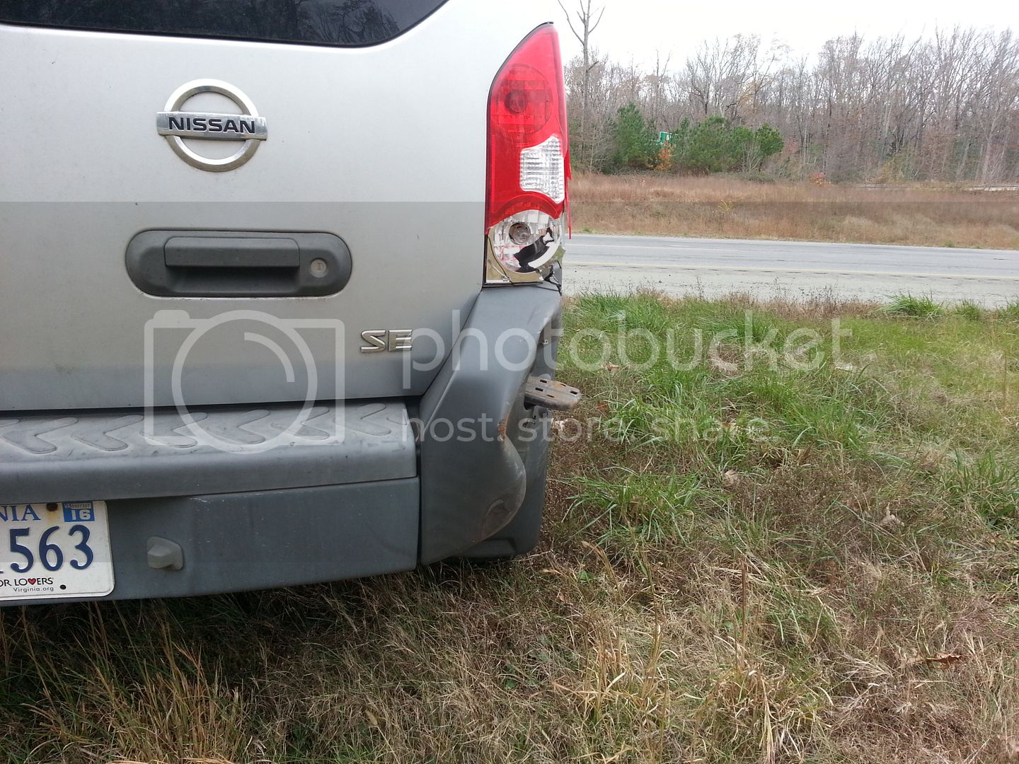

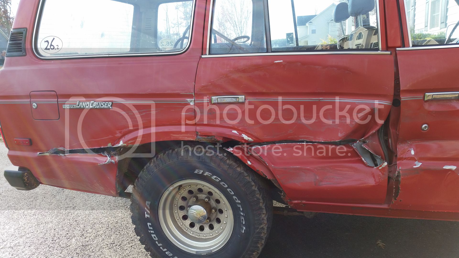

A young woman in a Nissan Exterra spun out in front of me in the interstate today. She said her ignition cut off on her. I tried to pass on the left and got about 1/2 out of the passing lane but she still managed to spin into me. Fortunately no-one was hurt. I will prob be shopping for some passenger side doors soon. Anyone in VA parting out...let me know.
Wow. Glad to hear you're safe, that looks like it could have gotten ugly(er). Couple of doors, some welding, she'll be good as new. What cut her like a can opener?
did it bugger the B pillar?
insurance company is not going to be easy to deal with, they will come in with a low offer and say it is totaled.

pillar should come out and a good one back in without too much adoo...as long as it didn't tweek the upper and lower rail when it was torqued...just find a red one, drill out spots and replace...it's only steel.
lucky! lucky lucky :cheers:
cut the 60 open like a can of sardines.....bet that sounded horrible(if you can even remember the sound)

You can pop the lower spot welds on the B-pillar and cut it where it is straight up top and replace. Harbor Freight sales the bits for removing spot welds.
I would just take whatever insurance money they give you and invest in a solid welder and get to splicing!
