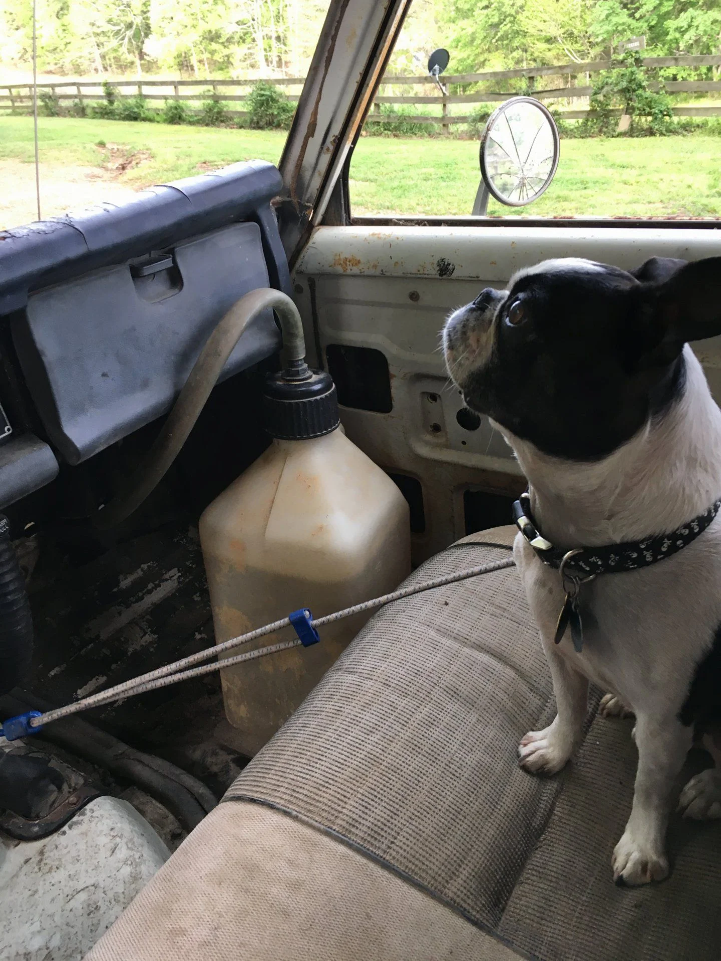

I hooked it up and ran it a bit off the tank and I was getting lots of crap in the filter.
I went back to using my 5 gallon can so the gas can slosh around in the factory tank and break loose more junk. Then I can drain it.

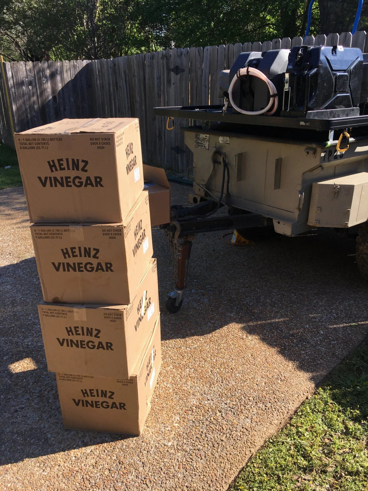

So here is the plan. Y'all probably think I'm being lazy here not taking out the tank but that's not it. I'm scared I'll be tapping bolts and cutting hoses. This way I'm just pouring and draining.
$100 for all this stuff.
Question.
Should I do all 24 gallons of vinegar at once or do it twice?
