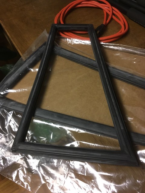

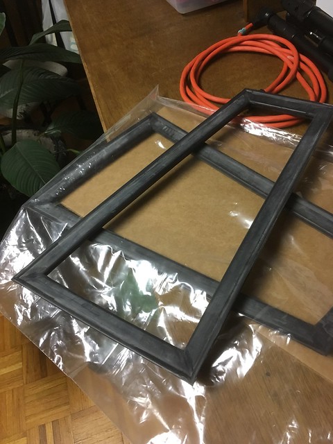

All - some explaining is in order.
Name is Dave Ehlen and I run Genesis 4x4. Feel free to PM me to start a conversation.
I have been having issues with the paypal commerce function on my website . Specifically, I am not being notified when orders are placed. I will shutting down my site and getting to a simpler set-up. I deeply apologize for the hassle this has created.
If you have sent me an email or tried to contact me and I have not responded, please send me a PM.
To be sure, I make the glass sets to order (this takes a few days), but I stock the weatherstripping and have a number of sets in stock.
Thanks for your patience and again, please reach-out to me directly if there is something I need to resolve.
PS: for those considering, the complexity and expense is not in the weatherstripping profile itself, though new molds and dies are not cheap. The issue is in the complex cutting (4x) and bonding (4x) that must be done by hand for each piece and mirror imaged for the pair.
If there are other parts of the FST door that you are interested-in seeing/borrowing, please let me know. I have most of these in NOS.
