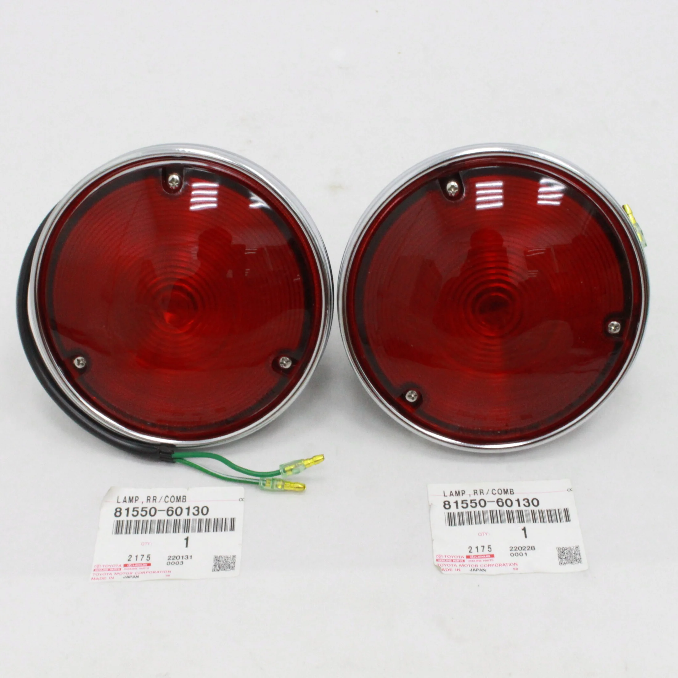

  • LAMP ASSY, REAR COMBINATION, RH, RED; 81550-60130; 1; 03/1969-09/1973​
  • LAMP ASSY, REAR COMBINATION, LH, RED; 81550-60130; 1; 03/1969-09/1973​
toyota-land-cruiser-fj40-fj42-fj43-40-series-rear-red-round-circular-tail-lights-combination-l...jpg
You need to know the month of your 69 to get the correct parts. There were changes during the 69 model. Not clear what month the 69 model started. 10/69 was the start of the 70 model year. Toyota has not supported the pre 3/69 in the parts system for decades.

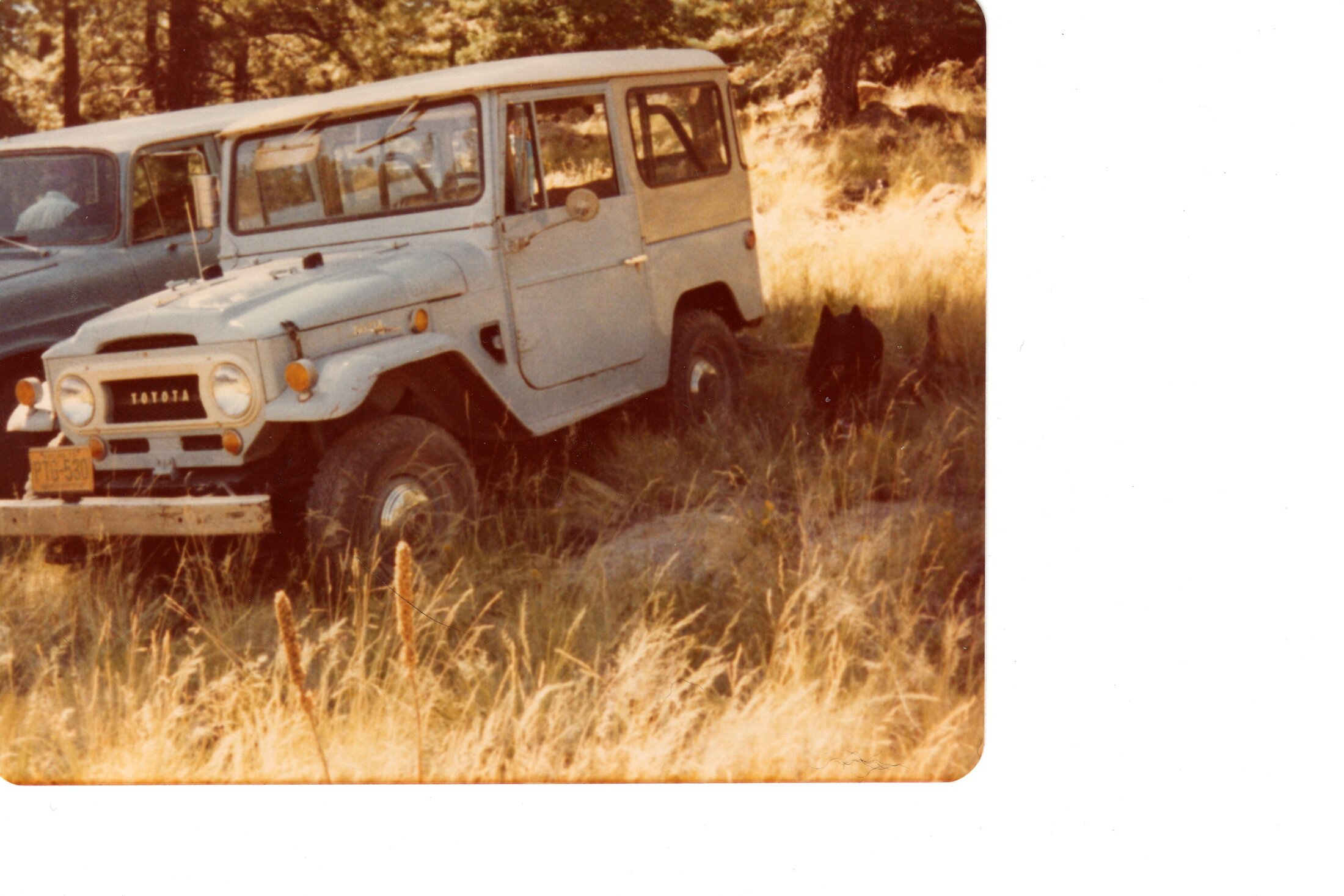

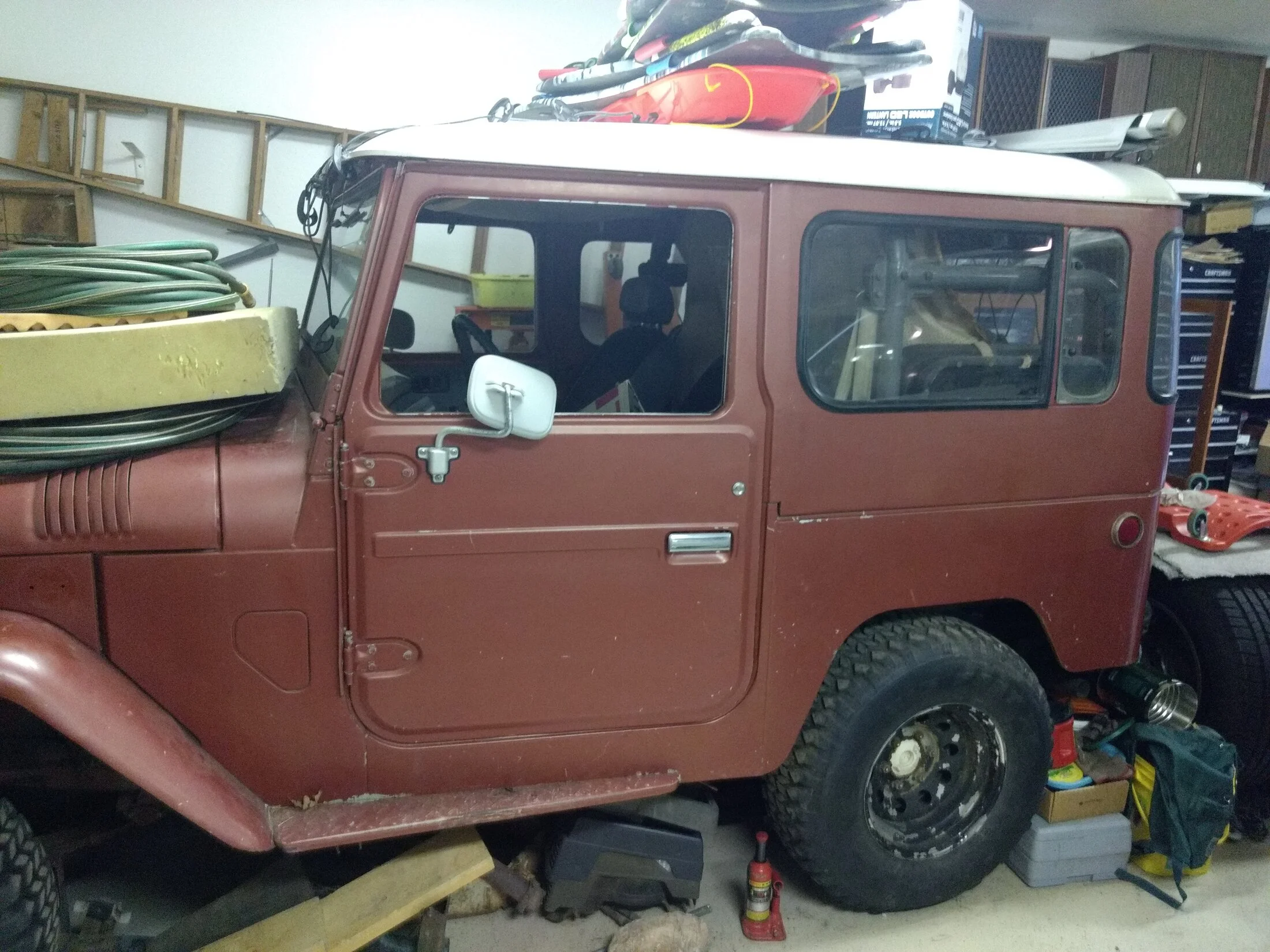

This is my 9/67 in the late 1970s. That is a 73 hard top because of an accident in fall 1975.

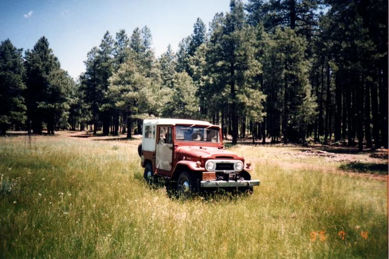

I ran a soft top on it during part of the 1990s.
First two pictures are with 73 bows and doors. Top is a Kayline top bought new in 1994. Last picture are bows, doors off a 69 and used Kayline top that I bought in 1995.
Here is how it looks today with a bad clutch for almost twenty years.

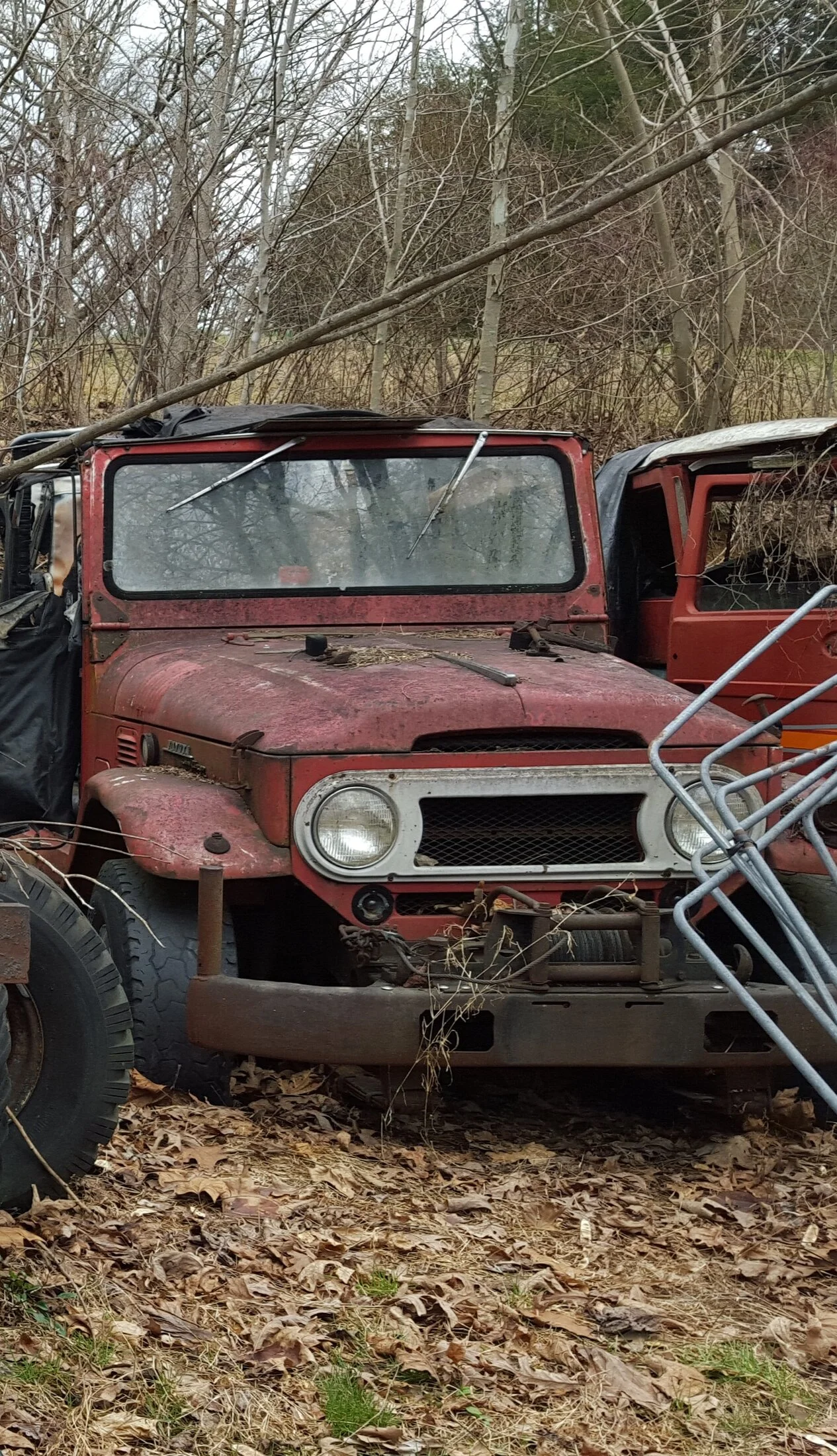

68 and 69 models are easy to recognize because of the amber reflectors behind the emblem on the aprons. Hard top or soft top didn't matter. Only thing that stands as easy to recognize is FST had a tailgate while hard tops had barn doors. When Toyota changed the hard top design in mid 1965 both top and soft top models were made to except the. The other type of top. I have a 73 FST that had a 72 hard top and doors on when I bought it. Luckily all the original soft top parts were came with it. On my 68 the only thing I did to install the soft top was drill hole along the top of the tub for the twists. That only because the Kayline top twists did not match the factory twists. The factory twist holes were already there. the brackets for the back bows already had bolts in the correct location. If I drilled the dash for eyebolts (the dash itself has the hole but not pillar behind it) and added a tailgate it could pass as a FST. US model FSTs all came with soft style doors. The doors are the hardest to find for a factory soft top model. Aftermarket bows are available. Usually those are made to work with soft doors. Most run hard doors. The B pillar bow and header over the doors are different depending on which style doors are being used.
Every time Toyota upgrades their parts system information is lost and things get moved to different diagrams that make no sense. For the most part all the information required is still out there. It's the parts that are the issue. How complete is your soft top model? What's left of the doors look like either Best Top or Kayline doors.

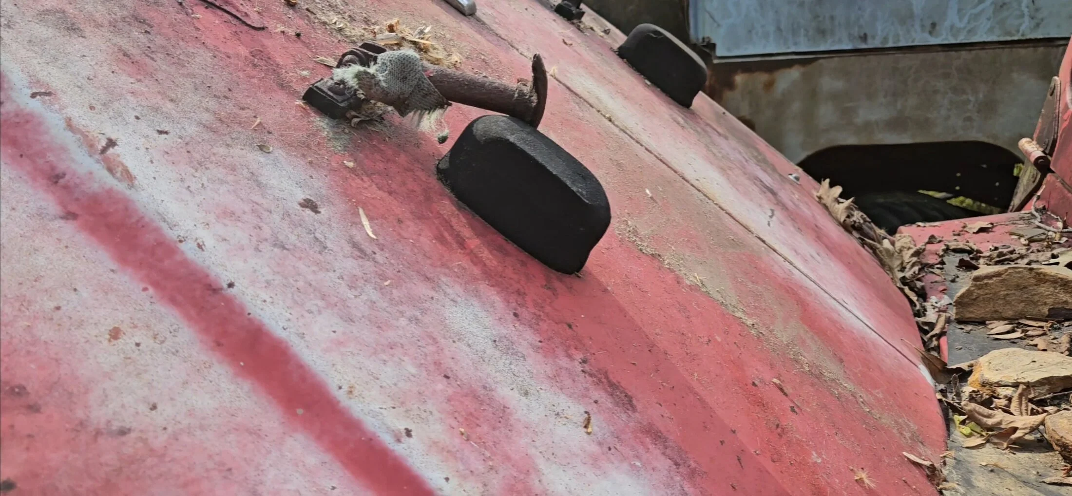

If you haven't checked your VIN for a date I believe you have a early 69 going off the pad on the hood. As for tail lights probably have the earlier smaller ones. Easy way to tell is if the mounting holes in the crossmember are offset from each other or even spaced from the end. Either one requires a cone on the back for protection. Last time I checked the front bib lights were still available and cheap.
If you don't want to post your VIN at least check it on the chart from SOR. It is linked here in the 45 section. In the threads at the top is a list for long wheel base trucks. The link is in the first post. Believe a 12/68 FJ40 was posted up and it has the later pads on the hood. If your are a single lever could be a 68 product date. 68 engine seem to be a mix bag if it came with an air pump or not. Believe one with an air pump was on mud within the last year. Three things to look for. Cylinder have will have ports for an air rail. Mine had ports with plugs in them. Two pulley harmonic balancer. Mine had a single pulley but engine had been rebuilt before I bought the cruiser in 1974. A second port for a hose from the air pump. Mine was there with a correct fitting rubber plug. Not sure the story about the 68 air pump. Or where it was required. 68 model the US required dash pads. Possible all US models we ready to add an air and California was requiring one? Toyota planning ahead for up coming emissions. 69 did not have an air pump.

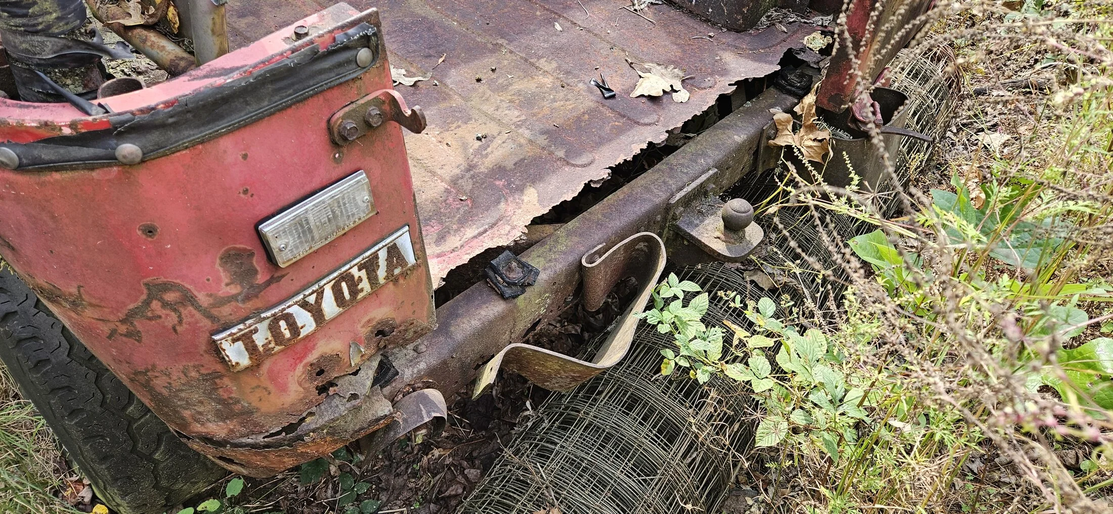

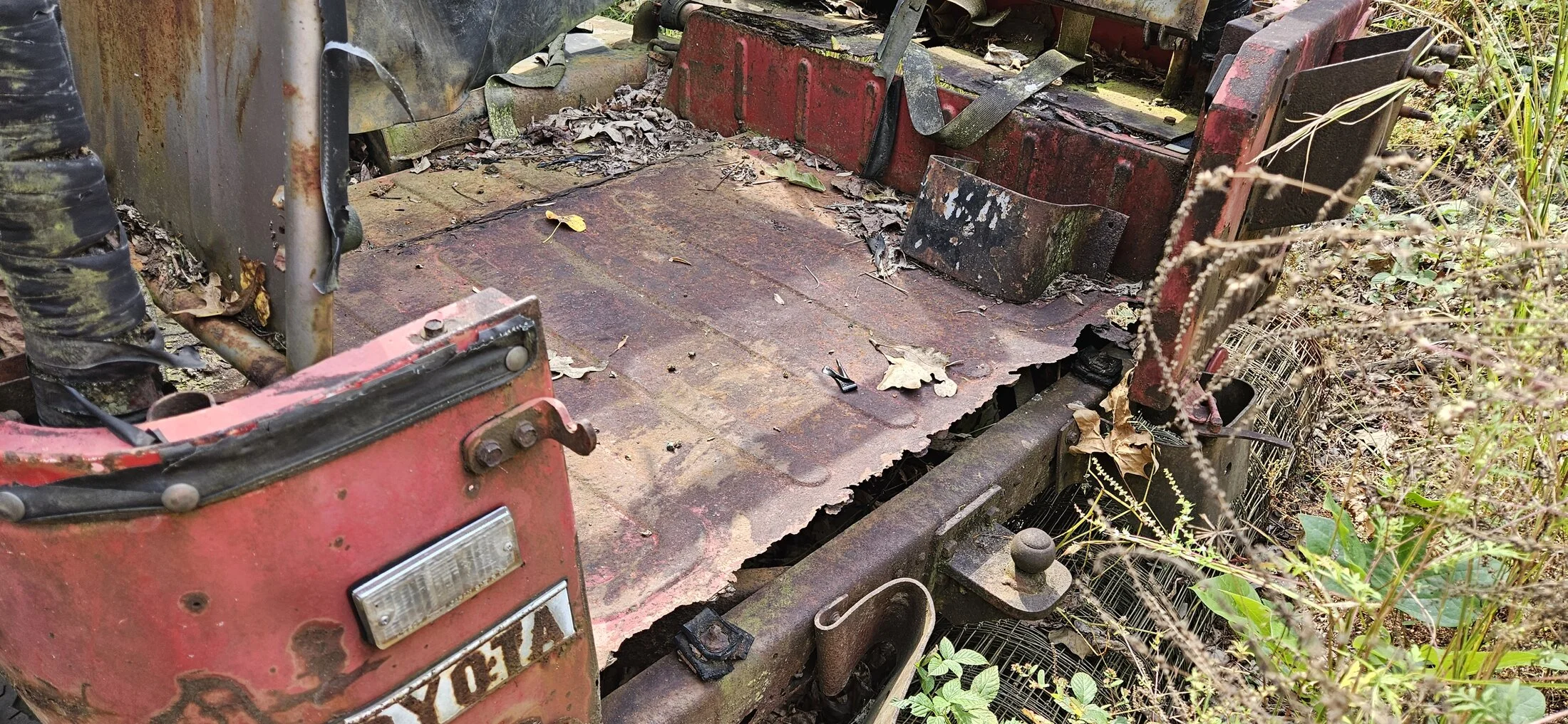

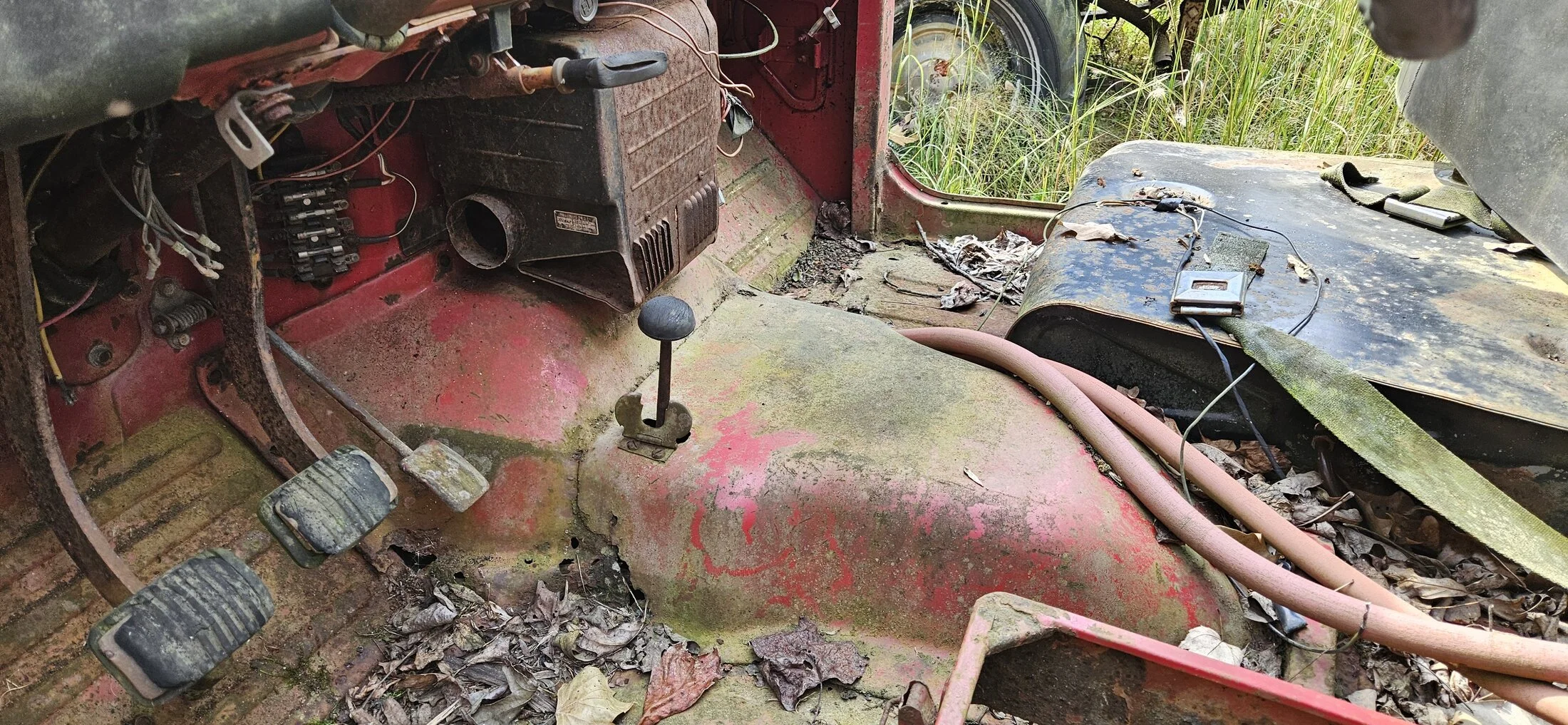

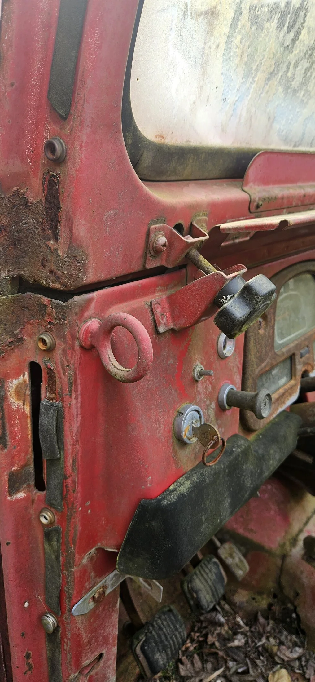

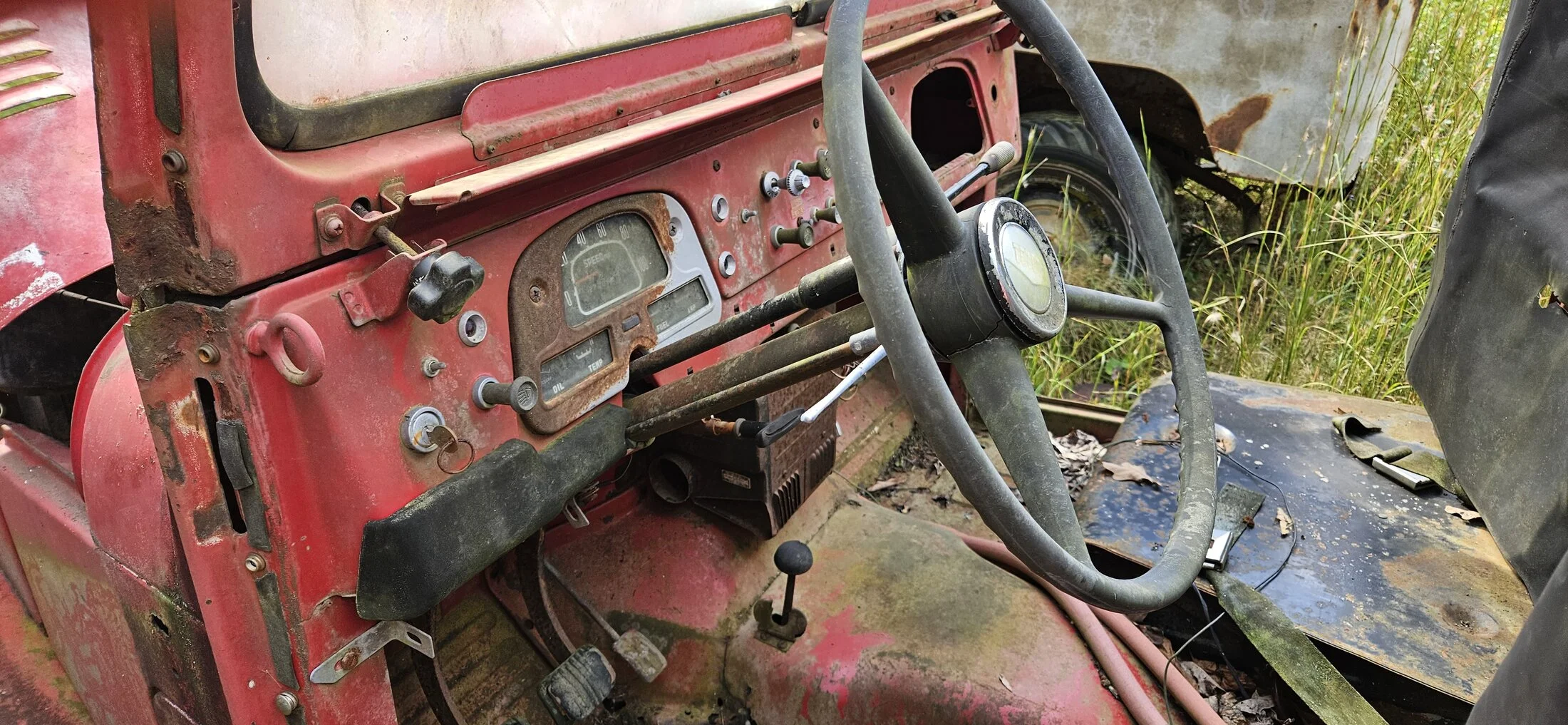

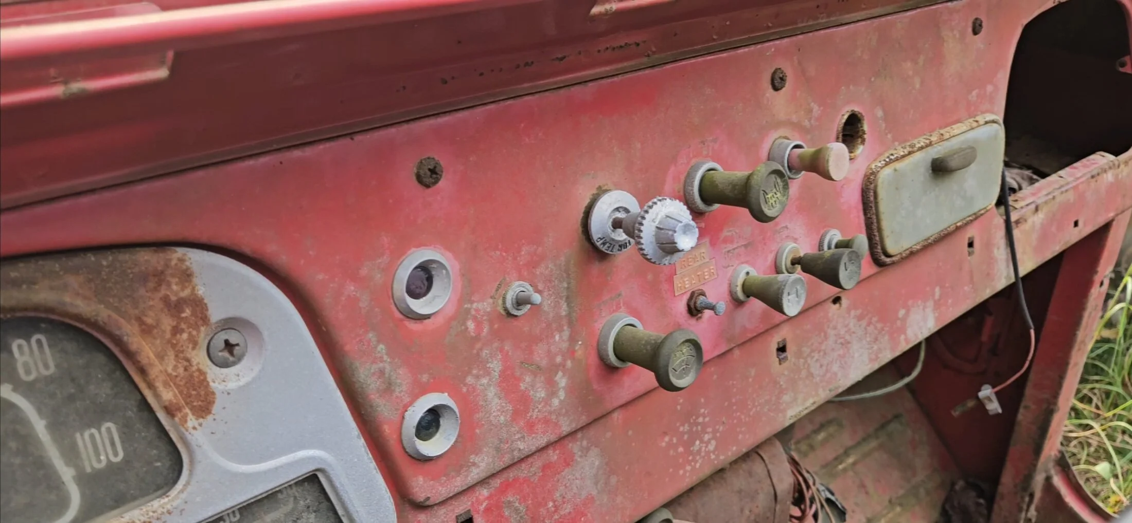

I think the dilapidated top that's on my truck now was a best tops top. The original Toyota top wore out. The doors, and bows were stored and the best top top and doors were installed. I do know that this truck did NOT come with a factory roll bar. I'll get some more pictures and info.
Got a few pictures yesterday. The data plate was gone. I did not have enough time to wire brush and try to find the frame # or engine #. I'm thinking rebuild the drivetrain and slap on a topnault tub. I think the new tub would be worth the $7k to not have to do rust repair. This one says it's a 68' but I'm not so sure...

darth vader light you got
you say you have correct bows
door strap eyelets you got
rear bow mount hardware you have (maybe ... only show the upper mount on one side)
rear tailgate ... got some hardware... missing tailgate and hardware to attach
missing turnbuckles (last checked still available)
missing soft doors and all hardware associated with them
missing door straps and associated hardware
windshield channel
vinyl white top
just to name a few off top of my head... nothing but the common sense fasteners are available thru toyota
