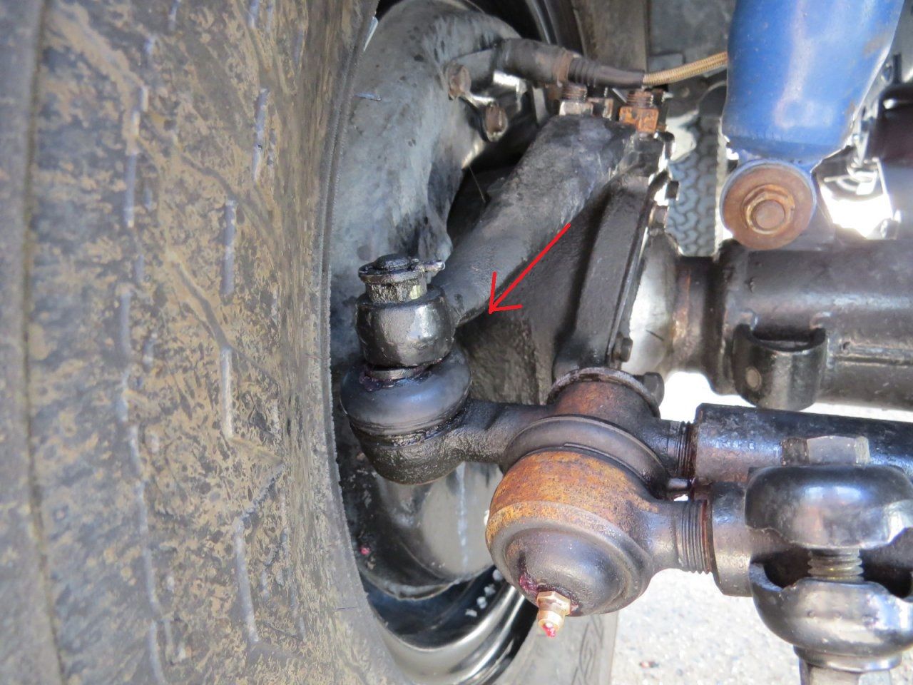

Ok so I finished putting the wheel hubs back together and noticed no significant change. Here are the pics of my steering. I'm beginning to think its a TRE issue.
You are running a 4" lift but still have the original steering. That means the angle of the drag link is higher than the factory configuration, this will cause bump steer. To eliminate bump steer with raised rigs a dropped pitman arm is normally used to lessen the angle between the tie rod and drag link. I've never seen a dropped center link arm so don't know how you would correct this except possibly a high steer kit.

what sort of condition are the TREs in it might just be the angle of the photo but the RH one looks a bit worn is there any play in it?
Yes, that's where I'm looking at next are those TRE's. The drvier's side is in need of some attention since its boot is cracked. Also when I turn from side to side I can feel the play in it, Although I sum that up to the one side having a bad boot so it won't hold any grease.
We're both kiwis ..... but I'm with Sadam here.
One look at this picture and alarm bells are ringing in my head... No way would I be happy seeing any balljoint on my BJ40 looking like this one does:
Jack that wheel off the ground (while leaving the RH one on the ground) and grip the tyre and try turning the wheel left and right.
I bet that particular balljoint has heaps of play.. In fact it looks to be about to break apart to me (and looks to be a VERY SERIOUS safety risk).
