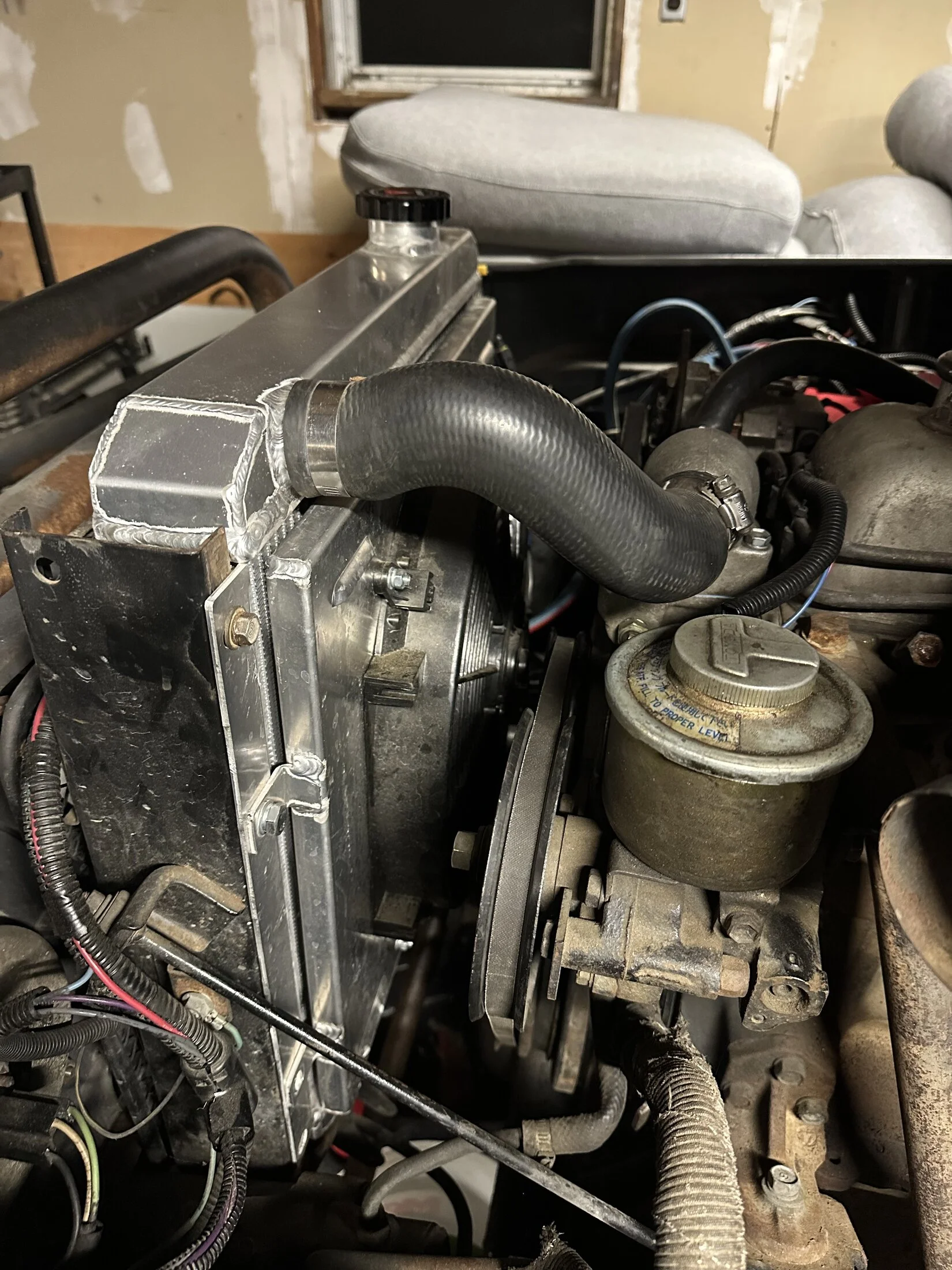

Pic of the fan setup?

I did try to reinstall the mechanical fan but I just couldn’t get it to fit. When through 4 sets of bolts… the fan does have a shroud and the 450 came from an IR gun on the block.
A) get your IR gun on the radiator & the hoses going to/from the radiator. This is the best way to determine if you actually have a problem or not. And the temps you see will give you correct information as to what to do to solve the issue…OR…if you have an issue or don’t. Otherwise you are guessing & getting nowhere.
B) W/O being there with you it’s difficult to determine why you can’t get a mechanical fan on there…BUT…somehow get it figured out and REMOVE the electric fan. You will not solve your issue with your 2f until you do.
Looks like the adapter holding your electric fan blocks off a lot of the radiator core, remove all that for a start. Your hand is a good IF thermometer, put it on the radiator top tank then bottom, should be noticeable difference if thermostat is working - always use a genuine one. X4 for refitting original fan
