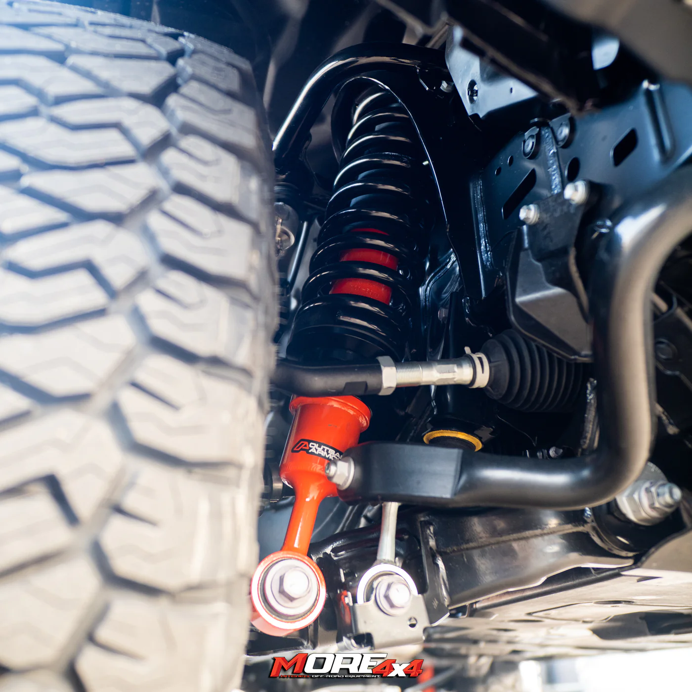

Harder than it should be to find an image of the LC300 front OEM suspension. But this is pretty close to OEM.
The sway bar is pretty exposed and the shock lower mount is single sheer stuck that's unprotected. The Tacoma protects the shock with a bracket like the LC200 and moves the sway bar to the rear and mounts to the LCA on top near the back like the LC250. For playing the really rough stuff - the tacoma setup is the best of the group. I'm sure they'll all work pretty well. Just small differences that are more optimized for rocky technical terrain over the LC300 setup.

The aluminum steering knuckle also looks pretty beefy. Lots of off-road rigs have aluminum suspension components - I do not see that as a detraction at all and it saves weight. Bending a tie rod (inner or outer) sucks but is a pretty easy trail repair IMO.
I don't like the exposed sway bar end link and shock mount in the LC300 posted above and agree that they are begging to be hit. The 120/150 platforms are both better in that regard. I don't see either the 250/300/Taco suspensions being a radical departure from the same basic coilover IFS Toyota has used since the early aughts.
