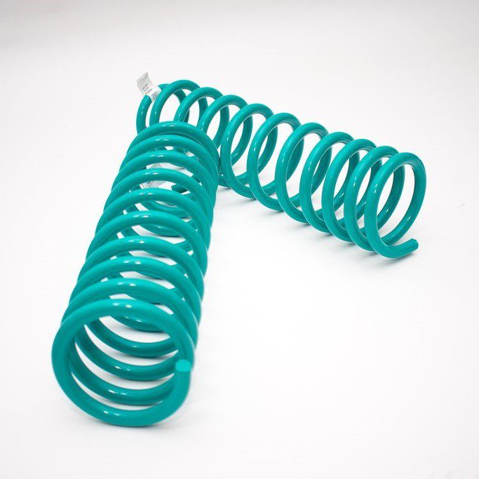

Thanks for the info crikeymike. I’ve got a LC250 with 385 lbs or so constant load in the rear. There doesn’t seem to be a rear spring in that range. Would you recommend going down to the 817V or up to the 819V?
I suggest going on the lower end of the range, the 817V's, because if you run the stronger ones without that extra weight it could lift more and feel more firm than necessary.

1)On the Dobinsons site the LC250 spring is listed as this (50mm, 2.0”), whereas on ExitOffroad it’s listed as 40mm 1.6”. Are there two options for this spring? Or, it seems like the 50mm is made for the GX550.
  • C59-885V (50mm - 2") 0-110lb Load

The GX550 rear end is lighter because it doesn't have the battery pack, so it sits taller than the LC250. The same spring is used on 2 vehicles and produces 2 different lift heights based on the weight differences.
