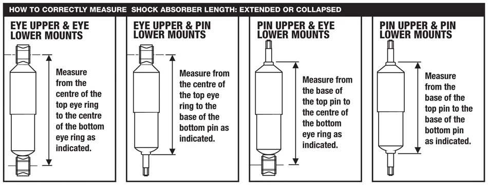

@crikeymike Could you verify dimensions or how you measured for the extended and compressed lengths for the IMS and MRA front shocks you have listed?
I measured my stock front 250 strut, from top of strut mount to center of the lower bushing eye.
My measurements were:
Compressed: 19.44" (494mm)
Extended: 24.25" (616mm)
Assuming you measured the same, if the extended Dobinson shocks are 453mm compressed and 624 extended, then the Dobinsons would have only 8mm more extension but have 41mm more compression. But the extra compression wouldn't be usable because the LCA is on the bump stop at 494mm.
We must be measuring differently, or can you shed any light on this?

Those are specs Dobinsons gave.
Pin top and eyelet bottom are measured from the bottom of the pin to the center of the eyelet. Yes, extended travel on a strut is usually only about 8-10mm longer, as you can't do more without blowing CV's.
Ok, thanks. So my measurements are too long because I measured with the strut top still on. I guess I'll wait until I can take the shock apart.
