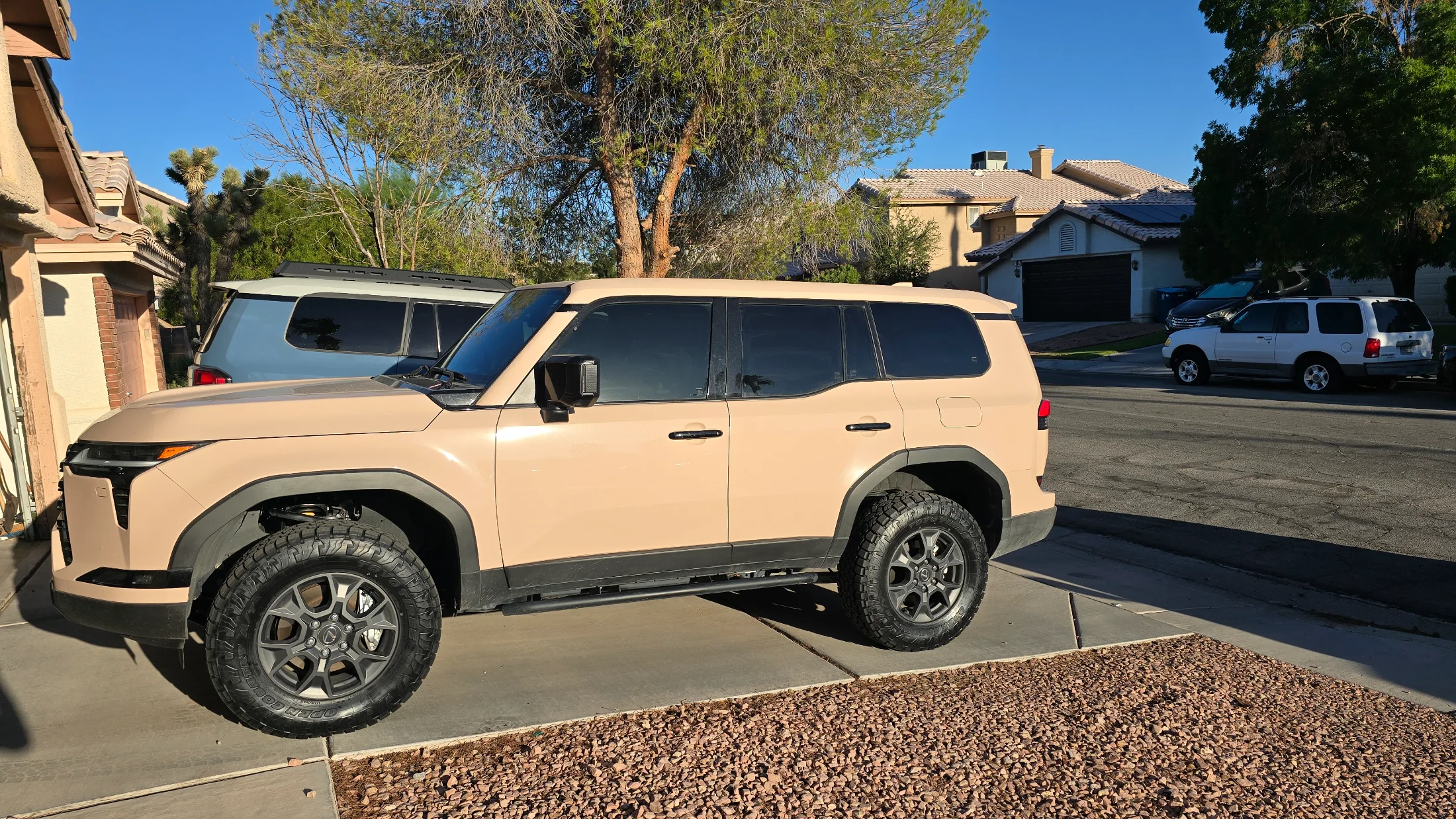

What all have you done?
So far:

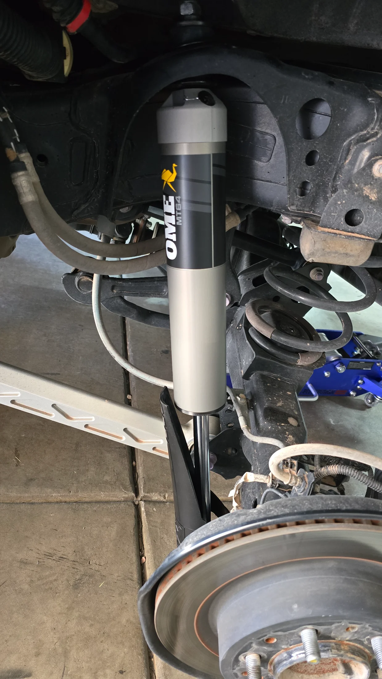

arb mt64 shocks

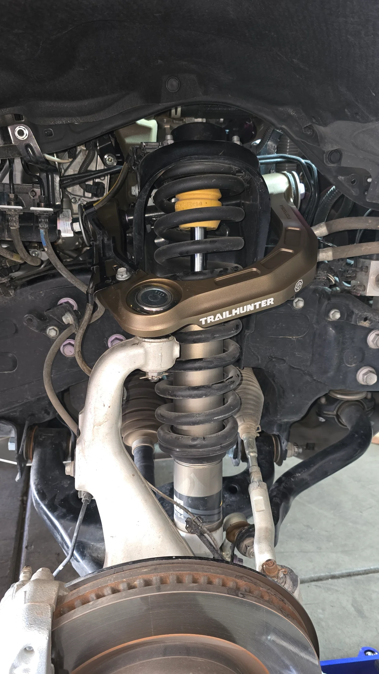

Trail hunter upper arms from the 4runner
Made billet rear lower control arms that use 200 series bushings
Toyo at3 275-70r18 E load tires
Lexus air compressor, yours should come with it
Wrapped it
I have scanned the underside and started designing skids, hoping to replace the front crossmember along with the front ekkds bracket. (Both pretty weak) I want oil filter and drain access like the 200 series skids.
So far:
arb mt64 shocks
Wrapped it

How’s the ride on the MT64s vs factory? What all did you gain height wise?
So far:
arb mt64 shocks
Wrapped it
That thing is pretty sexy. For a Lexus :hillbilly:
The ride is much better than the factory AVS shocks. Raised the front up about 2 inches, with 1 perch left to go up higher if I want. With the tires, which are a little bigger than the OEM Toyos, there is 12" of clearance under the front skid. They also increased wheel travel by about 2 inches too.
On full droop, in the front, the OEM upper arm would hit the spring. The 4runner trail hunter\TRD upper arms have more clearance and the spring clears now.
