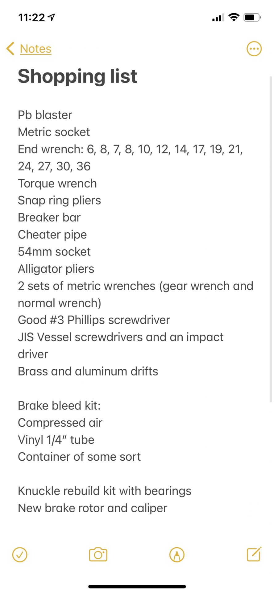

So what are next steps?
Make a shopping list.

How does this look? Anything to add?
Delete the #3 Philips screwdriver from the list. Since you are assembling a new tool kit buy the correct tools to begin with. Do a google on JIS vs. Philips and the diagrams of screw heads should be convincing.
Not sure why you would need aluminum drifts if you've got brass drifts
Metric socket SET. Should come with a few ratchets, extensions and adapters
Short version of the phillips vs JIS thing to end this: Phillips was literally designed to cam out by a FoMoCo engineer named Phillips. JIS was designed to hold and is a Japanese Industrial Standard. Buy the right tool for the right job. JIS paired with a small amount of impact is magic.
You want a 1/2 drive torque wrench if you get one. It'll cover more in the long term.
Snap ring pliers - you want something like this, avoid regular snap ring pliers...they'll be a huge headache for you for your needs. *edit - grind off the little bit that sticks out to make the paddle wider. It gets in the way more often than it helps.
You don't list any sockets. Get them in 6pt (avoid 12pt, they'll just strip out your old fasteners and you're not tearing into engines anytime soon to need them for heads or rods). Get a 3/8 set that includes 10/11/12/14/17/19. Buy 2 more 10mm. Get 3" and 6" extensions as well.
You only need one drift. Get a brass one 6"-12" long. You're also gonna need a hammer to hit it with. Get a medium ball peen. Avoid claw hammers. You're learning and claws hurt you and sheetmetal you didn't mean to hit.
You'll be able to tear that truck apart with the list you have and these additions.
