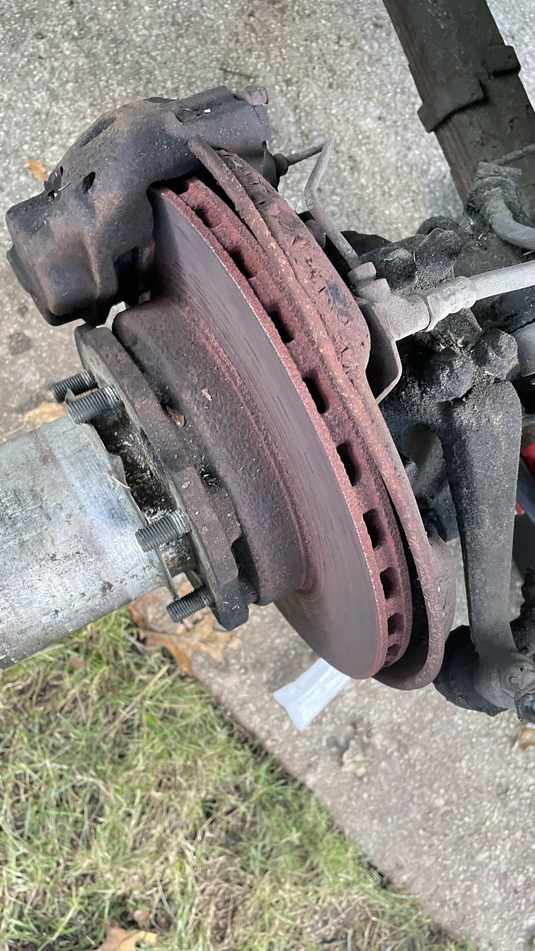

Let's see your, supposedly, overheated rotor.

The flaming brake in question…..can you help me on diagnosis? Is it dead?
Those look pretty seized to me. Time for a full knuckle and brake job.

That sleeve on your hub is just decoration.
