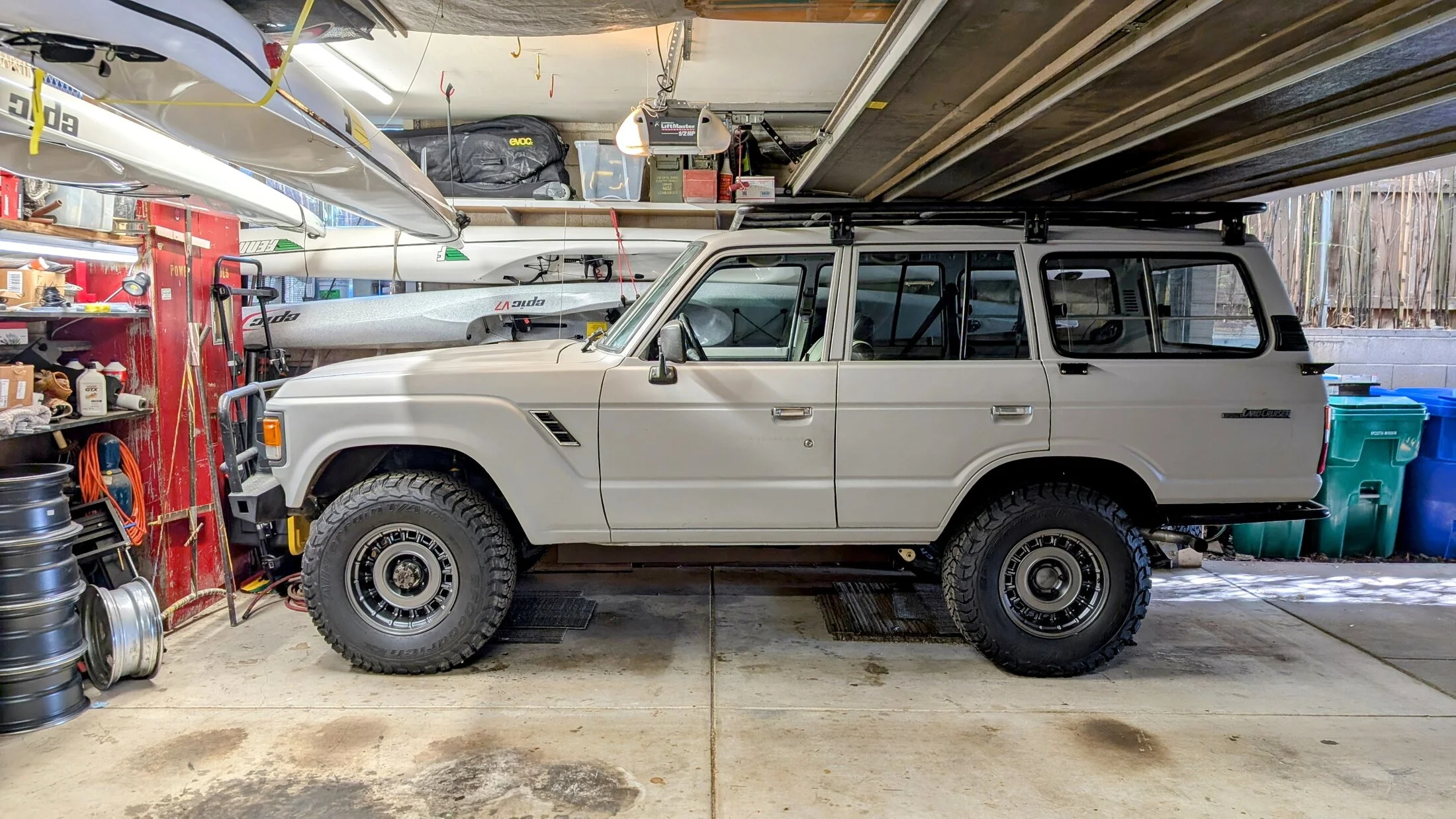

Ha, The installer had to redo the garage door twice even after showing him my truck for measurement first.
The wheels are the Nomad Arvo 17 x 8.5 -25 rims. I have stock axles, no spacers and no modifications to the width. The tires are 285/75 r17 BFG All Terrain KO3. My suspension is a new OME heavy / heavy with the Cruiser Outfitter extended shackles.
The rep at Nomad was interested that I was running such an "aggressive" offset but they still sit just inside the wheel wells on a 60.

I need to see some more of this truck. Is that bedliner? Also, what rack is that?
