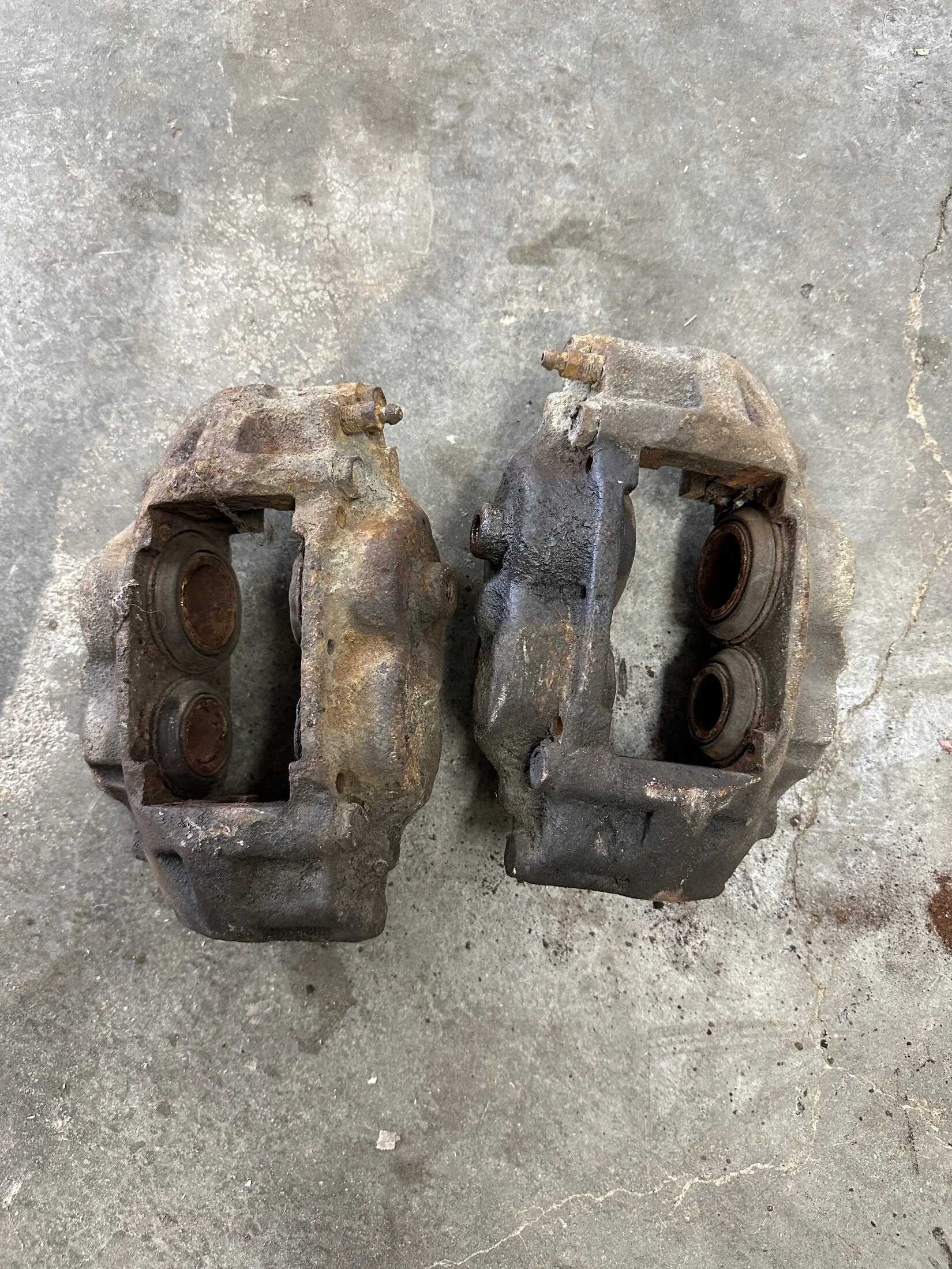

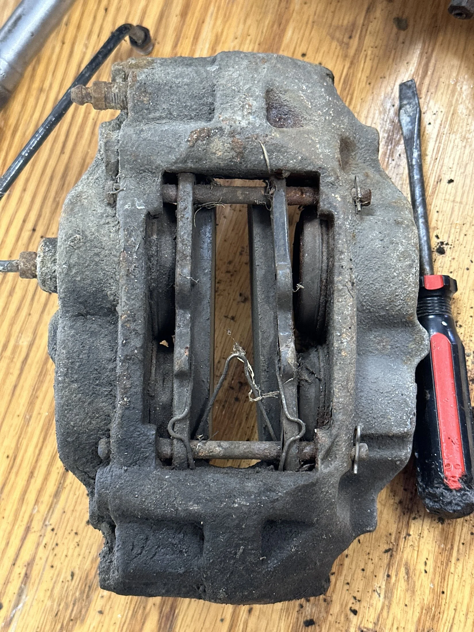

What’s everyone doing for front caliper options on their 60 series?
Buying new OEM, reman from auto store, rebuilding their current ones?
Mine are a bit crusty and the gasket/seals are a bit toast.
Cheers!

OP, yes, those calipers are done.
