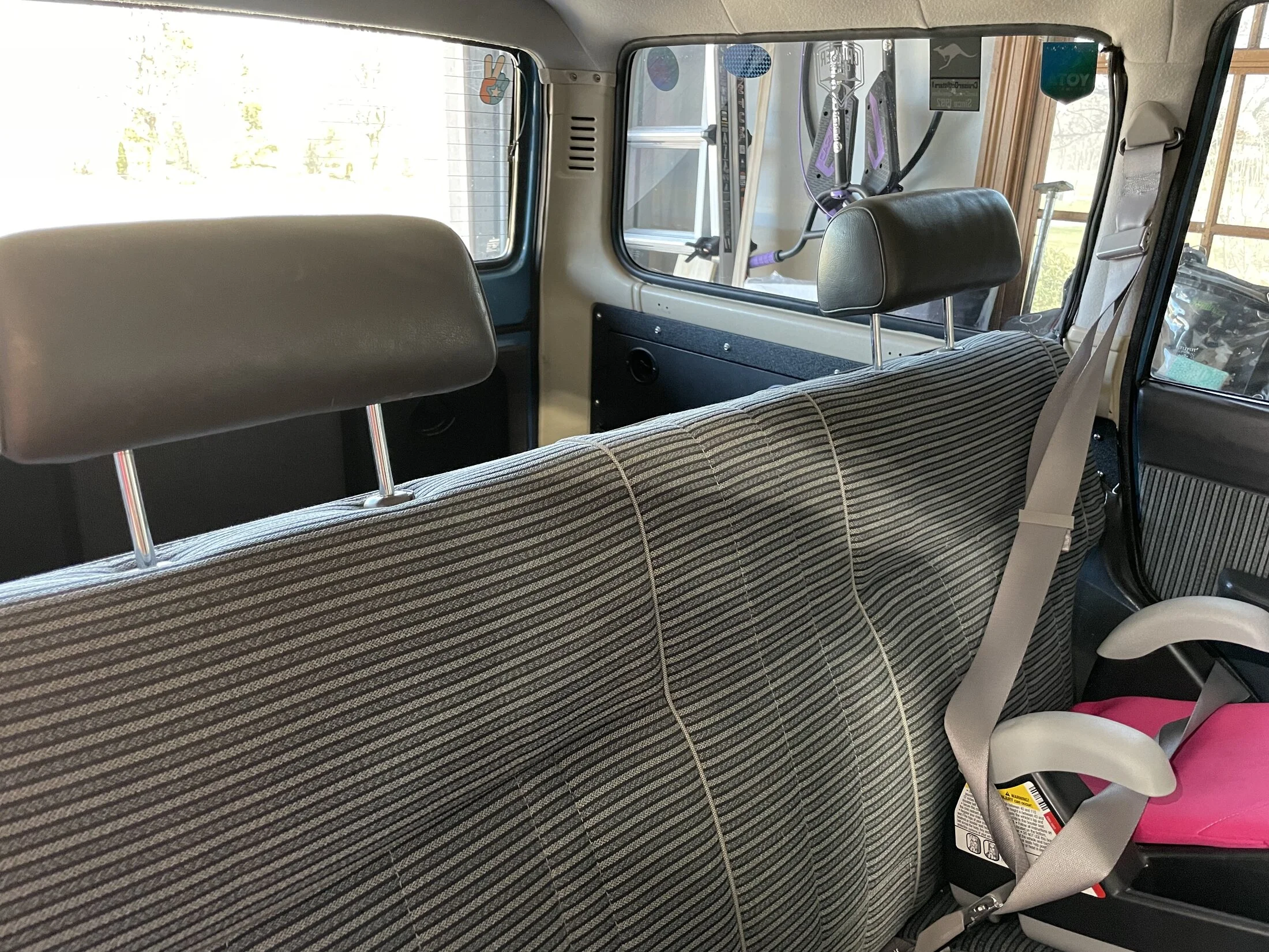

@bcolvin I have the 62 rear seat in my 60 and it's perfect for my 8 year old twins (see photo) and adds a bit of comfort for me (and my wife) on the times the kids are in the car.
Do you know if the fabric for the 60 can be used for the 62 seat in case I want to switch colors?
I believe the fabric is the same; I'm sure someone will chime in here if I'm incorrect
