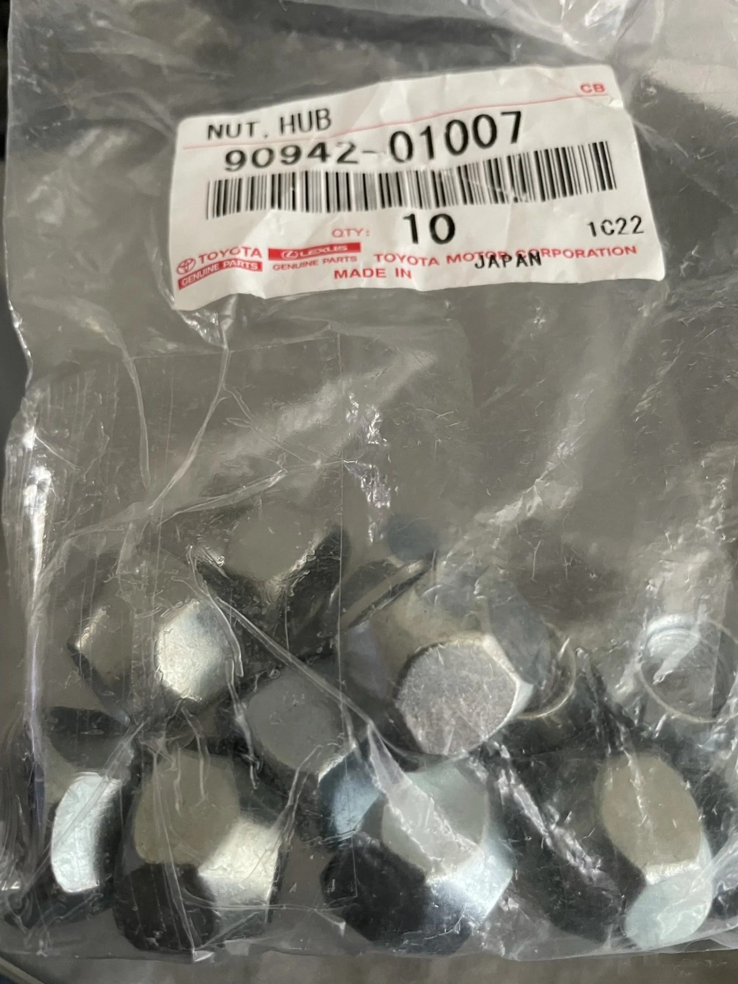

You will prolly want to replace the lug nuts with these open versions if continuing to use spacers:
Your symptoms sound a lot like loose lug nuts. Will lead to trouble if not addressed. Ask me how I know. :bang: I think its pretty common to have spacers amplify the effects of worn axle/suspension parts. If the only thing changed is the spacers, then they are the reason for your wobble. You could take them off and see if it goes away but I think you know in your heart of hearts they are the cause. I would start with simply making sure the spacers/wheels are torqued properly as mentioned. You obviously want to check your bearings etc. for being worn and replace worn parts properly/fix leaks etc.. But sounds like using spacers to solve tires rubbing on exhaust parts has you headed down a painful path. I am not sure of your specific tire rubbing issue, but seems like for what you spent on those spacers you could of had a muffler shop change the exhaust routing to stop the rub. If the wobble stops after removing the spacers, I think I would go that route and save myself the trouble. HTH.
Your symptoms sound a lot like loose lug nuts. Will lead to trouble if not addressed. I think its pretty common to have spacers amplify the effects of worn axle/suspension parts. If the only thing changed is the spacers, then they are the reason for your wobble. You could take them off and see if it goes away but I think you know in your heart of hearts they are the cause. I would start with simply making sure the spacers/wheels are torqued properly as mentioned. You obviously want to check your bearings etc. for being worn and replace worn parts properly/fix leaks etc.. But sounds like using spacers to solve tires rubbing on exhaust parts has you headed down a painful path. I am not sure of your specific tire rubbing issue, but seems like for what you spent on those spacers you could of had a muffler shop change the exhaust routing to stop the rub. If the wobble stops after removing the spacers, I think I would go that route and save myself the trouble. HTH.

Anyways, I do like the open lugs. I will start looking for those on the internet.
It could be that the old ones are too short therefore not securing the wheel properly.
Do you have a link where you purchased those that you can share?
