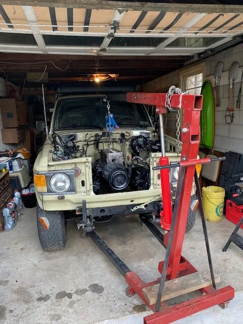

Novice FJ60 2F rebuild after the block was reconditioned. almost ready to start it... what have I forgotten?
Jan 31, 2021
12
58
Kennett Sq PA
This was a few weeks ago. As of today I have everything back in. Just got to connect the hoses and cables, add fluids and prime the oil... I think.
I adjusted the rockers/valves to spec. Shop that did the block recommended Lucas 20-50 hot rod oil for the break in.
How soon should I re-tighten the head bolts?
Just worried about the things I don't know. What steps that I might have forgotten that could result in disaster?
My level of mechanical understanding is very basic, so if you comment please bear that in mind.
Many thanks to all in advance
