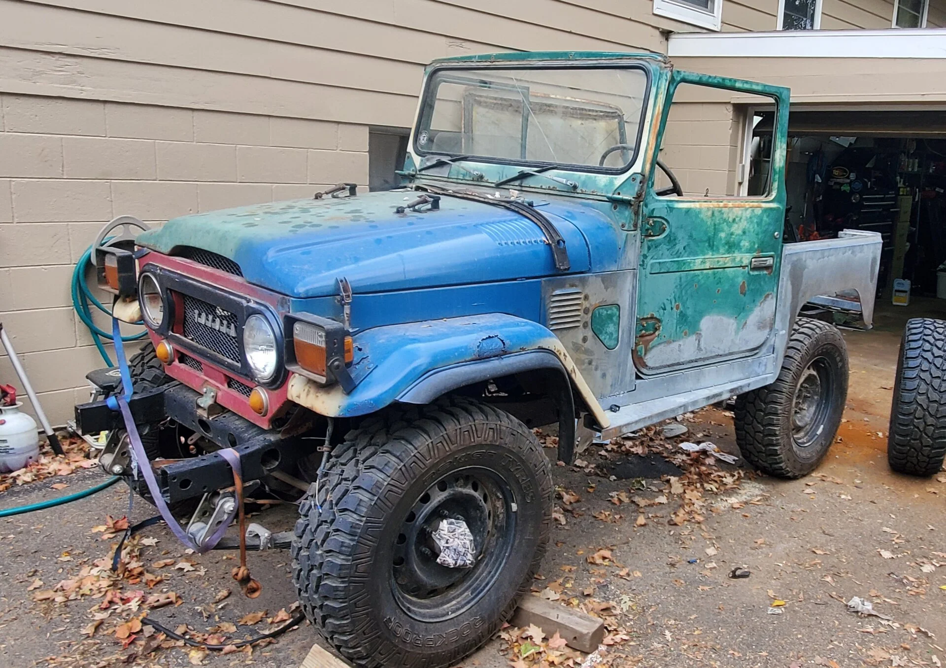

I am in the middle of my 40 build and am considering a change in direction from a more mild build on 33s and going straight to 37s. I had another build planned for big tires, but having thought about this all winter I have decided yet another rig isn't worth all of the money, hours, storage, insurance, etc. just to go up a size or two in tires and would like to just commit to one rig I will be able to enjoy more rather than have one sit most of the year.
I am sticking with my 40 as far as I have taken it, but will be making some changes to axles, drivetrain, and body to get it where I want it, which is a capable wheeler I can drive moderate distance, potentially cross country for big trips out west, and won't be afraid to wheel hard. Part of the equation will be deciding on a drivetrain setup. I want adequate gearing to run 37s (Will not be going bigger) with the 2F and hopefully not feel the need for additional gearing down the road.
That being said, what would a good rock crawling final drive ratio be for running 37s and the ‘ol 2F?

As you can see, I would be struggling on long highway drives with an H42 and 4.88s. Going to the H55 will make a big improvement, even with the 10% reduction of the split case gears eats into that extra gear. However, with 4:10s the H42, BB and 4:1 split case gears option gives a wide range of gear options and good highway speeds, all while sticking with stock 4.10 gears. The 10% underdrive in high range would be about the equivalent of running 4.56s in high range with 4.10s, which would probably be livable on the street with 37s.
I currently have an FJ60 H42 with extension and split case. Having this option now means I can finish out my build using this combo and later add an H55 and 4:1 split case gears and not have to mess with anything. The black box, as cool as it is, is an expensive option and don't think I could make it fit with the H55 without moving the rear axle back quite a bit more than I already have. I could also find a short shaft H42 and potentially fit a black box and go the 4.10 diff gear route.
I am leaning towards the H55 and 4:1 split case option. I would have a 94:1 final drive ratio, good highway speed, and don't need to worry about an oil cooling setup on a black box for highway driving. The question though, will this be low enough or will I feel the need for a doubler when I get into progressively more technical trails down the road? The H42 short shaft, Black box, and 4:1 split case gears option is a close second, if deeper gearing is worth it.

PFA, on 285/70r17s and FJ60 2" lift springs at the moment.
