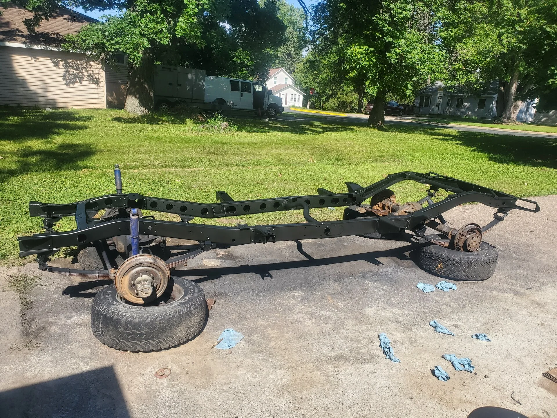

You guys got me thinking last night. I have a 79 frame that I stretched to 116" for the 45 build using sections from a bent frame. This frame was in better shape than the one I used in the current 40 build. I also have 3 hard tops and extra tub topper rails. While I may have the bud built quarters welded to the B pillers, I am now tempted to shorten up the stretched frame to something close to an FJ43, stretch the body, and cobble together a stretched hard top. Driveline length won't be an issue then, and I will make use of the better frame. May even be able to sleep in it, something that would be nice for big trips.
