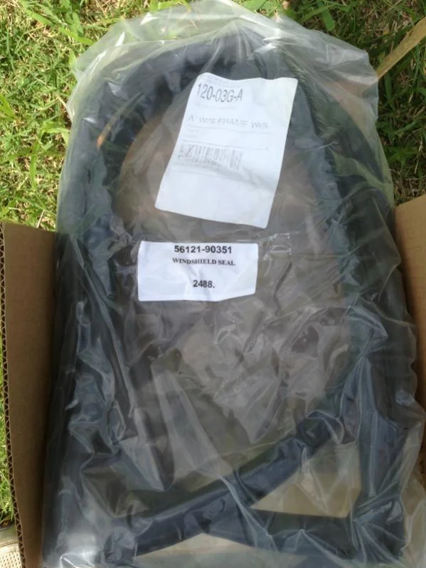

the w/s and chrome trim are specific to each other. non chrome w/s can not be used with the chrome trim. the w/s is coming out of that particular rig and going back with a non chrome weatherstrip, so that exact one will be available. ;)
you may want to hold onto the non chrome w/s because weren't you looking at having to pull w/s for body work, then reinstall, then pull later? use the non chrome for that, then put the chrome setup in when finally done. less chance of messing up the chrome trim, which is rather fragile.
Awesome. You have a buyer.

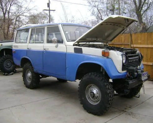

when i post up the updates on the 42 build you can see the results
screw it, here are a couple pics
the tape over the decal will be gone.

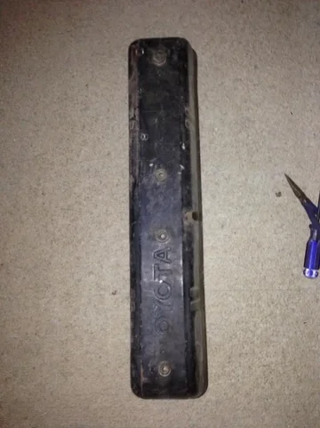

Two question.
This valve cover was said to be from the original F, but I do not recall "Toyota" on mine. It is steel, so a little confused.
If from F, blast and coat this one?
Find aluminum 2F and do similar, since they're reported to be more confirming, less likely to leak?
stay original, you can't be straying and still original.
blast and paint.
i don't remember seeing TOYOTA on any of mine but then i wasn't paying that much attention.
