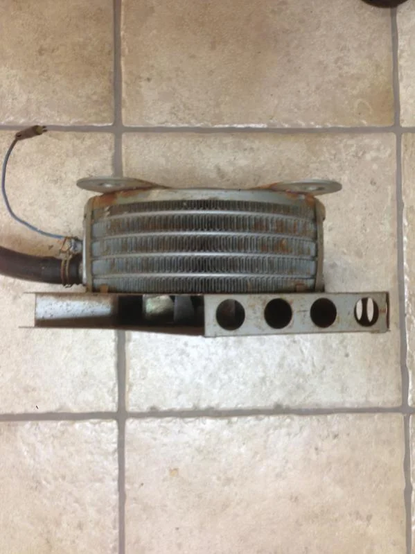

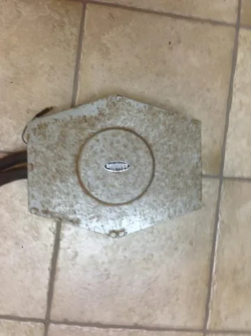

He offered advice/input on the balance of parts I've consternated over (air cleaner:heater), being to gather all like finishes and wait until all feasible are off, he inspect for needed attention, then take to a local shop he suggested and have him blast and two part epoxy in a 202-ish color/sheen.
Only item he expressed any reservation above was the valve cover, since we're not pulling here, but says this guy could code to a high temp PC for whomever else may be doing and it'd be close enough for anything not trailered from show to show.
