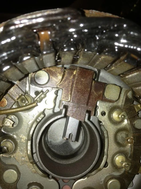

Another eBay fail.

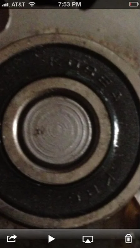

My small project of stripping the seller described "freshly rebuilt" alternator discovered that it's not rebuilt, only painted.
Brush holder is cracked.
Didn't know that NipponDenso sourced bearings from Korea
And I can't get the rotor freed from frame for love nor money.
Now a potential dumb question.
Is the offset of the pulley behind the nut to balance?
Brushes do extend 7mm, so they may be new, but the holder is going to need to be replaced.
All this because I didn't like the "Reman" sticker on the one I had. Maybe I should've hit up Metric for a new sticker instead of going to this trouble, but going to be rebuilding this one....unless someone here is a psychologist and can help me with this sickness....
