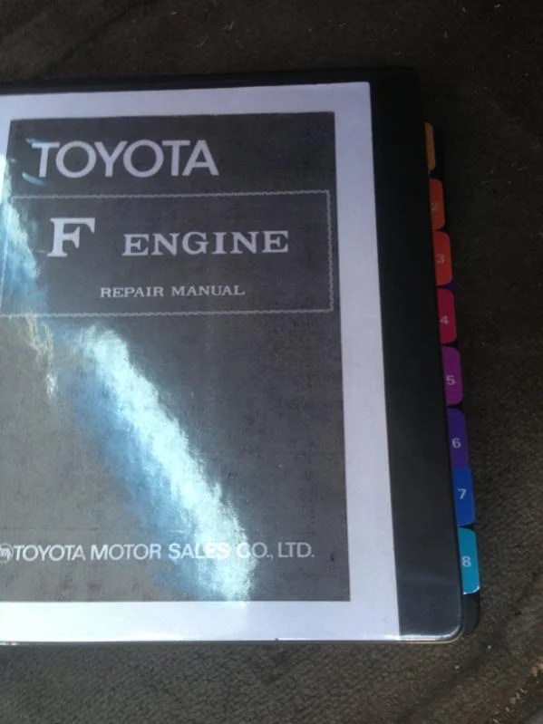

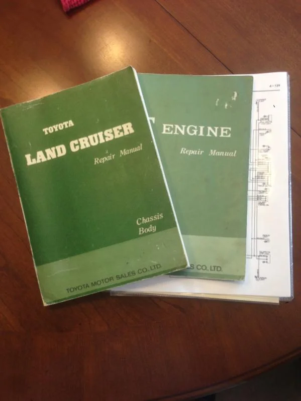

Have the original bound for both the F and Chassis/Body,

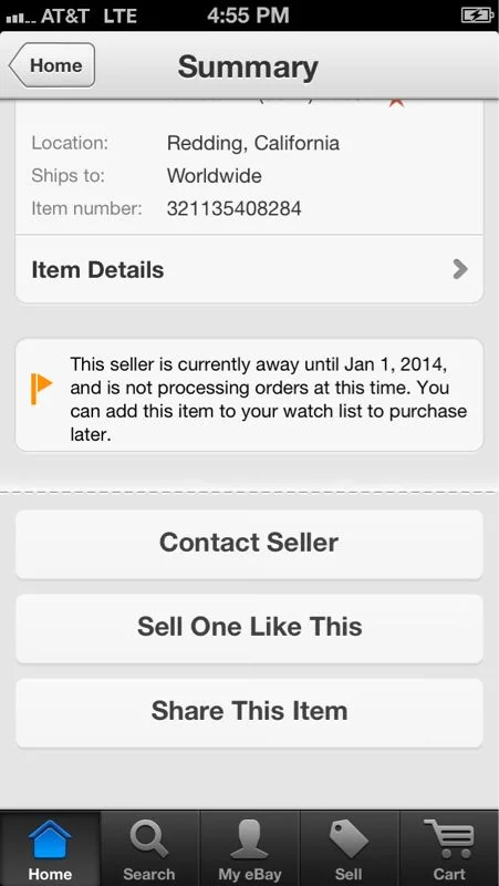

Then I have a pre-copied and three ring bound F manual (even came pre-tabbed) that I purchased on eBay, along with the same formatted Chassis/Body manual....but have never received and eBay states "Seller is away".
Regardless, the plan is to scan both of the three ring bound copies (so I don't have to spend 5 hours at the scanner, flipping pages) the host a PDF download, so anyone can have it on file or print it.
Going to check into the status of order right now, but if its delayed and you need, I'd more than happily send the original if you'll return.
Will post outcome of eBay query shortly.
Edited:
Downloading one now.

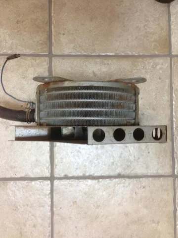

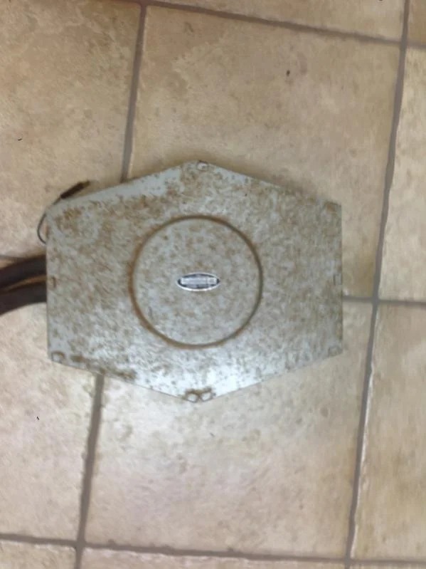

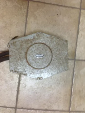

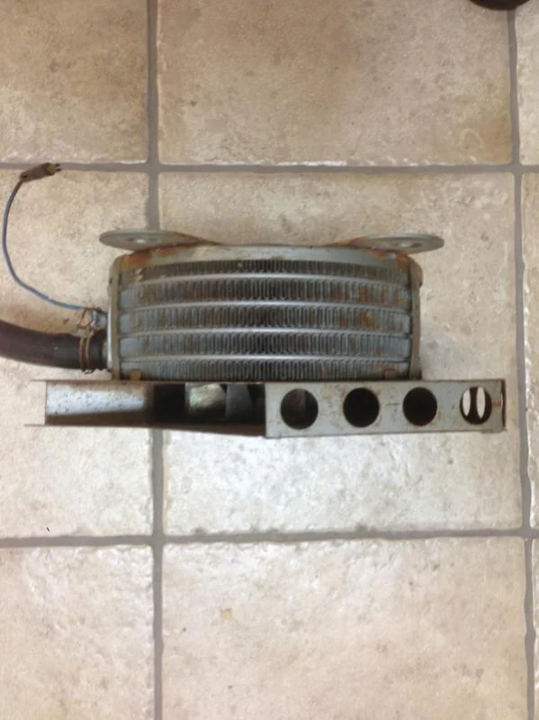

3. Strip and finish rear heater with?
Going to set minor goals to complete things that aren't critical, so that they'll be ready when they become.
What's the best method to strip and is there any coating (clear powder, maybe?) that y'all would suggest for the rear heater?
4. Same for alternator. It appears OE and is tagged correct, but had been painted and I'd like to remove.
Best means to strip? (Mineral spirits did ok, but soda sounds like a winner since it'd cost $9-10)
Coat with?

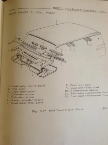

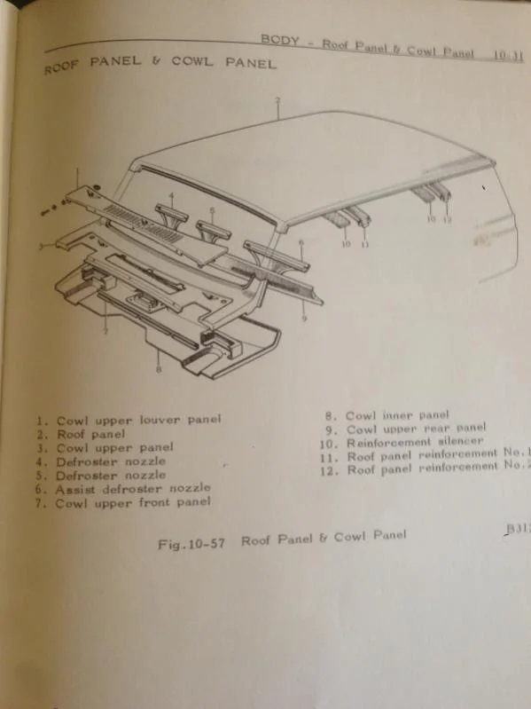

Glass & Headliner
The two are very much inter-related on the Pig...
At least the windshield and rear quarter glass (or cargo area glass) are closely tied to the headliner.
You have to remove those 3 pieces of glass to remove and replace the headliner.
I'm not sure after reading your plan if the Pig will be indoors during this tear-down process? If yes, yank the glass now. If no, leave the glass in until right before the strip/dip or blast.
As for the headliner, I am kind of surprised that you are even questioning it, given your deadicated approach. The headliner is one of the few things we can buy new for our Pigs (SOR/Cruiser Corps/other) for not a whole lot of $ (all relative). As are winshield gaskets and cargo glass rubber (these are $$$, but not more than the fixed rubber glass).
I would pull the glass as soon as you want to pull the headliner and yes, I would put in a new headliner. Adds a nice touch...
